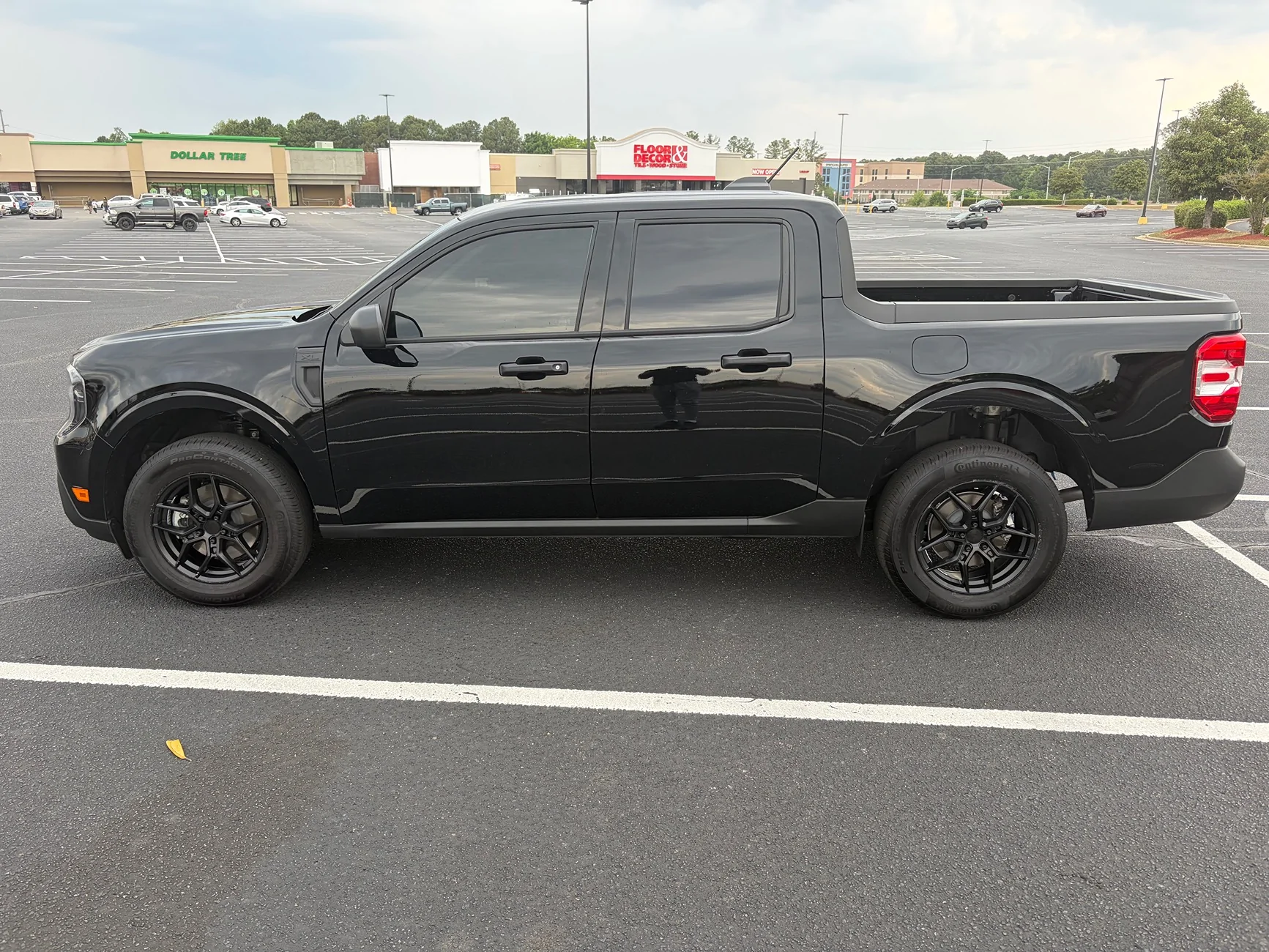

I’m leaning towards a 2 Inch Lift Kit, just wanna ask if yaw think it’s worth it or just leave it stock?

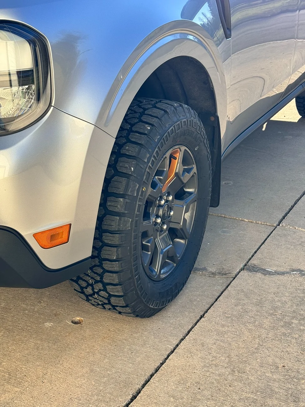

I would leave it stock and go with a 245/65R17 tire. It will fit and look great on your stock Mav with no lift at all. There are too many issues with the CV axles with a 2" lift or level unless you upgrade to Tremor axles etc. You could just level out the front 1" to match the rear. Here is a pic of my Tremor with 245/65R17 Kenda Klever AT/2's with the stock Tremor lift. Good luck with your build and post pics!

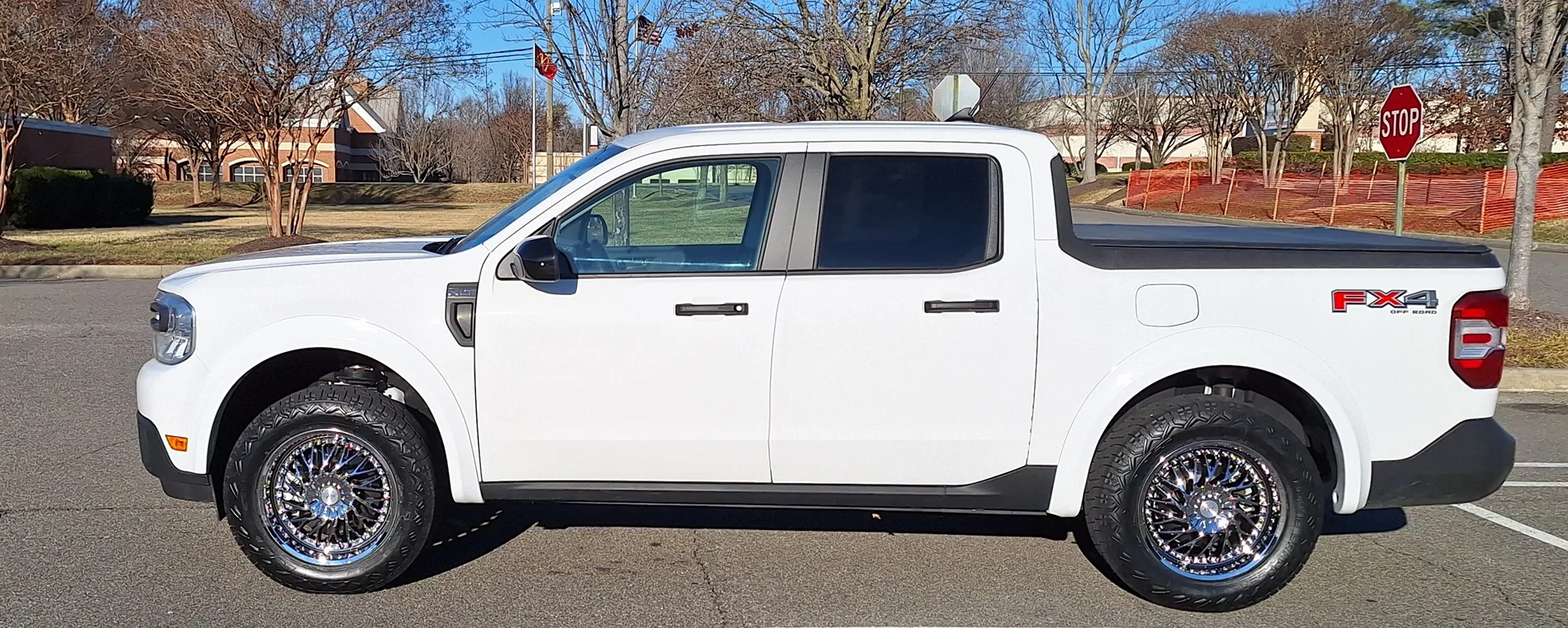

I'm aware of the cv issues, but I really wanted those 30" tires. I also left the 1" rear lift out. I liked this posture
