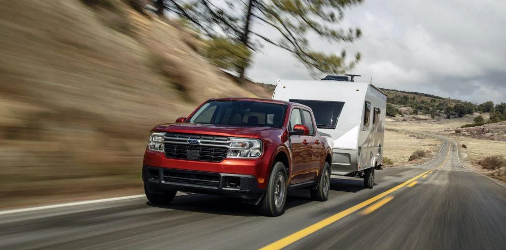

that doesn't make sense here. Look at the Ford promo picture of Red Maverick with a bumper pull smallish travel trailer behind it. Most travel trailers have been built 8' wide until recently some 7' have popped up for better vision. Majority of travel trailers (excluding tear drops, little guy, etc here) are at least 6' tall inside to stand up in comfortably and that 1 in the promo picture roughly fits these dimensions. So assuming 8'w X 6'h you would get 48' of frontal area and exceeding the max 40 sq ft? Would Ford deliberately violate a max limit in their literature, or is something off in the calculations somewhere?
The way I understand it (and someone correct me if I'm wrong), frontal area is typically different than front surface area. It takes into account the angles at which that surface area interacts with air that is parallel to the ground plane.
For example, if you take a 4x8 sheet of plywood and position it so it's 4 feet high, 8 feet wide, and 90 degrees to the ground, you have 32 square feet of frontal area.
Tilt that plywood at a 45-degree angle to the ground and you now have 22.6 square feet of frontal area.
I say "typically different" because some trailers are perfect cubes, or close enough that their practical frontal area is equal to their front surface area. The Carson Racer series is one.
Ford Maverick 2.0l Capable RV Campers carson-racer
The RV that the red Maverick is towing has a curve that decreases in radius closer to the ground, which will require more than basic geometry to calculate frontal area.
It’s still widthxheight. A 4x8 sheet of plywood at a 45 degree angle is not as tall as it is if it was upright.

Notfast your thinking is my thinking. Its is the same concept as static weight and dynamic weight with a rooftop tent. If all 40sq ft are at a 90 degree angle it would not be a good experience with The maverick.
If part of the surface is at an angle the drag factor is less
Correct. That's why in my example, the tilted plywood has reduced its frontal area by 9.4 square feet.
