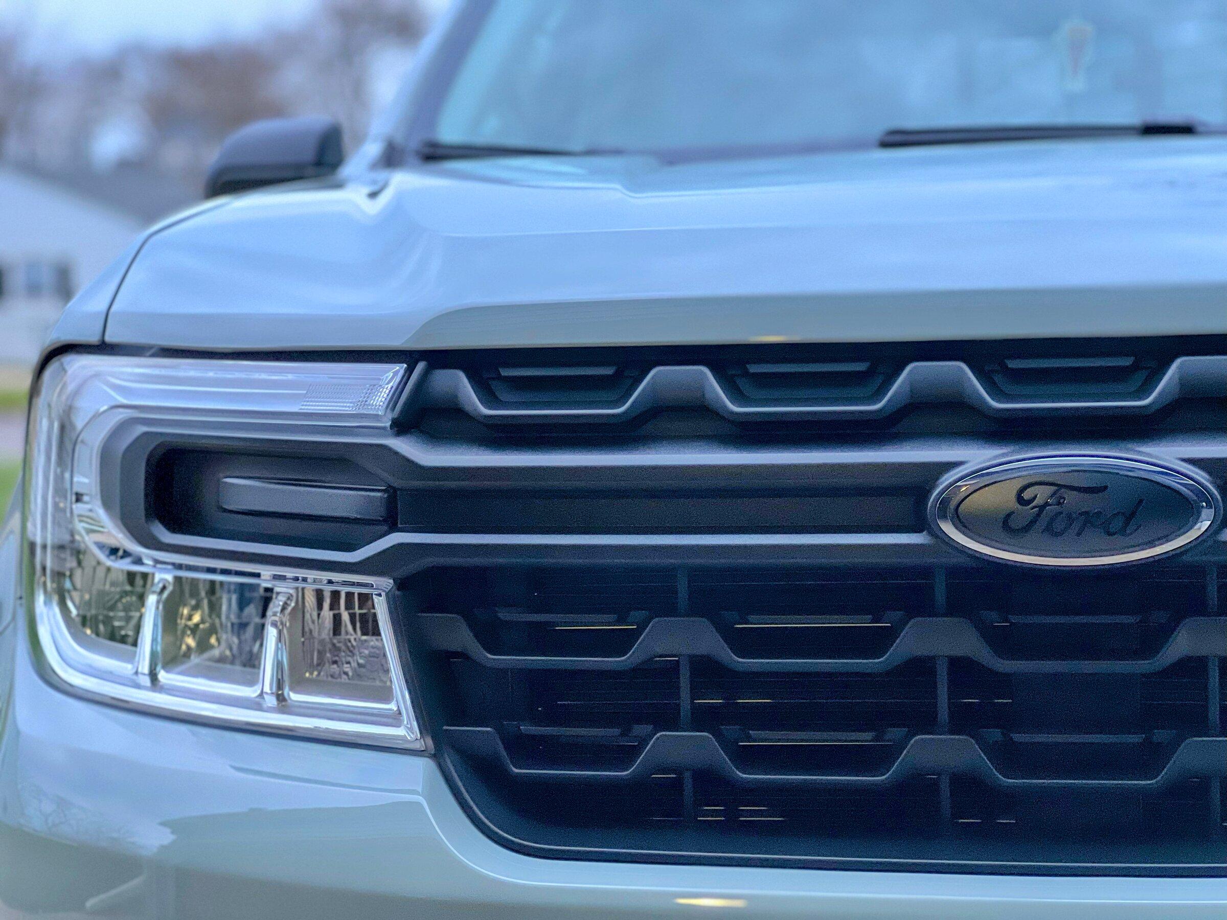

All the grills are 2 piece on the Mav, they are just bolted to the grill so you either have to take the bumper off or pry the top part of the grill off to reach the bolts to detach the center bar.
Source: I have an XL and have pulled my center piece off to wrap my DRL
