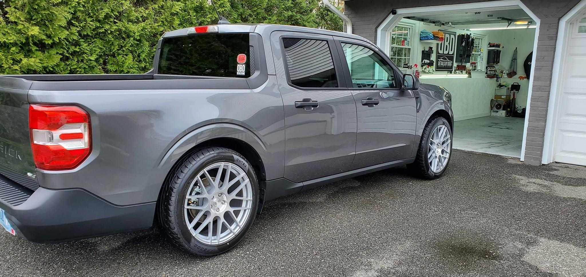

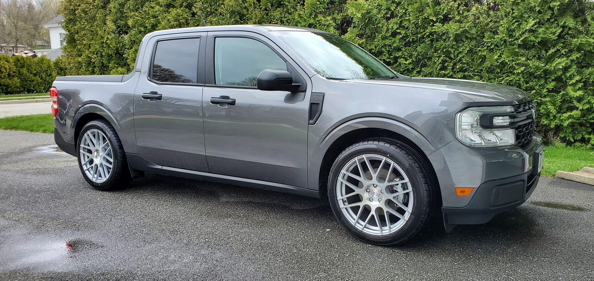

Maverick belongs to Doug H.
20" wheels (20x9 +38 offset) with 255/45 tires lowered 2"+ (H&R Springs for 2020 AWD Ford Escape Part #28633-1)
No trimming, no rubbing, and no problems according to the owner.
Ford Maverick Maverick XL on 20" Wheels and Lowered on 2"+ H&R Lowering Springs Maverick XL on 20%22 Wheels and Dropped on 2%22+ Lowering Springs 2
Ford Maverick Maverick XL on 20" Wheels and Lowered on 2"+ H&R Lowering Springs Maverick XL on 20%22 Wheels and Dropped on 2%22+ Lowering Springs 1

Nice!

Looks really nice!

Looks very good, sporty and clean. I really like it (y)

i need the ground clearance for when i go hunting or camping otherwise a drop kit would be already installed on mine. Look really good

Now that looks really good!

Not what I would do, but looks great! Glad we have aesthetic options!

Looks great!
I feel like I may need to end up with air lol. I'll give coilovers or springs a shot first.

:love:The wheels.... Reminds me of my Limited that I sold when I ordered my Mav. I just might have to look in to those. :cool:
