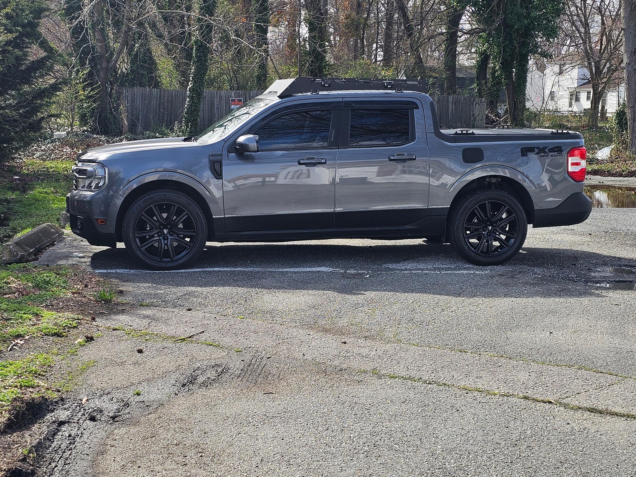

20inch edge rims. Tires are 245/50/20s i think. No rubbing but close to shock. Plan on lifting it.

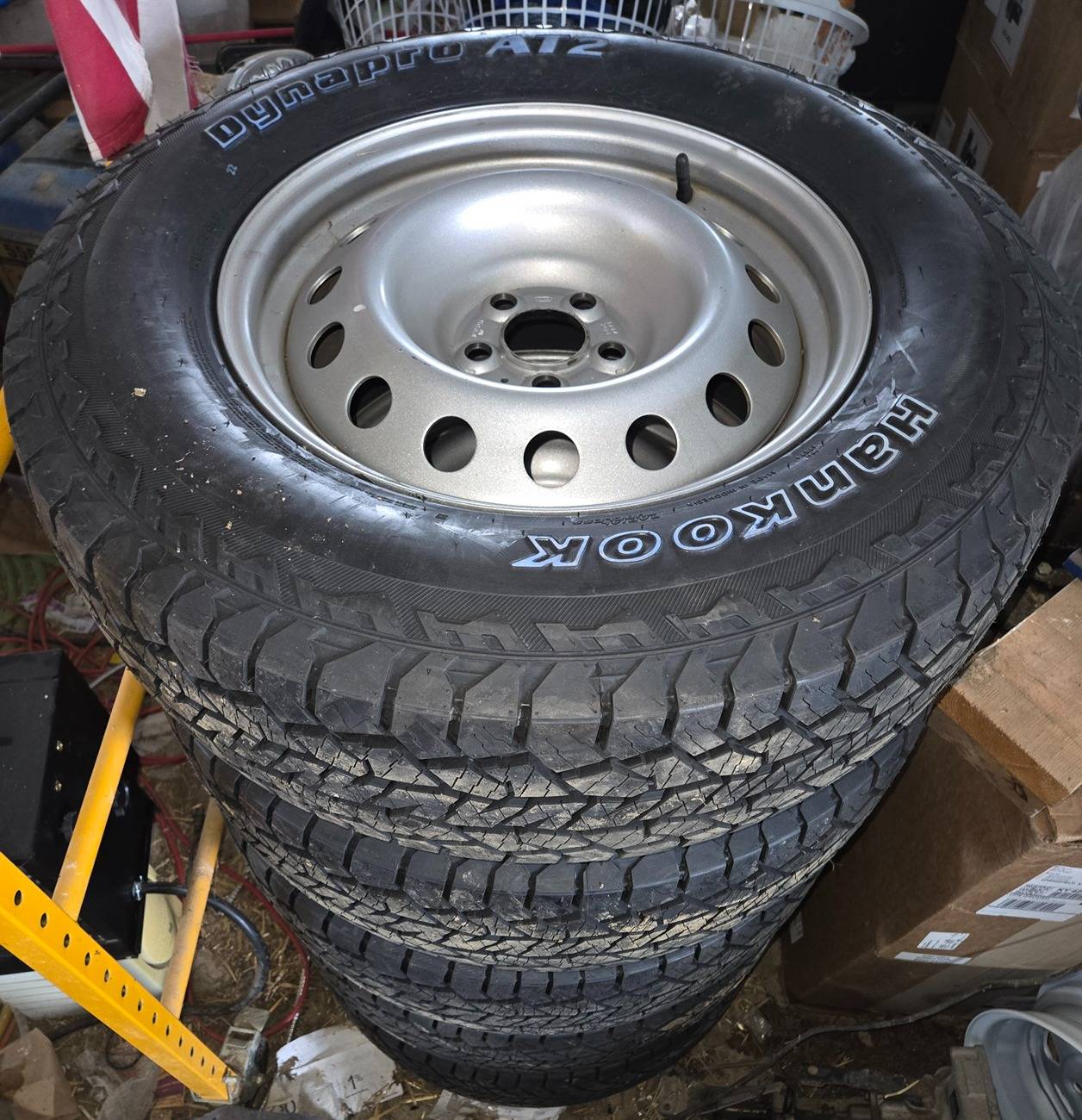

Damn, I feel like I'm the only one perfectly satisfied with the stock steelies 🤣
My winter tires are on steelies and are going on Monday for an expected 3"-5" snow storm. I'm debating selling my Lariat OEM 19" and replacing with Mach-E GT 20" for my summer tires. My land is so rough, wet and muddy that I'm installing a 2.5" lift from Rough Country as well. By winter 2026 I'll have my home built with a climate-controlled garage and concrete driveway. The 20" wheels will be right at home then. OK, I guess I'll hit Buy it Now and make it happen. Done.

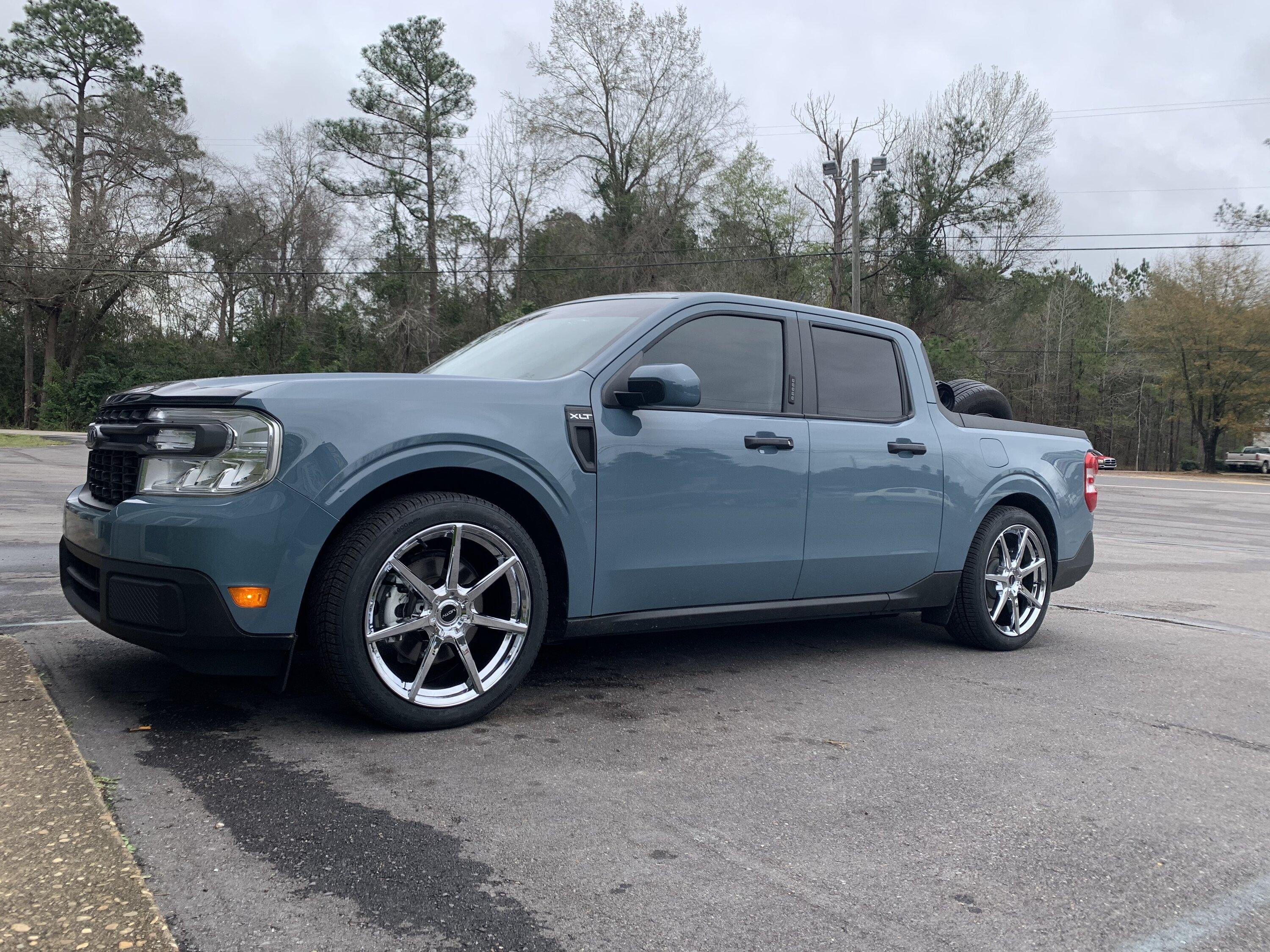

I'd like to see and hear about your Mavericks on 20s. What tire size and what if any speedometer accuracy issues.
Lowered or not, I would actually like to see some without lowering as I want to lower mine but I need to find a shop I can trust to do it before jumping for Eibach springs and I am also still unclear IF the springs and an alignment are all I will need to lower my Maverick.
I currently have a set of 20s from TSW that were on my Edge (yes they are 5x108) and I desperately want to put them on my Maverick however I have 255/45ZR/20 tires on the wheels currently and I am not sure if those will be ok for not rubbing and also not throwing off the speedometer too much.

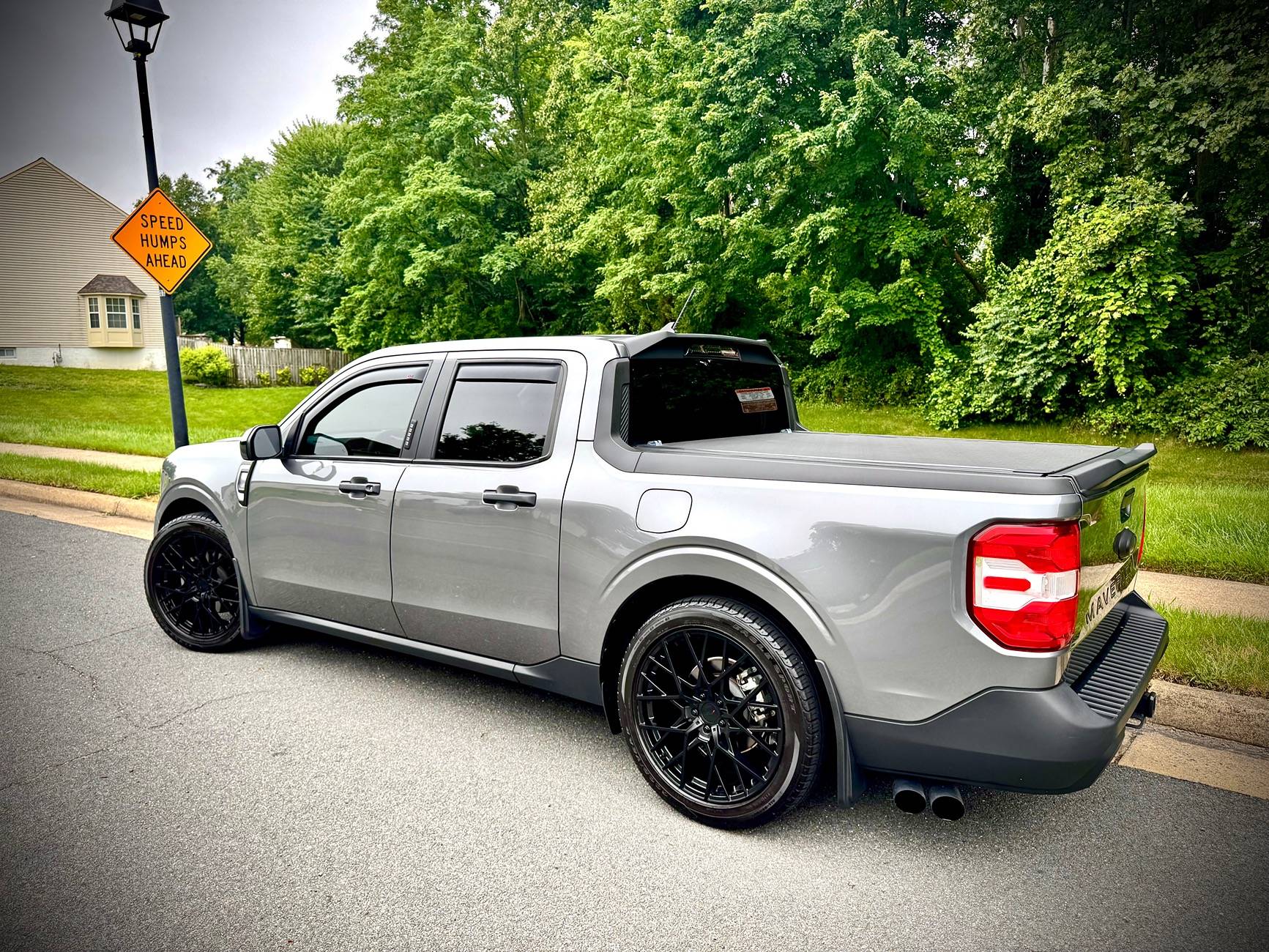

I have that exact wheel with those tires and HR Springs. No rubbing at all. I want a lower wall so I am changing them to 245/40/20. I ‘m also going with Silvers neo Max coilovers. Heres a pic how It currently sits.

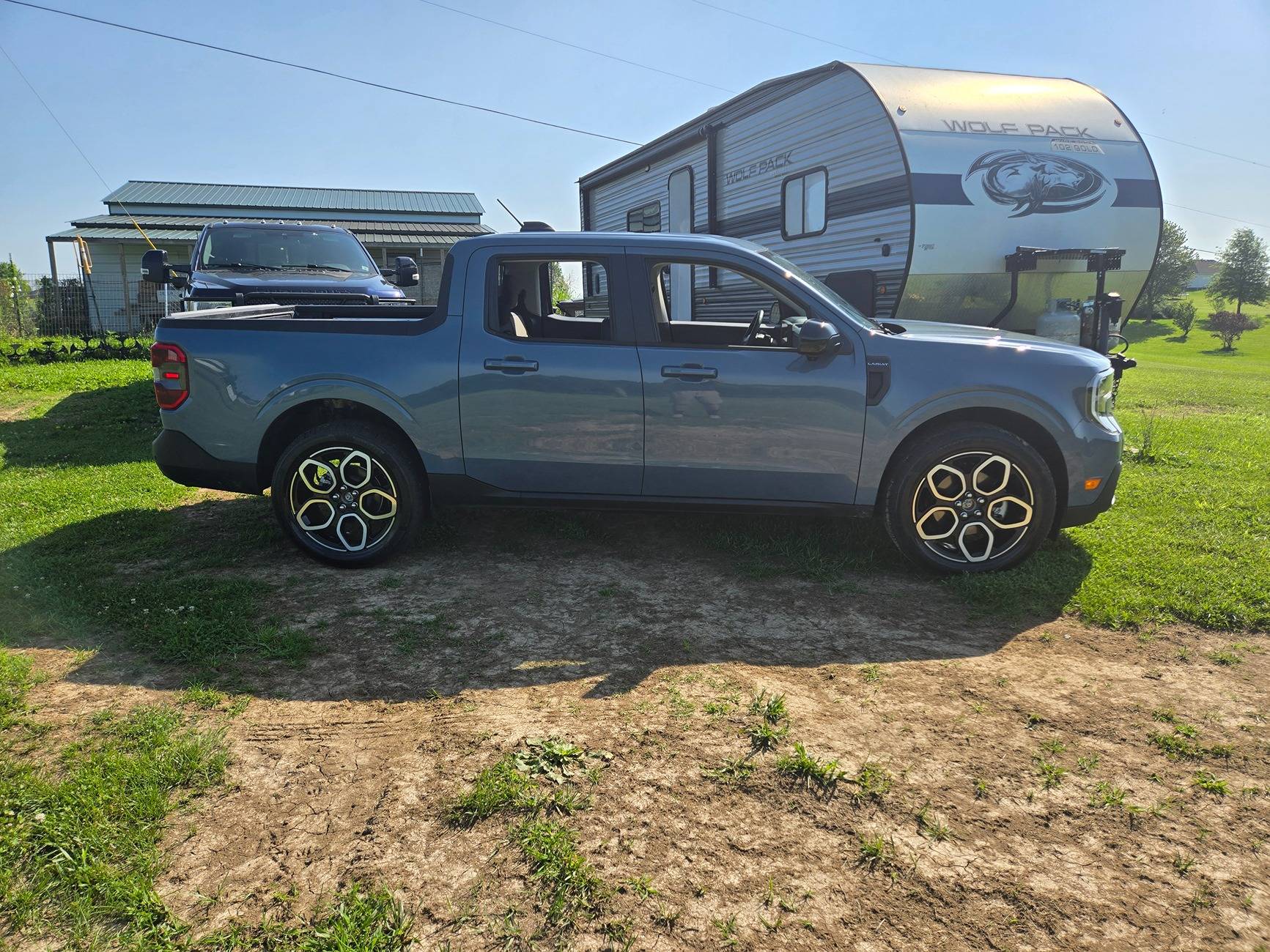

Ford Mach-E GT wheels with Summit Trail Climber SUV2 255/50R20. I deleted the wheel covers and added 65mm center caps with two pea sized dabs of RTV sealant at 180° from each other. Let me know if you need a photo of the center cap.
