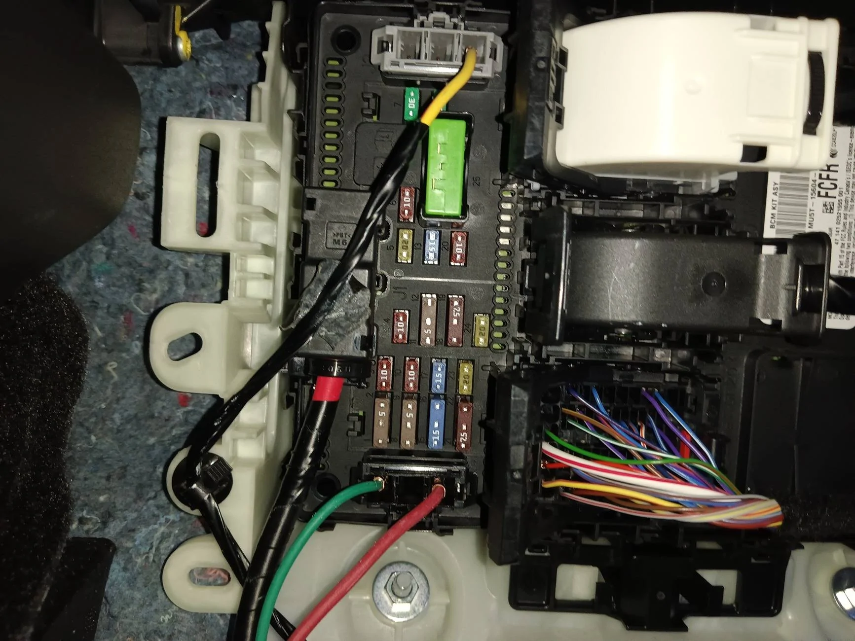

Check out the fuze panel behind the passenger foot well plastic panel. There are circuits which are on/off with key or the delay off. There might even be open fuze positions, I don't remember how people were adding things there on the 2022's.
Ford Maverick 12v port wires under HVAC control. Adding ambient Lighting. IMG_20230724_203520

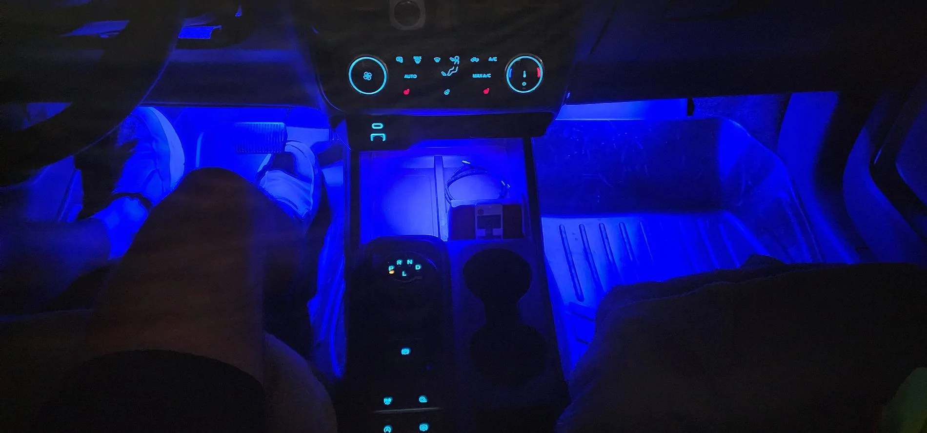

I still plan on adding another LED in the front cup holders between the two and one more on the rear of the console to add lighting for the rear footwells. Just didn't feel like unbolting the console after working all week 7 days.

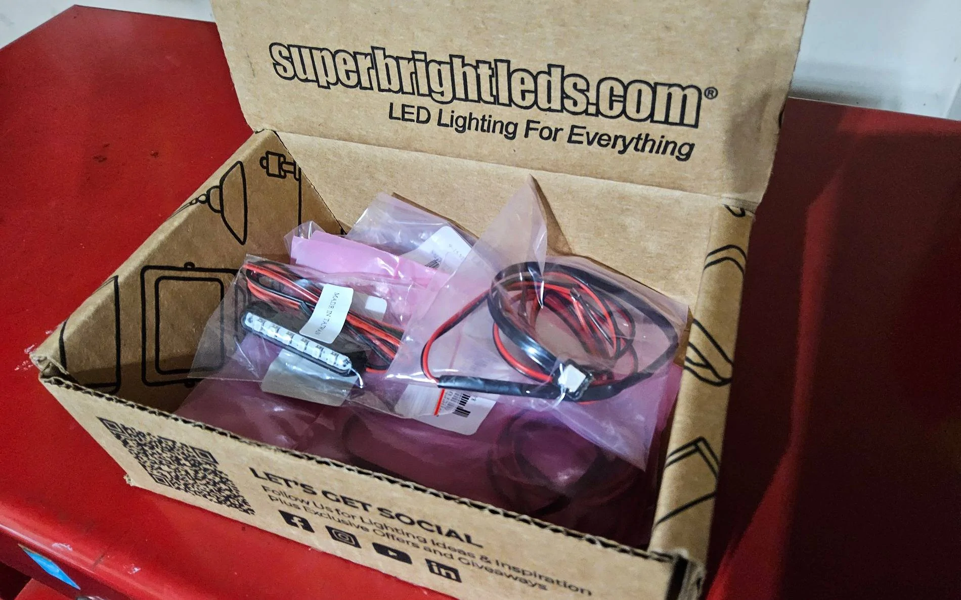

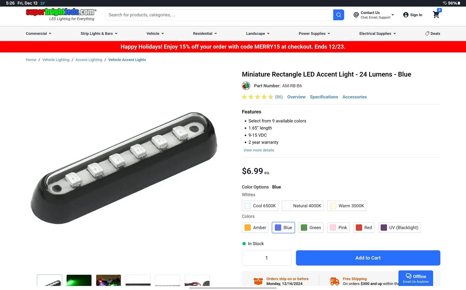

These are the leds I used for my ambient lighting, the multi-led module for the footwells & the single chip smd led for the front tray below the USB ports, as well as between the cupholders & rear of the console. For a switch I used this inline controller with a rf remote control, works perfectly for on/off and adjusting the brightness level. Remote uses a 2025 key fob style battery, purchased a 2 pack and threw em in my console so I have em in case needed.
I purchased everything locally from SuperBrightLeds.com here in Earth City MO. Total cost was 52.00 shipped, and I purchased extra LEDs for spares.
I also plan to add another smd led to the cupholder area between the two spaces, and another on the rear of the console below the add on point to light up the rear footwells.

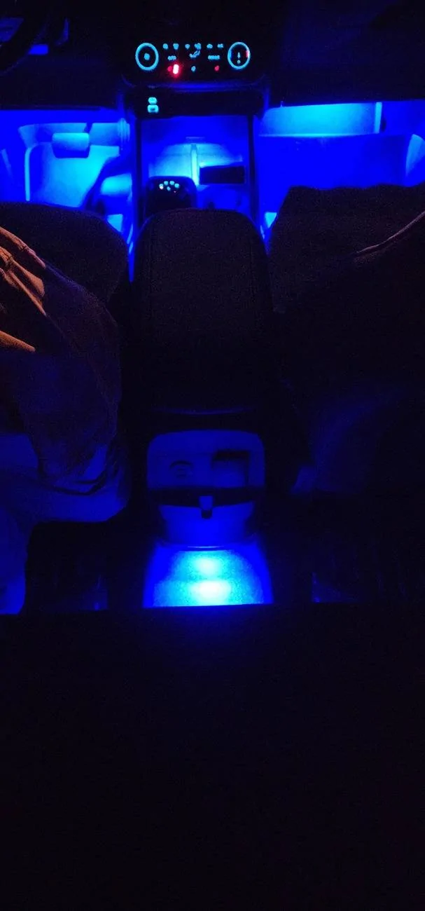

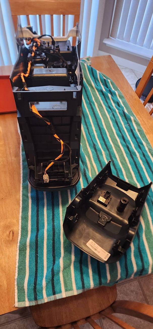

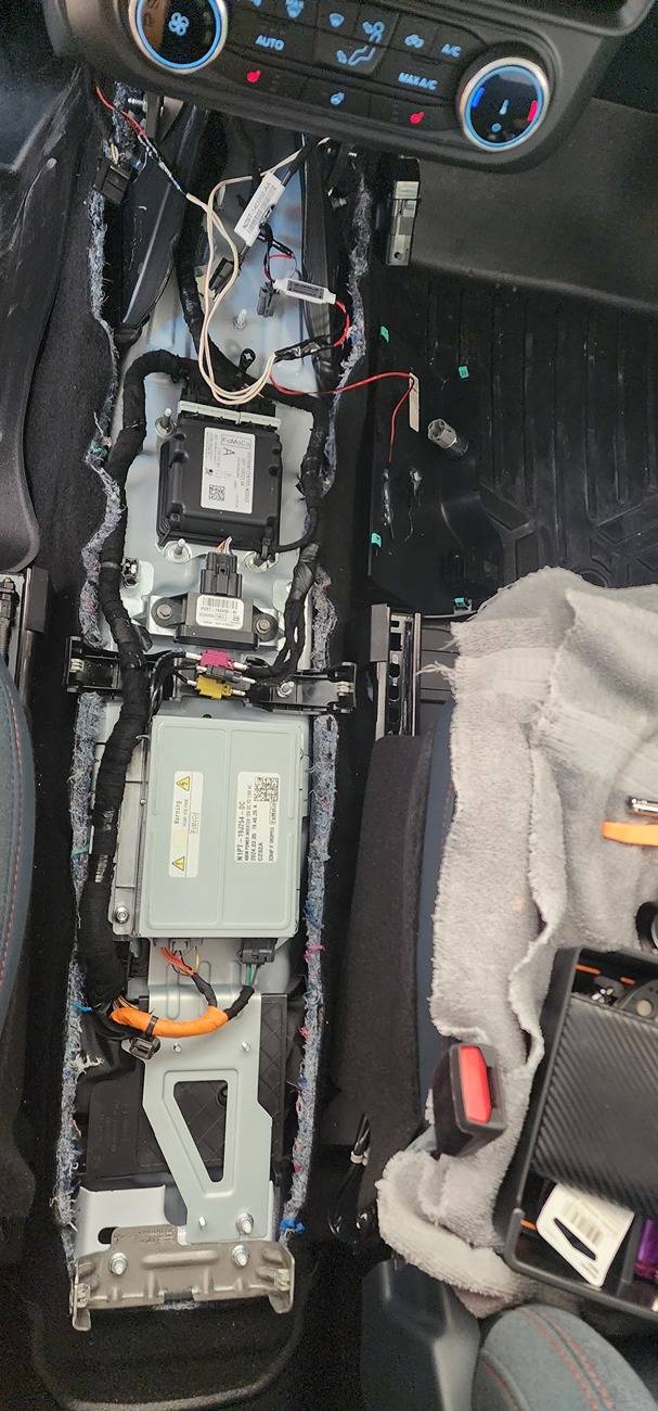

All right got it all done had time tonight weather was nice I took the console out of the Maverick and added the last two ambient lights I wanted one for the cup holder area and one on the rear of the console for the back foot wells.
The console was pretty easy to remove it has three bolts on the driver side and two on the passenger side, then there's two at the top front near the storage tray below the USB ports. After that you disconnect the wiring harness going to the dial shifter the driving mode's and the rear inverter and USB ports.
Somewhere down the road I also plan to add a OEM style light to the inside of the console as well as it's much needed at night.
I'm really happy with the results and it wasn't that bad to complete took me about an hour. I don't believe the lariats have ambient lighting in the rear do they?
