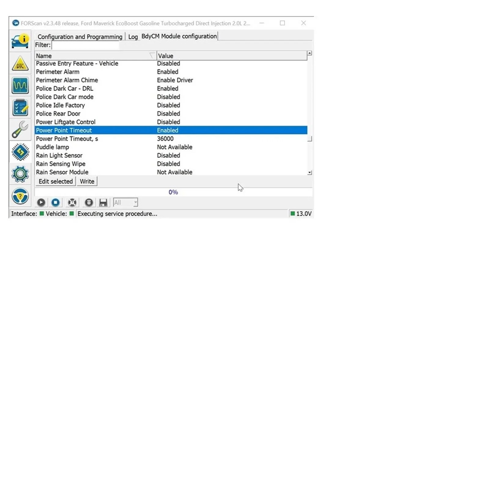

My XL hybrid has a setting in forscan. The default is 4500 seconds.
Interesting! Do you recall where this setting is located? I'm thinking of tweaking it to remain on for a solid two hours instead of the default 75 minutes.

dldjtad
Dec 17, 2023
169
120
Bartow, FL
2023 Ford Maverick
We have a powered cooler that will shut itself down if it senses a voltage drop while plugged in, and the plan is to plug it into the 400w plug in the bed while in transit to the campsite. Once there it would powered from the site's electrical post (we're almost-glamping campers: modern campsites only).
Take a look under the blue line in the picture:
