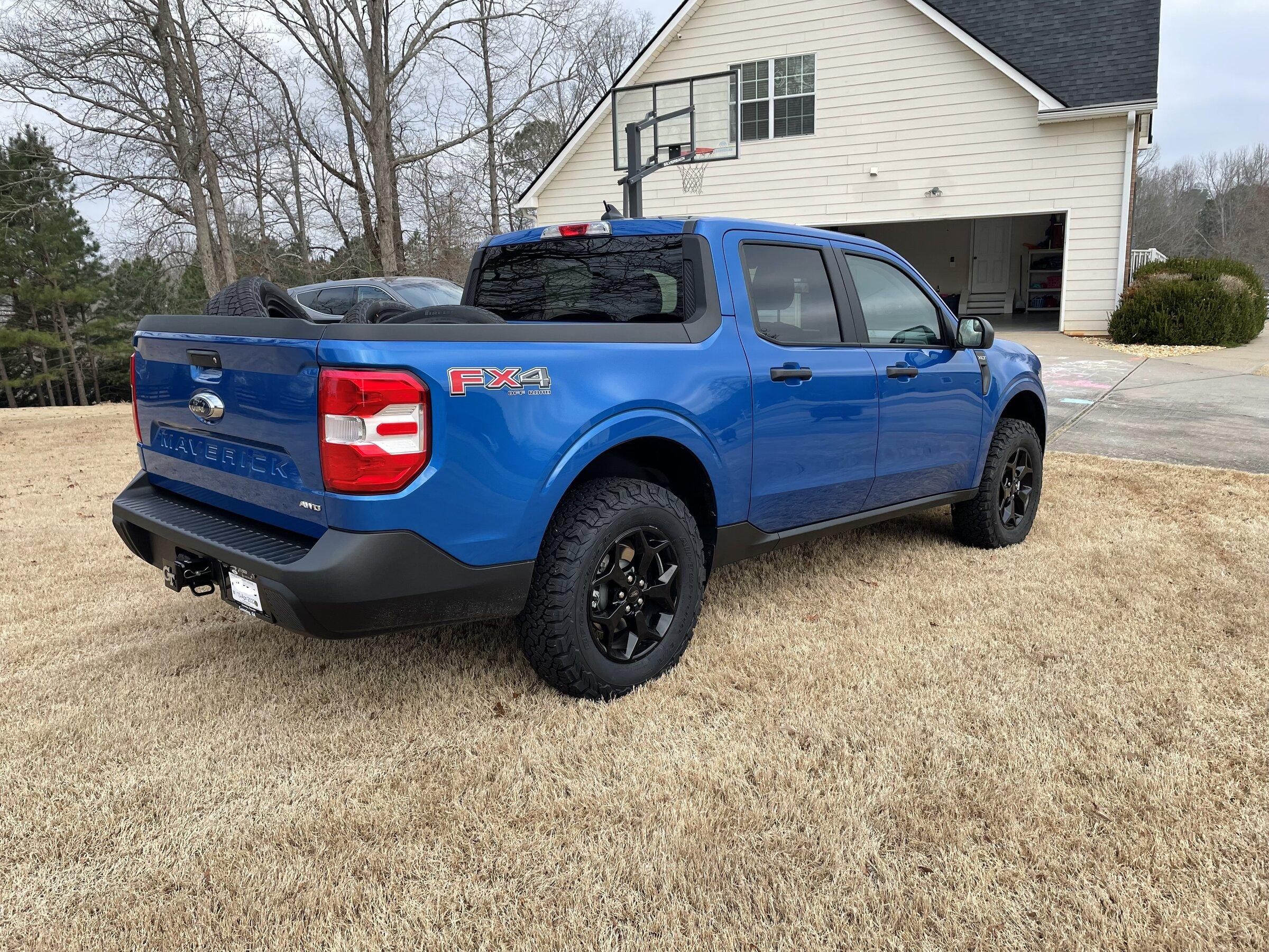

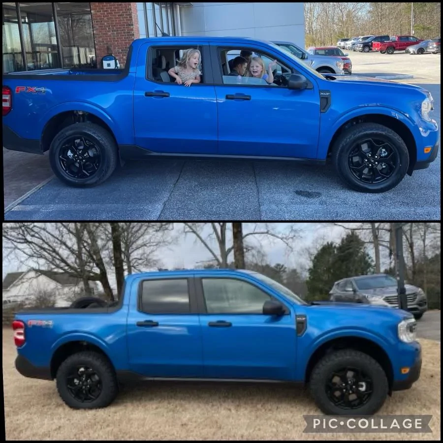

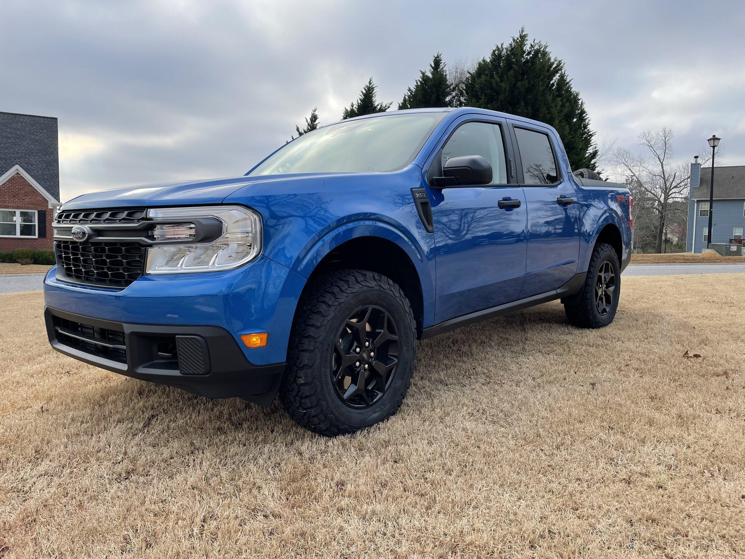

Gotta say everybody, the stance of this lift/tire combo just works. Drives awesome and feels a bit more "truck" IMO.
Details:
-Rough Country 2in lift kit
-245/70/R17 KO2s
-FX4
-4K

After about a week of semi-regular driving, the on board MPG tracker is showing just over 22 MPG. This is with a little less highway than normal for me, so hopefully it will get better. I also just enabled eco mode (using forscan) and am intending to adjust the speed calibration (to account for the larger radius tires). All of this should theoretically help the MPG in the future. Fingers crossed.

How is the clearance with the bigger tires? Any rubbing in the wheel wells when turning? Did you have to cut or grind anything? Also is your warranty still good with the lift kit? I think it looks awesome and I want to lift mine when it comes in.

Clearance is good. no rubbing, no cutting or grinding. From other reading I did, this is pretty much the largest you can go without grinding a re-welding some pinch welds.
I asked the dealer about the warranty and they said any lift less that 6in will not void the warranty.
