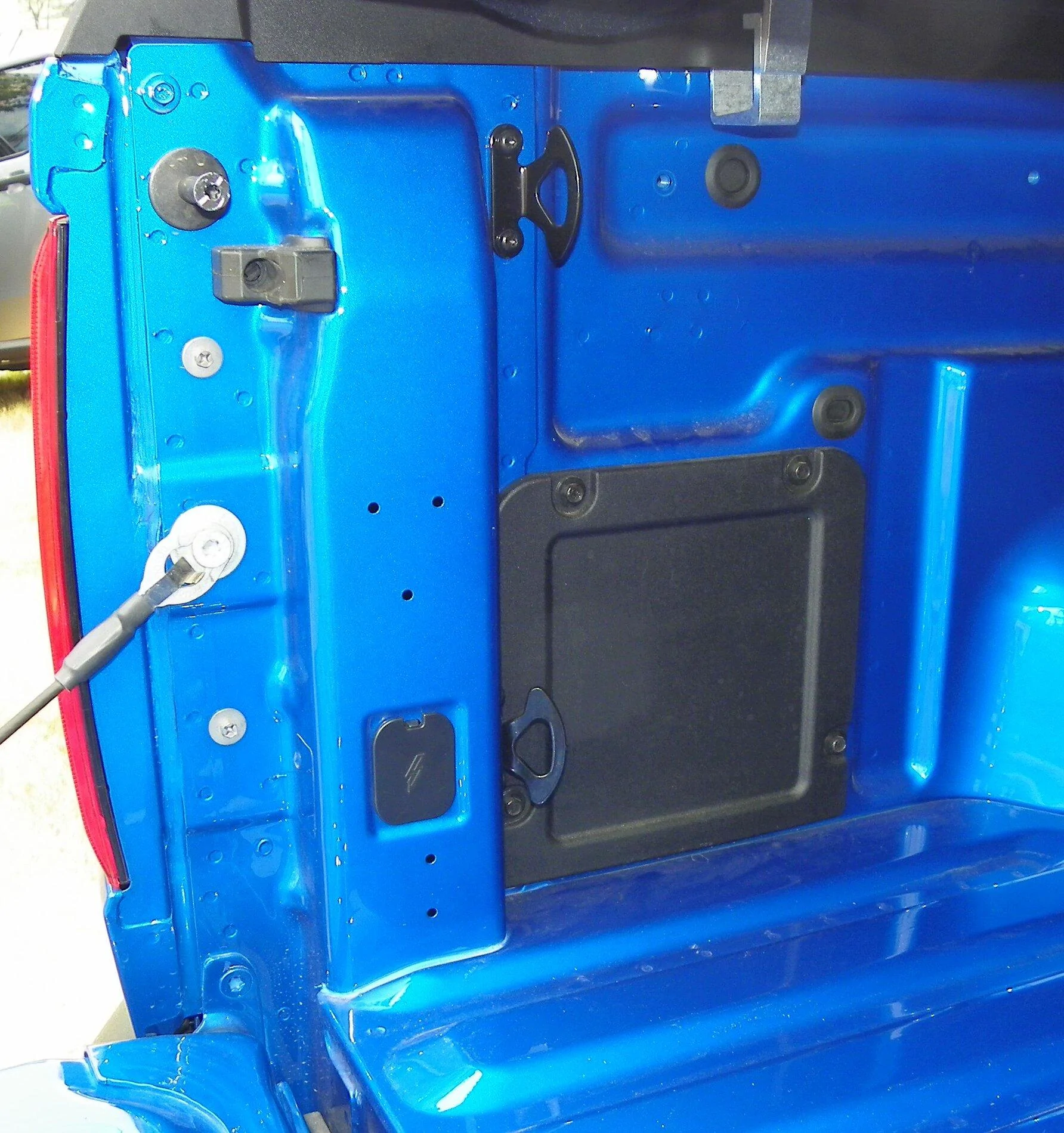

What's in that spot in the bed if there is no outlet? Is it a blank removable panel or would you have to cut something?
The picture below shows the blank removable plate covering the driver's left side of the bed.

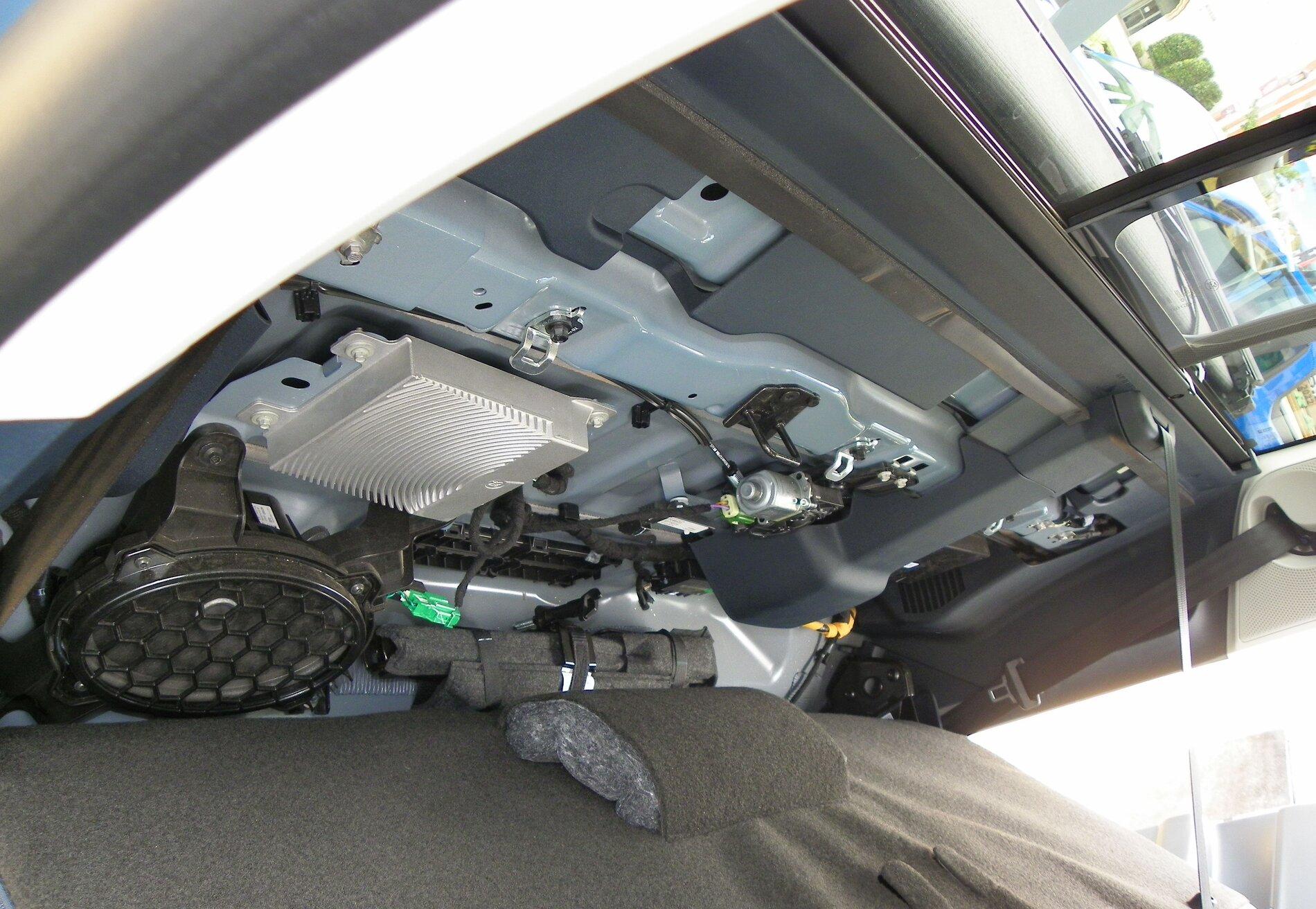

The next picture is of a Lariat with the Lux Package behind the back seat. I think the inverter is the black box in the far right side between the gray pillar and the black plastic piece that has ventilation holes.
Depends on the trim. On an XL/XLT there's a blank plate. On a Lariat there's a second cubby.

There is no doubt in my mind that adding the bed outlet panel would be fairly simple provided you can get the parts. What's behind the panel now? Looks like it's just a blank cover.
I see the round black cover you are referring to. Do you know what the square silver box above it is? Also, it looks like there is a small electric motor back there - could that be the motor for the lariat rear window?

Yes the window motor is center right of the latch for the seat.
The box on the driver's side is potentially the inverter. On the passenger side the "round cover" is the subwoofer and above it the amplifier since that's a Lariat w/ Luxury Package (you correctly identified the power rear window motor/regulator).
Ah, ok, it's clearly a speaker. That makes so much more sense. Now I know where I can mount my subwoofer. :cool:

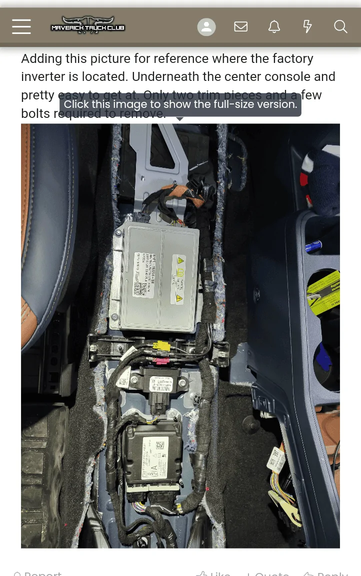

Is the inverter the barely-visible black box above that yellow cable?

My XLT has the 110V rear console plug, and none of that stuff on the cab wall. I believe the inverter is mounted to the floor under the center console.

The inverter is on the floor between the two front seats under the console!!!
