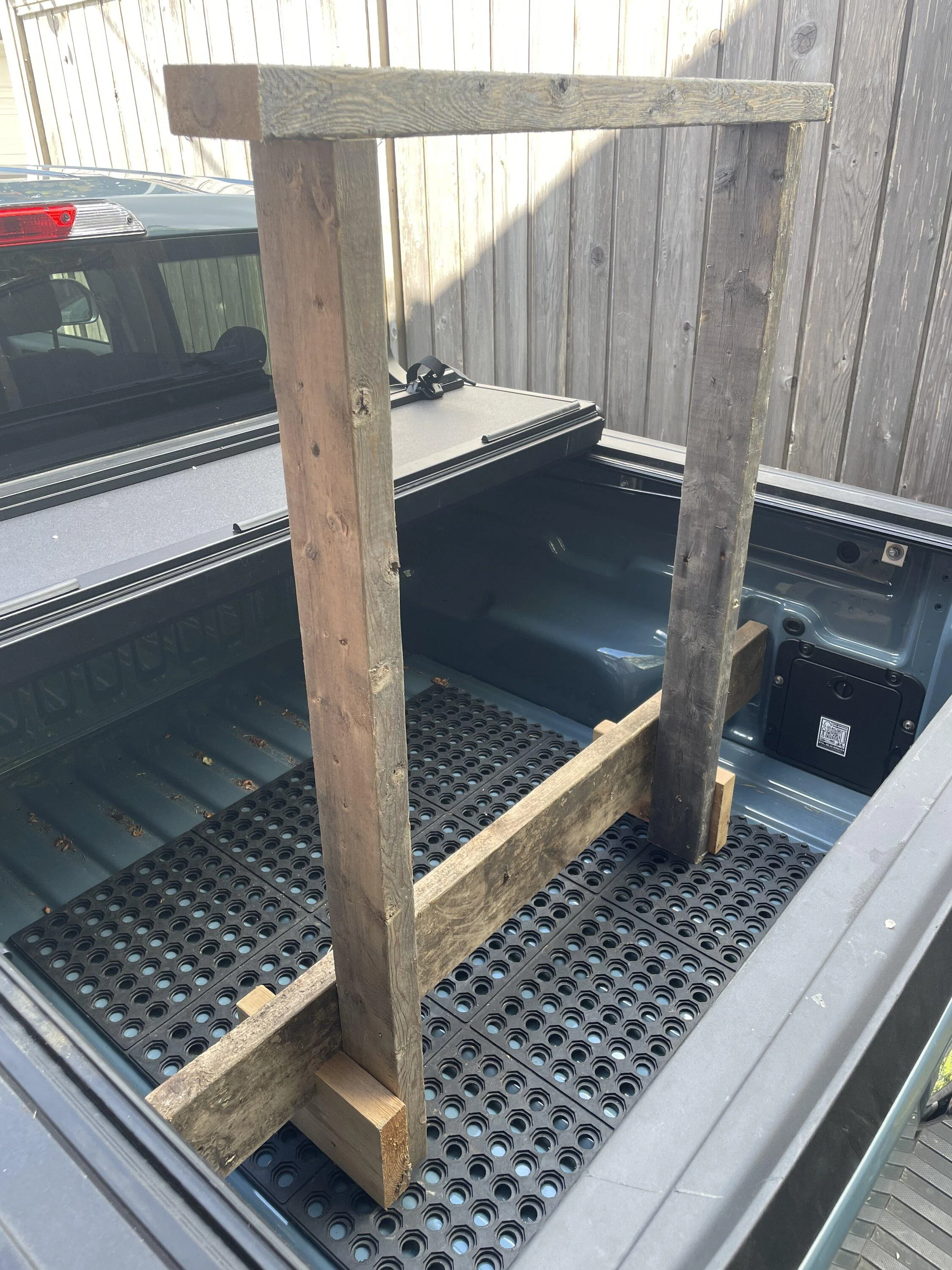

Made from an 8 ft 2X6 and a 12 ft 2X4. I purposefully kept the base pretty narrow so I could get it in and out using the slots in the bed. 2X4 verticals are about 37” to match the roof with foam blocks (no rack).

Nice. Good simple solution. Just tell me you have something on your roof other than a pool noodle. You need a crossbar up there or your roof will be trashed when you catch that headwind that one day. Also I would use a ratchet strap or 2 to secure it to the front and rear of the bed, at the top of the frame to reduce wobble. It could even be a piece of paracord or whatever one way and a ratchet strap the other way, as long as the connect to the top of the frame separately. Other wise have fun down on the ole river!

I’ve got three 1/2” ratchet straps on there. Two over the top to compress the boat down and one diagonal to the thwarts to keep it from flying forwards if I hit the brakes. No highway driving today so I didn’t bother with anything to keep it from sliding back.

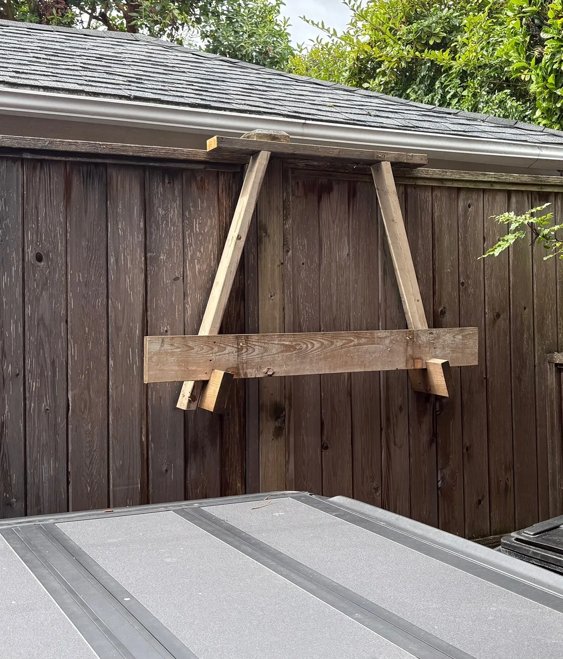

I rejigged it this summer to tilt the verticals inwards so it's a bit stabler.

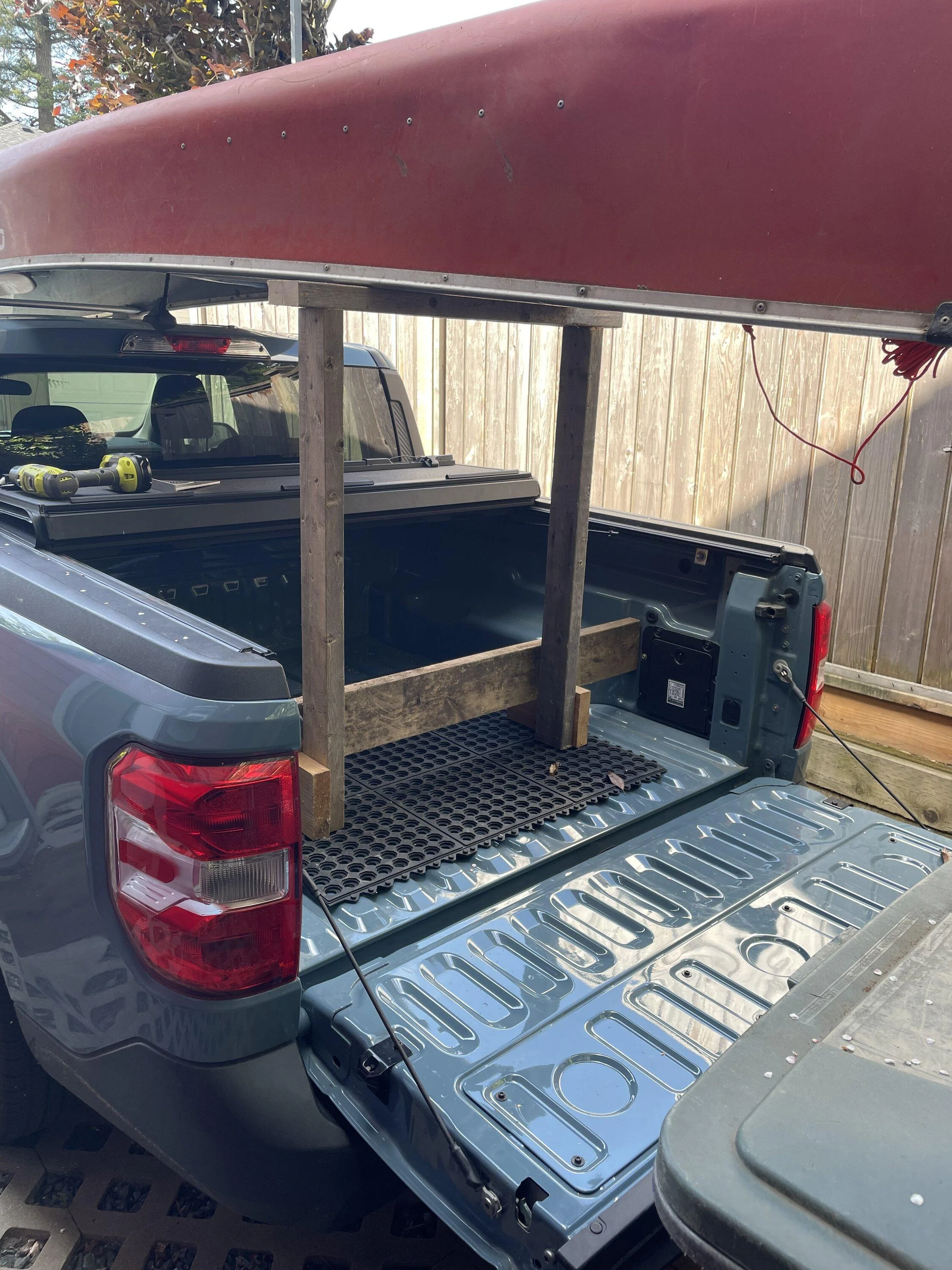

1 ratchet strap from canoe to the horizontal and 1 ratchet strap over canoe to the tie downs, and one ratchet strap over the roof through the front doorframe.

Sounds good! Some people want ratchet down like it's the Titanic up there! That looks like a good system!

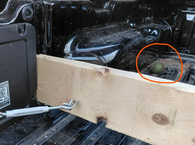

I presume this is your accelerometer and or load balance indicator?
