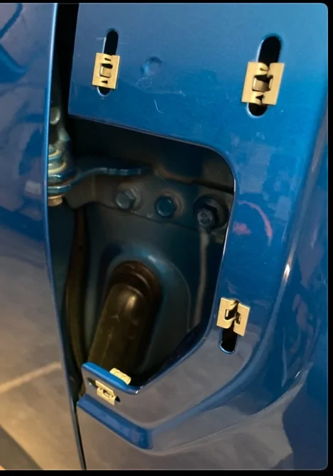

They pop off fairly easy. Just use a plastic pry tool to protect your paint. Or place a microfiber towel under the pry tool:)
There are 4 clips that are virtually unbreakable, but a bit hard to pry loose. Don’t be shy - you really can’t break anything!
They pop back in easy.

Picture of it removed fyi:

Dang thanks that gives me more confidence

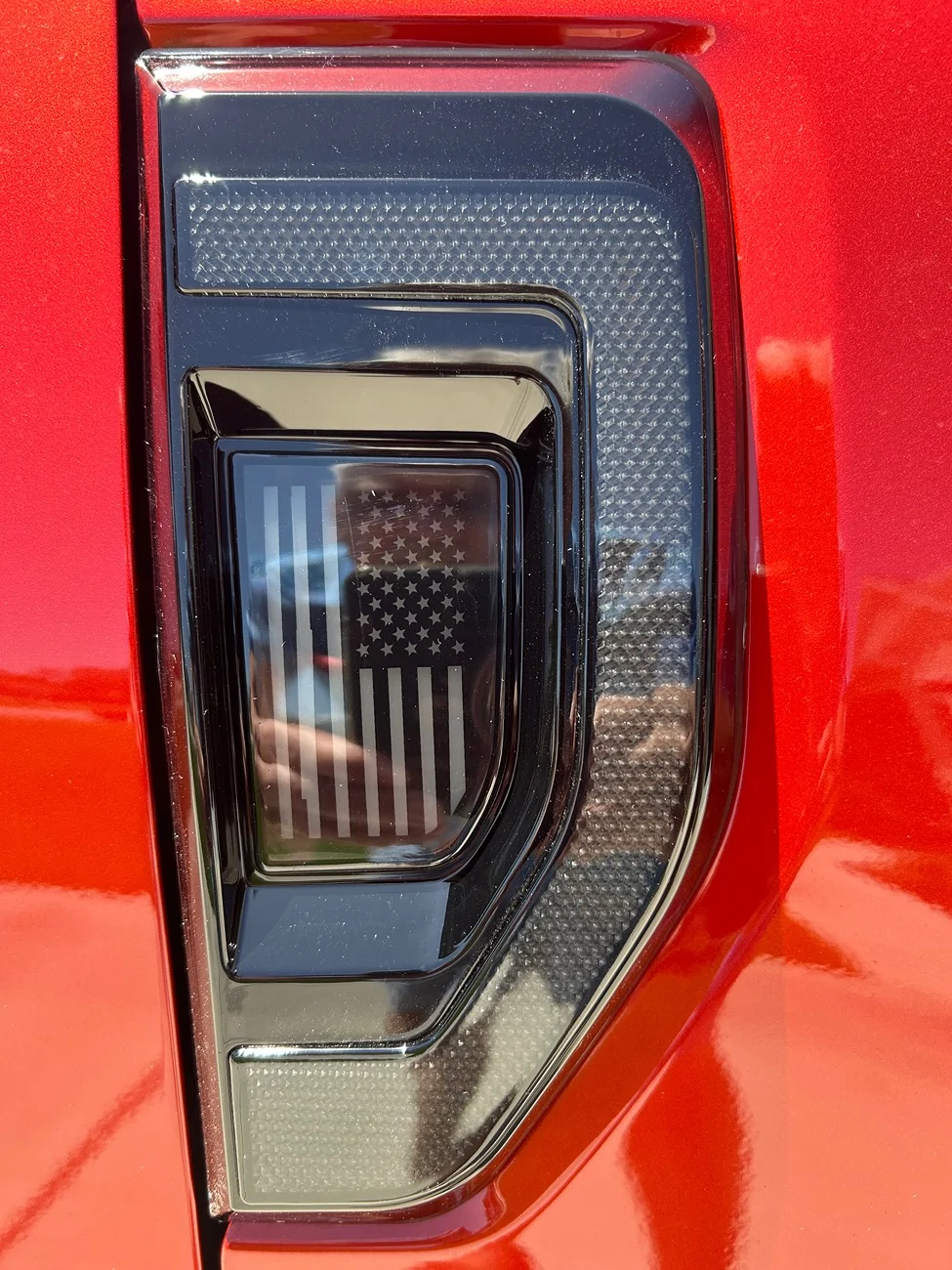

You could fill the area level with Bondo or similar and paint them.
I think the easiest way to go would be to get aftermarket replacements, like the ones with built in signal lights. There are several that are unadorned with factory or logos. I see there are some with desecrated flags if you want to show your desire for the country to burn, though. About $75 shipped on ebay and others.
I'll probably get these in my project to remove all factory logos.

OH! And if you didn't want any lights there, just don't plug them in.
