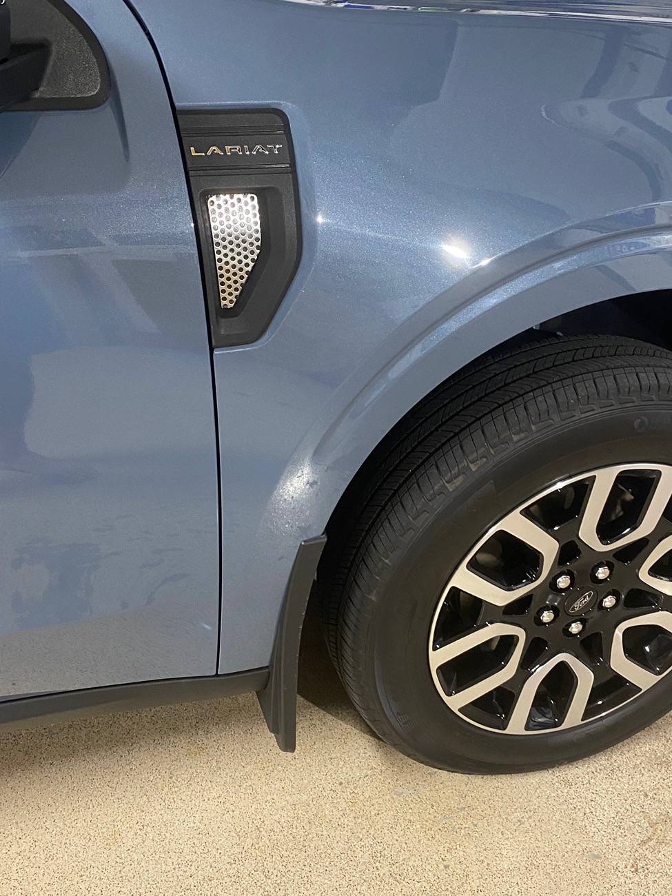

First I purchased perforated Polished stainless steel, I made a template first from masking tape then I installed the masking tape on top of the stainless steel and then cut it out with a cut off wheel in my Dremel after it was done I sanded the edges. The area where you want to install it is not completely flat so you will need to put a slight bend in the stainless steel. After you like the way it fits you can install a thin industrial 3M double sided tape on the backside and then just stick it in place. I like the way it adds a little chrome to match the wheels…. Enjoy

How do you plan to keep dirt and dust from collecting on that tape? Looks nice, by the way.

Painted it black after I was done and wiped it down with lacquer thinner, no dirt 👍
