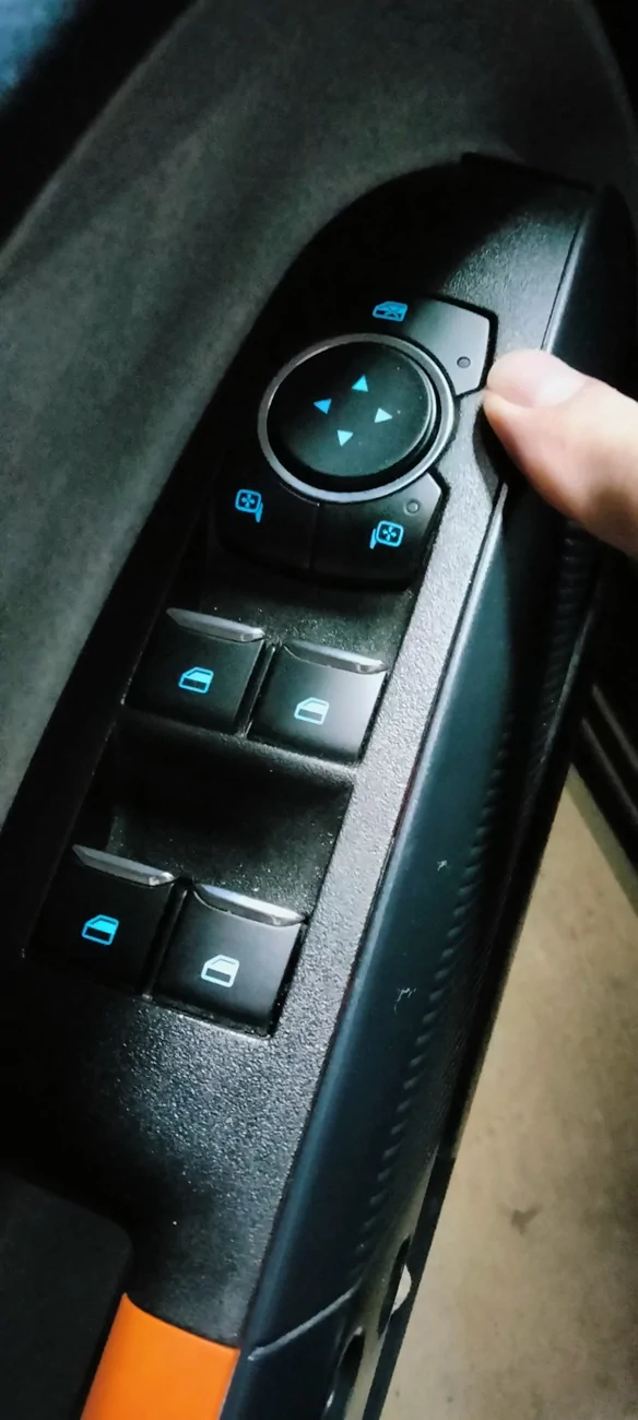

Are you referring to a switch that looks like the one I'm pointing to?
Ford Maverick Window switches 2024 maverick xl IMG_20260411_172244

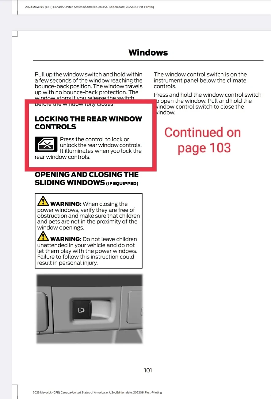

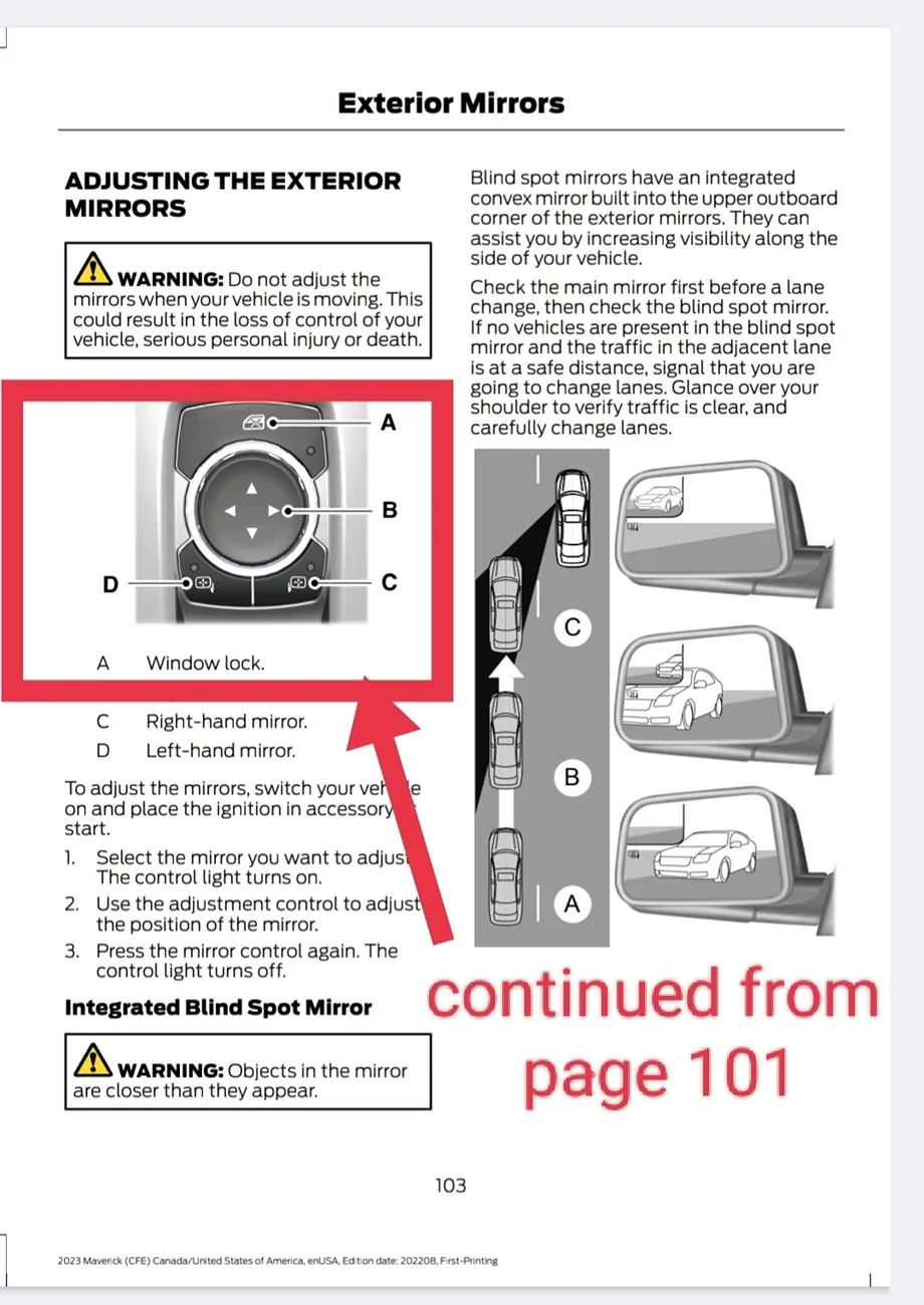

If this is indeed the switch.
Check page 103 of your owners manual.
A corresponds to the window lock.
It locks all the other window switches out except the drivers.
