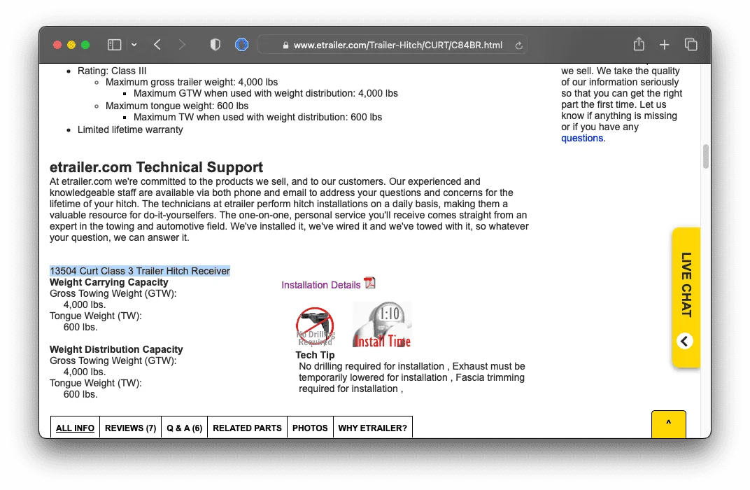

Sorry to jump in on this thread for my first post but I am currently outfitting a 23 Maverick XLT with accessories and I just purchased the Curt hitch since the truck didn’t come with it. My family and I are big into the Ford lineup of vehicles I have an F150 and Expedition and currently added a Maverick out of luck. My father in law ordered one and fell into financial trouble and couldn’t purchase it so I wasn’t going to let it go knowing how popular and cool these trucks are. I figured maybe I would sell it (I could have flipped it quickly) or keep it for my business (insurance agency). I decided to keep it and put my logo on it. I also have a small 6x10 enclosed trailer that is wrapped that I take to local events for my business, I want to pull that with the truck but he didn’t order it with hitch or towing package. I did my research and got the Curt hitch since it seemed to be the best aftermarket hitch. I am now in the stage of what to do for the 4 pin connector, I know Curt, Reese, and Tekonsha make kits but don’t know what to do or what others have done. I also don’t necessarily like cutting the panel in the middle of the bumper but haven’t seen any other options. Looking forward to all the great info on here.
