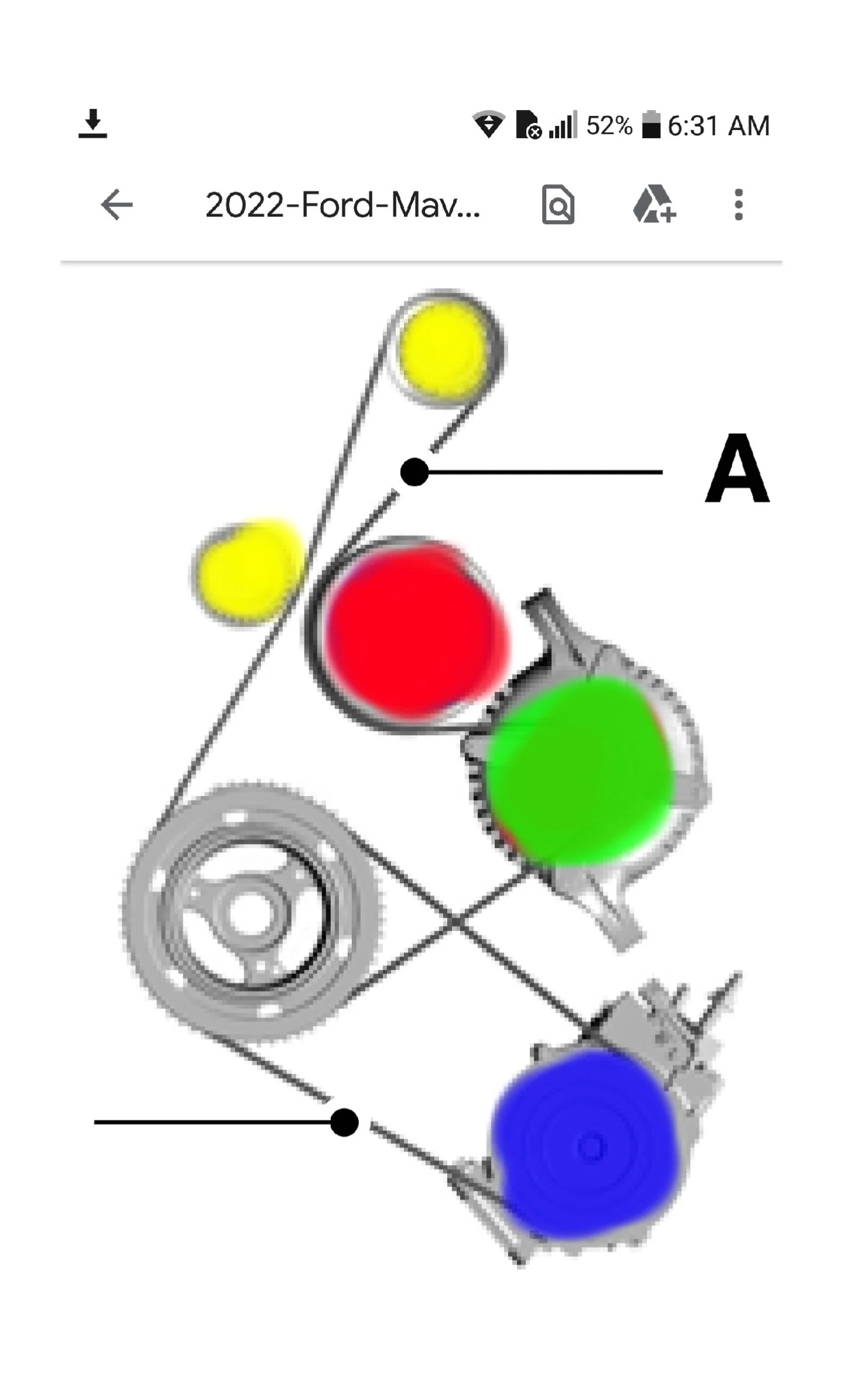

I have a better question did they place the water pump inside the engine? If they did I’m not buying this car I just paid $3000 to replace a water pump in my 2016 Ford Explorer because Ford thought it was a genius idea to place the water pump inside/under the engine. Can someone please help if they know where the water pump is located?
I don’t know the locations. Are you asking for the Hybrid or EcoBoost? The hybrid should have 2 electric water pumps and be easy(ish) to replace. The EcoBoost will be connected to the drive belt and be a pain to pain.

Here
Two
The water pump is red pulley. Green is alternator. Blue is A/C compressor. Yellow are idler/tensioner.
