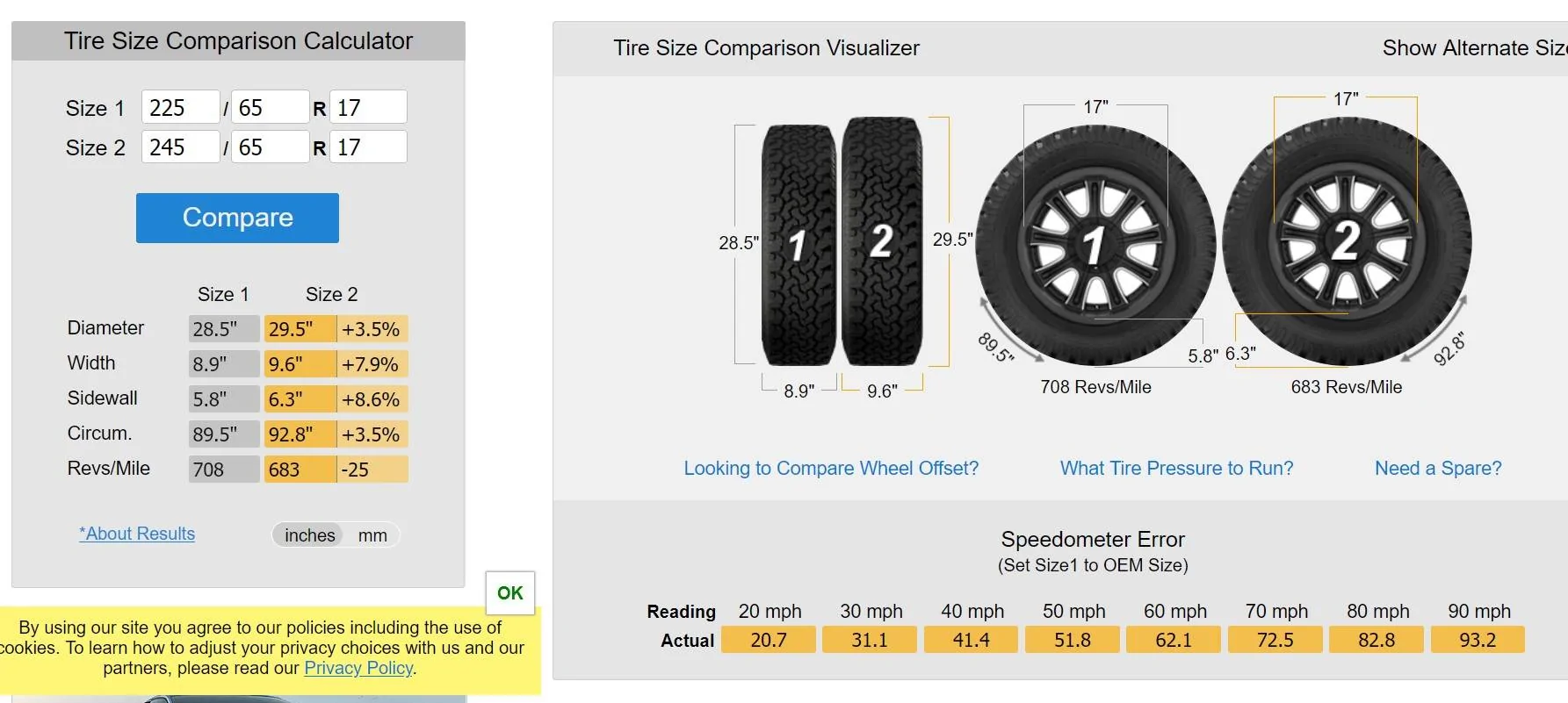

Are you quoting displayed mpg rather than calculated? Remember that with larger tires, you are now traveling farther per tire revolution than before. The display doesn’t know that. This would account for at least 1 to 2 mph of your displayed loss.

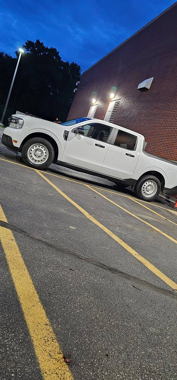

Like your steelies. Proper look for a truck. 19” wheels are too susceptible to pothole tire damage.
I’d want 17” steeliest even on a Lariat.

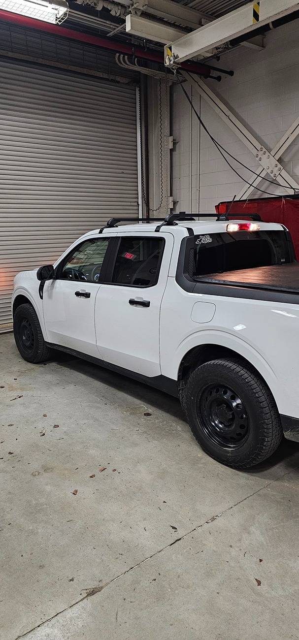

I used up my stocks for 20k miles of mostly highway. I still have them, they're just stored for now. was getting between 28-32mpg average depending on my personal driving habits.
recently upgraded to 245/65r17 falken wildpeak ATs, and shew, im MAYBE getting 27mpg on the highway. I can baby it to 30 at 55-60 but anything over that and it falls off.
Well did you calculate the 3,5% increase in diameter of your tires.. Todays 27mpg if not adjusted is really 27x1.035= 27.98mpg or 28mpg which is what you initally claimed with the factory tires..
It my calculations are correct, you have virtually no loss of fuel mileage as you think..
