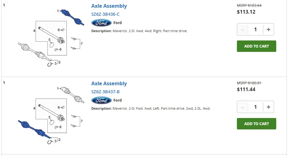

Looks like my 2022/FX4 drivers side shaft is now toast- Lots of wobble- Hoping to stock check inventory before booking a warranty appt-
Thx-

Are these the latest and greatest ?
Ford Maverick Updated FX4/ECO- Drive Shaft PN #s ? AXLE

From what I can tell, they are the updated versions of the original nz6z but are not the heavy duty pz6z ones used on the tremor which are more expensive

So I called my local Ford Service Manager and they could not confirm if the pz6z ones on the Tremor would fit my 24 Maverick XL AWD Ecoboost with Tow Package and they are non-refundable items.
Has anyone actually done this and can confirm fitment?
That would be Fantastic info to verify, hopefully someone with first hand experience will respond. I've read lots of chatter here where they desired them and wanted to use them but don't recall anyone posting any facts. That would be a hard pill to swallow if they didn't fit and being non refundable. It's hard to determine when searching the oem parts suppliers online. Maybe some of the members that are ford tech's can provide input.
