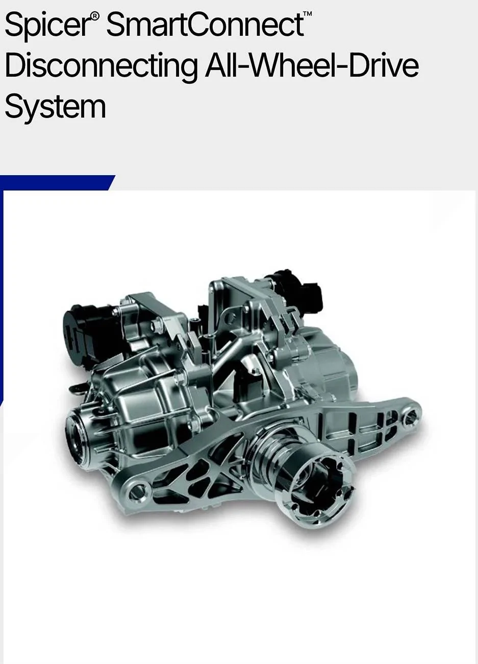

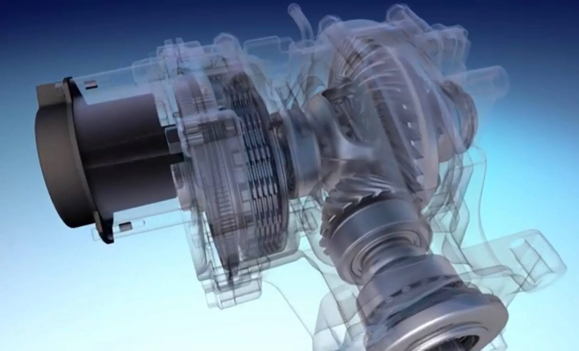

The purpose of the clutch pack in the single clutch rear RDU, like in the FX4 models, is to prevent the rear axles from spinning the rear differential when driving in FWD mode. When the clutch is disengaged, the ring gear, the carrier, the pinion gear and the drive shaft come to a stop. Only the rear axles are spinning and nothing else.
The only way get the drive shaft and rear differential to stop spinning and to improve your mpg is to have a clutch at both ends of it.

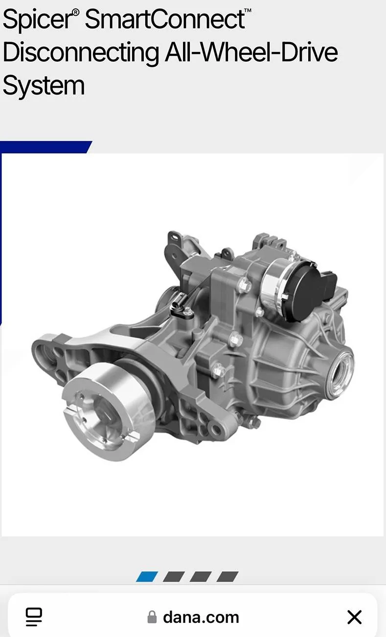

The second clutch of the Spicer twin-clutch RDU in the Tremor operates the electronically locking differential.
Ford Maverick Two clutch packs or three? IMG_2088
single clutch:
Ford Maverick Two clutch packs or three? IMG_2089
Single clutch:
Ford Maverick Two clutch packs or three? IMG_2091
dual clutch:
Ford Maverick Two clutch packs or three? IMG_2092
