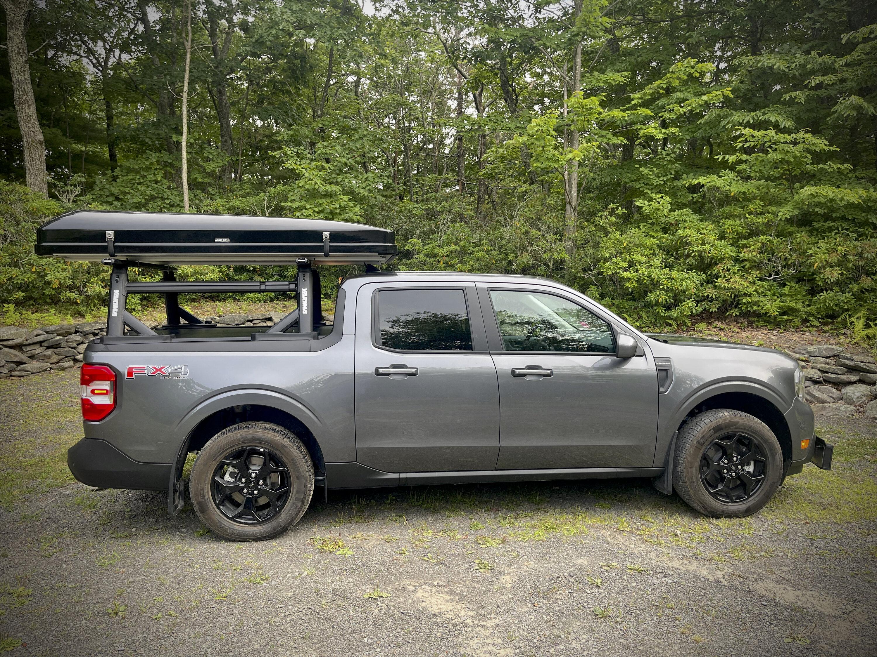

In any event, I recently took the family and our month-old truck on a 1500 mile road trip/camping adventure, which allowed me to generate a somewhat informed opinion. Headline: I am very, very pleased and impressed with this little truck! In addition to using it for daily driving, our crew of four (two adults, two kids, and a dog) utilize a rooftop tent, which was mounted on our previous vehicle [a large SUV]. The hope was that the tent would work well on the Mav, and that it would sit lower than it did on the roof of the SUV – which would help with clearance issues in our garage (a major pain requiring sandbags and lowering tire pressure in the SUV). And further, that our camping gear would fit in the truck in a functional way. Mission accomplished!
We’ve owned the rooftop tent [iKamper Skycamp 2.0] for awhile now, but the credit card would get quite a workout as I assembled the parts required to mount the old tent above the new bed. Given the worldwide supply chain issues and my generally impatient and acquisitive nature, I went ahead and ordered the necessary parts long before the truck arrived, hoping to have all in place before a planned summer camping trip. The good news is that the truck arrived just in time, and each of the pre-ordered accessories worked out nicely. In case it's helpful, the key bits were/are:

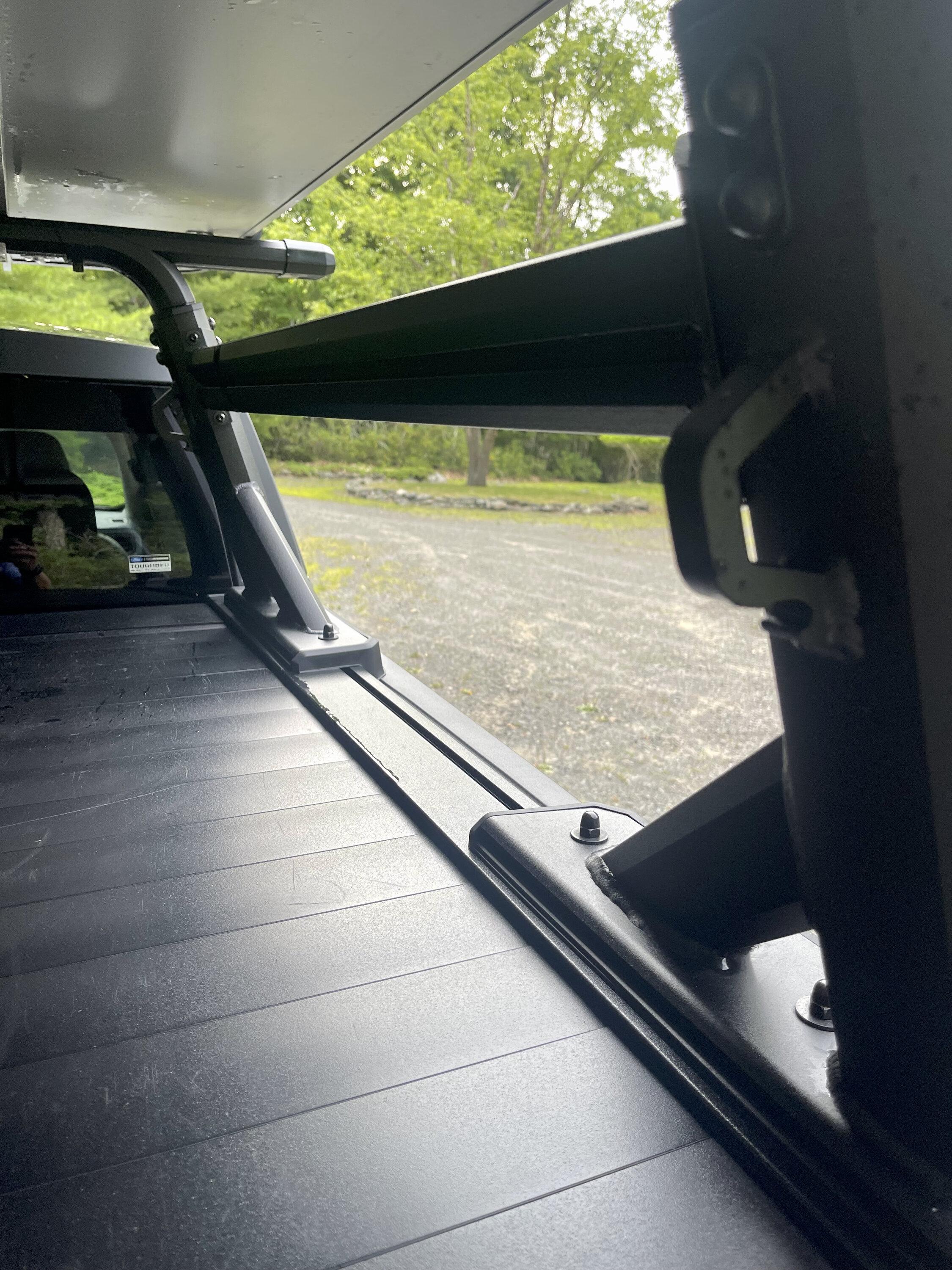

Retrax Pro XR tonneau cover: this item was pricey at almost 2K, and the canister takes up precious bed space, so I was worried I had made a very expensive mistake…but after experiencing some serious buyer’s remorse upon ordering the cover [when it was on sale] and then installing it at long last, I’m pleased to report that so far it’s terrific. Reason is that, in addition to providing a lockable and mostly rainproof truck bed, when paired with the rack system described below, the aluminum tonneau cover essentially provides a second ‘shelf’ above the bed on which to pack camping supplies or anything else. This proved invaluable, and I was also able to maintain a sight line out of the rear view mirror by leaving the center of the tonneau cover clear of items (see photo below). Win!
Yakima Overhaul HD rack, HD Bar 60”, Side Bar, and Tonneau Kit 1: the combination of these four [also very pricey!] parts not only allowed me to mount the tent above the bed on the integrated tonneau cover T-slot rails, but also [with help from the side bars] created a sort of cage around the top of the aforementioned tonneau cover ‘shelf’ – providing protected space for plastic bins, milk crates, etc that are wholly independent from the bed-level storage. I went with the bigger Overhaul HD over lower-profile options like the Outpost HD because my rooftop tent is pretty huge, and if I had tried to keep it below the height of the cab, the overhang off the back of the truck would have been significant; I didn’t want to go there for various reasons. I also wanted the ‘shelf’ above the tonneau cover to have more overhead clearance for bigger items. That said, there was definitely a price paid on fuel efficiency, owing to the additional drag (average on my trip was around 22-23 MPG, though as mentioned below there were other contributing factors in addition to my ever-expanding gut).

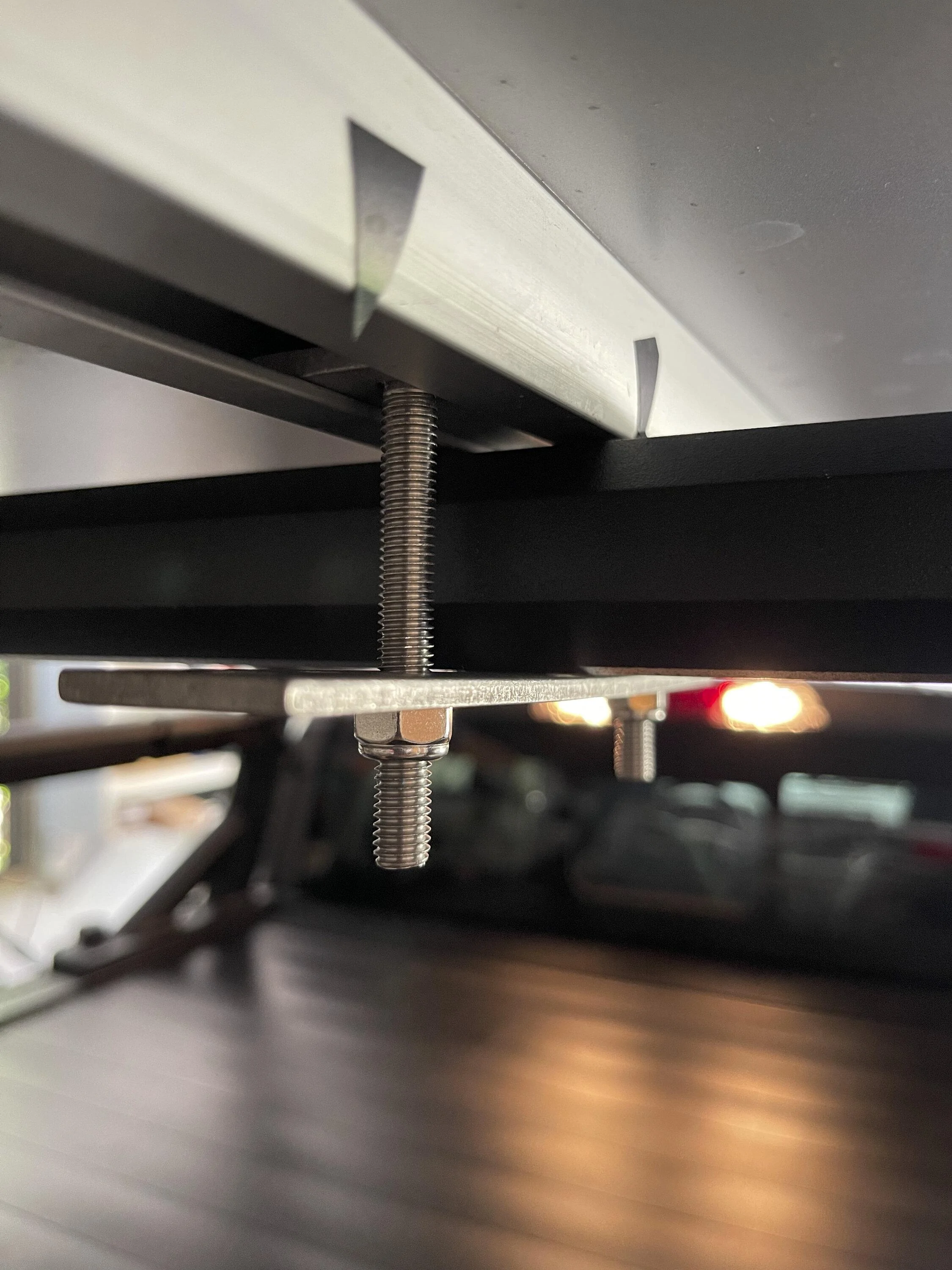

For anyone who owns an iKamper and plans to purchase the Yakima HD bars, I should mention that the iKamper-included roof rack mounting hardware - the cooler and more minimalist ‘2.0 system’ that came with my rig a couple years ago - won’t work, owing to the thickness of the Yakima bars. However, the original 1.0 bracket hardware will work with this bar and the tent's rail system. So you’ll need to order that part separately (though iKamper says that the latest 3.0 hardware included with new tents/the newest rail system will work with Yakima bars). Further, the Yakima Tonneau Kit 1 [the adapter kit that interfaces with the Retrax T-slot rails] has been perpetually on backorder over the last year, and it was only through sheer luck and perseverance that I found a random set floating around in a sporting goods store very far from my home and was able to snatch it up. Plan accordingly!

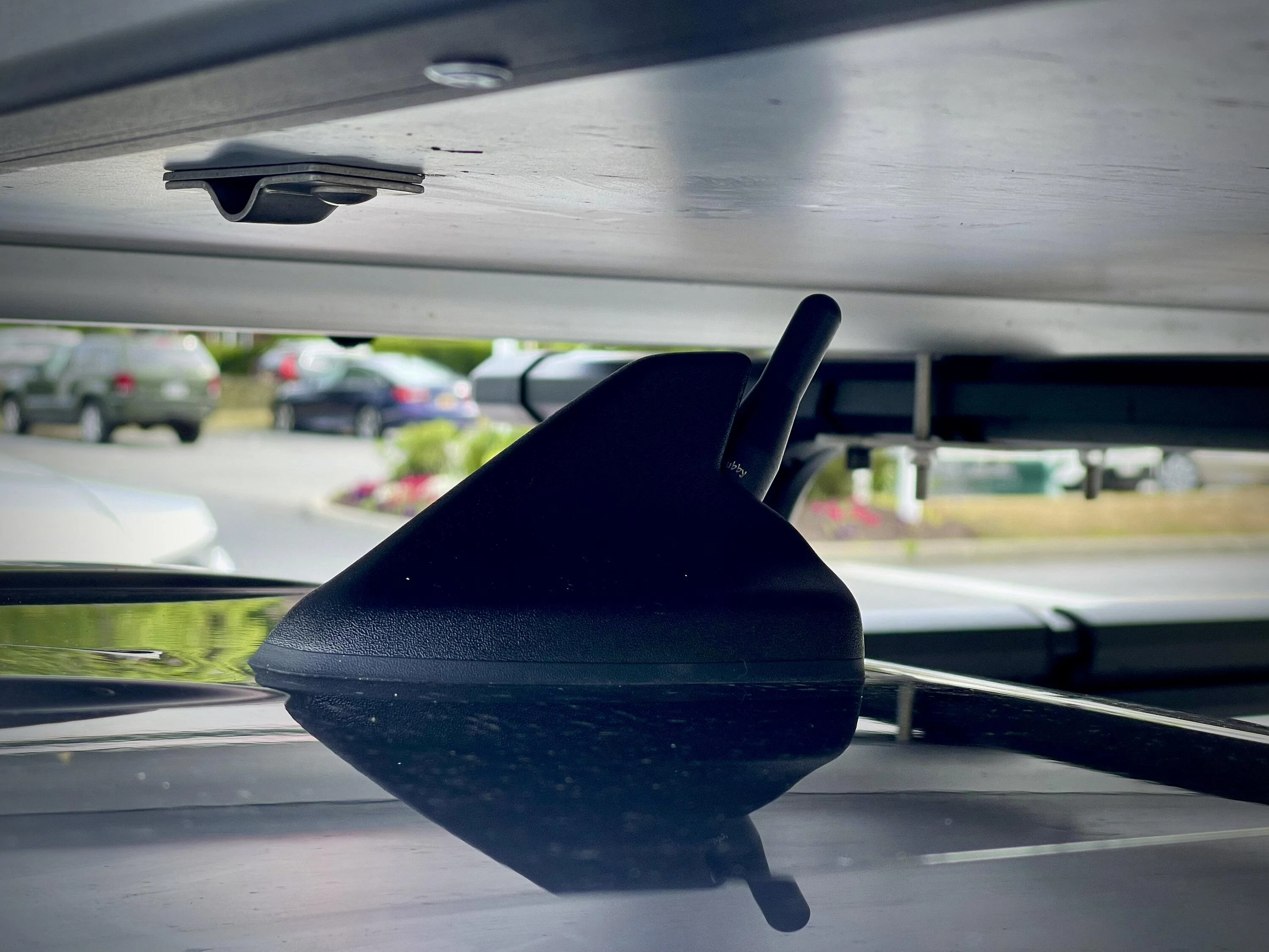

CravenSpeed Stubby JR Antenna: needed this in order to avoid the factory antenna mashing up against the rooftop tent where it hangs over the back of the cab. Reception seemed fine, though mostly we use our phones/internet for audio.

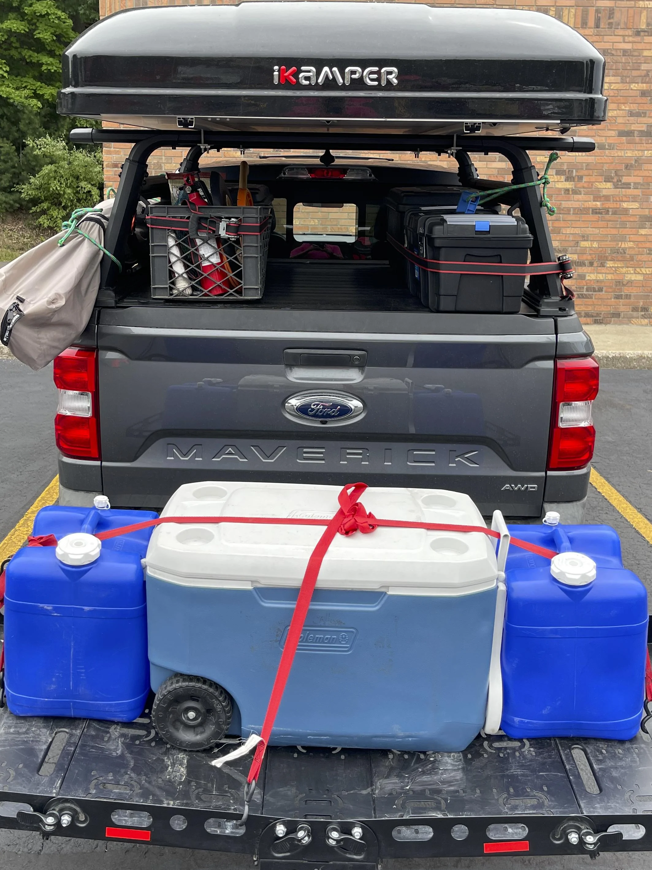

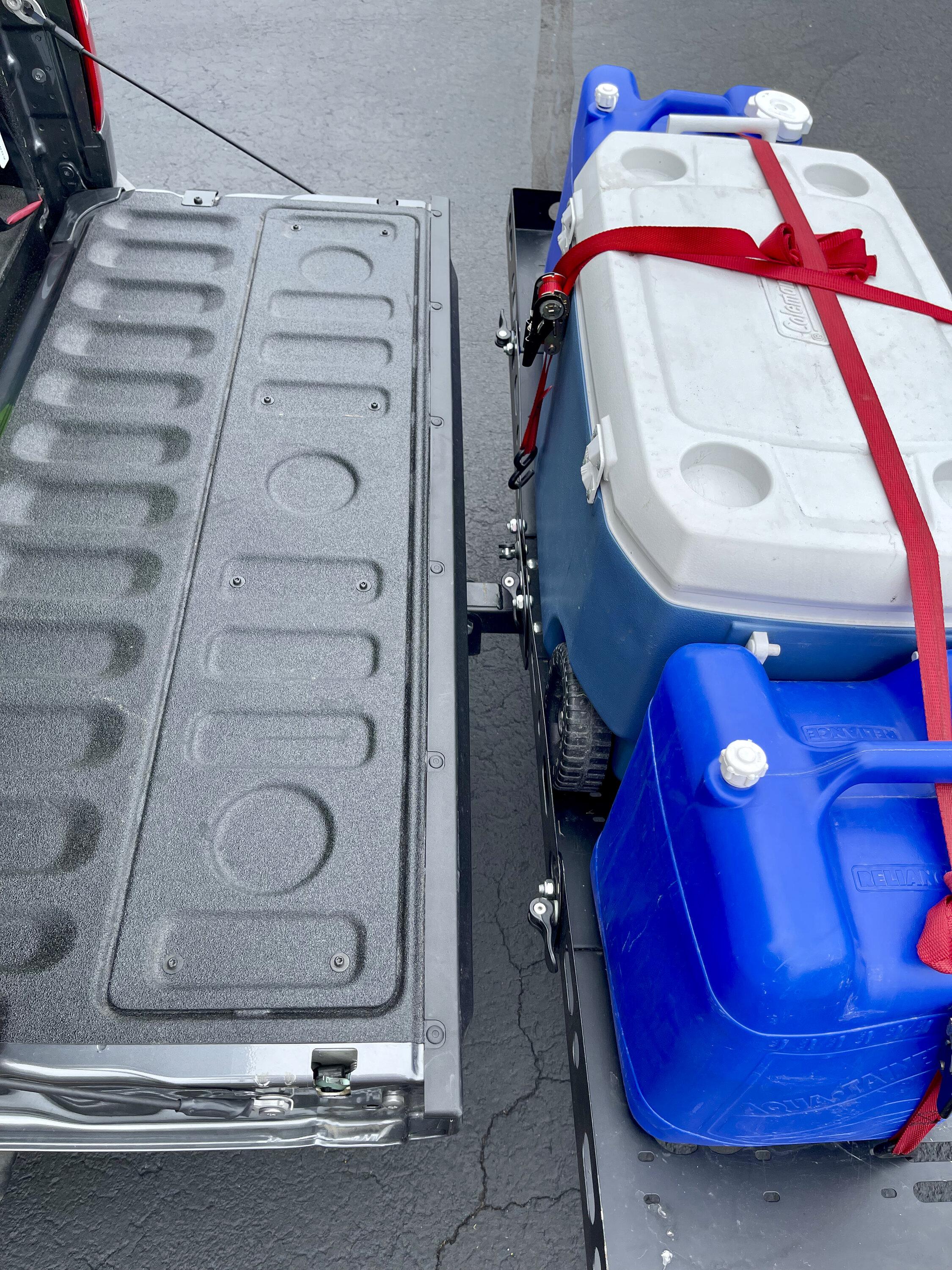

Etrailer Folding Cargo Carrier: this may be TMI, but I needed a little more space for bulky items such as cooler, water jugs, etc…so I added this carrier to the truck’s hitch mount. I could have crammed most of these items onto the aforementioned tonneau shelf, but it would have been really tight and would have entirely eliminated my rear view. Anyhow, I’ve had this cargo carrier for a couple of years and it always annoyed me that the tongue length was so long – like why not have the carrier platform sit closer to the vehicle, for 1,001 reasons? But it turns out I was wrong, as the distance from tongue to storage platform on the Maverick left just enough room for the tailgate to open without interference. Yas!
