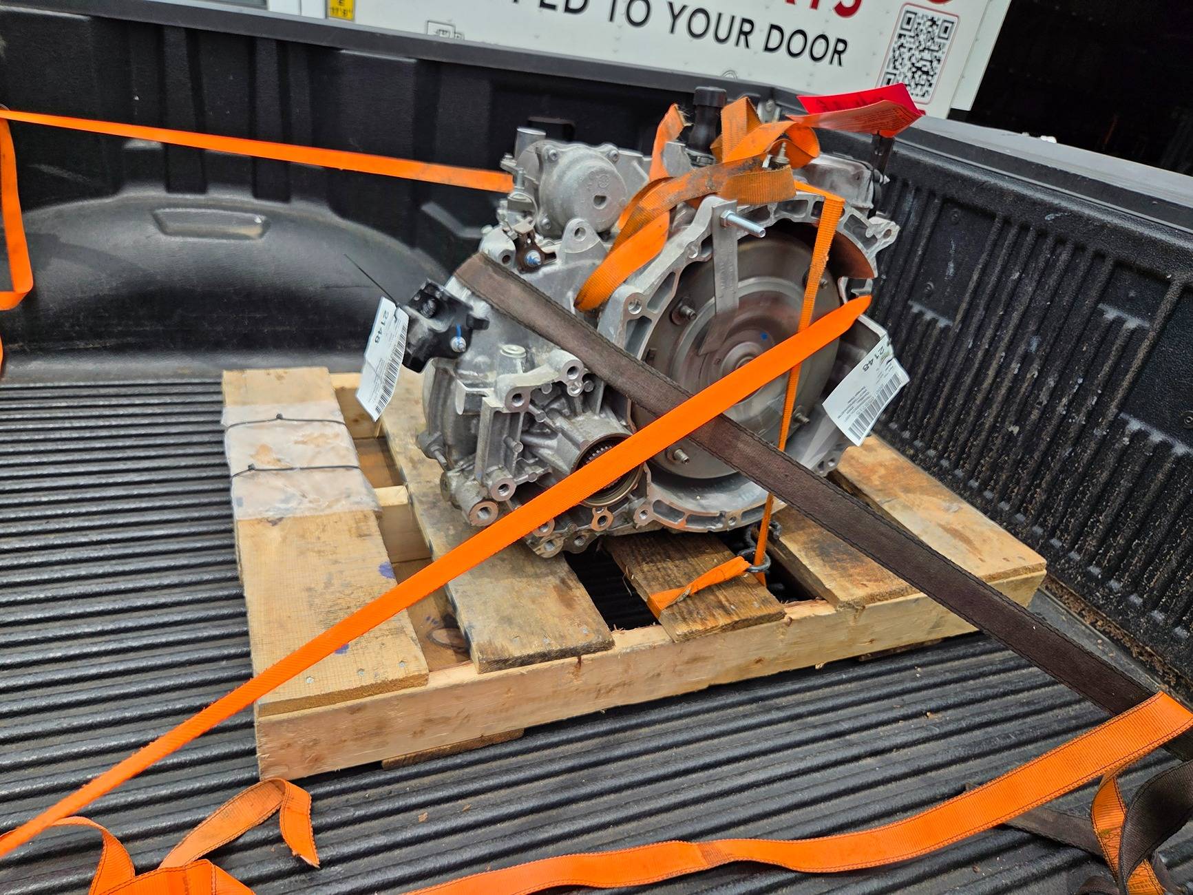

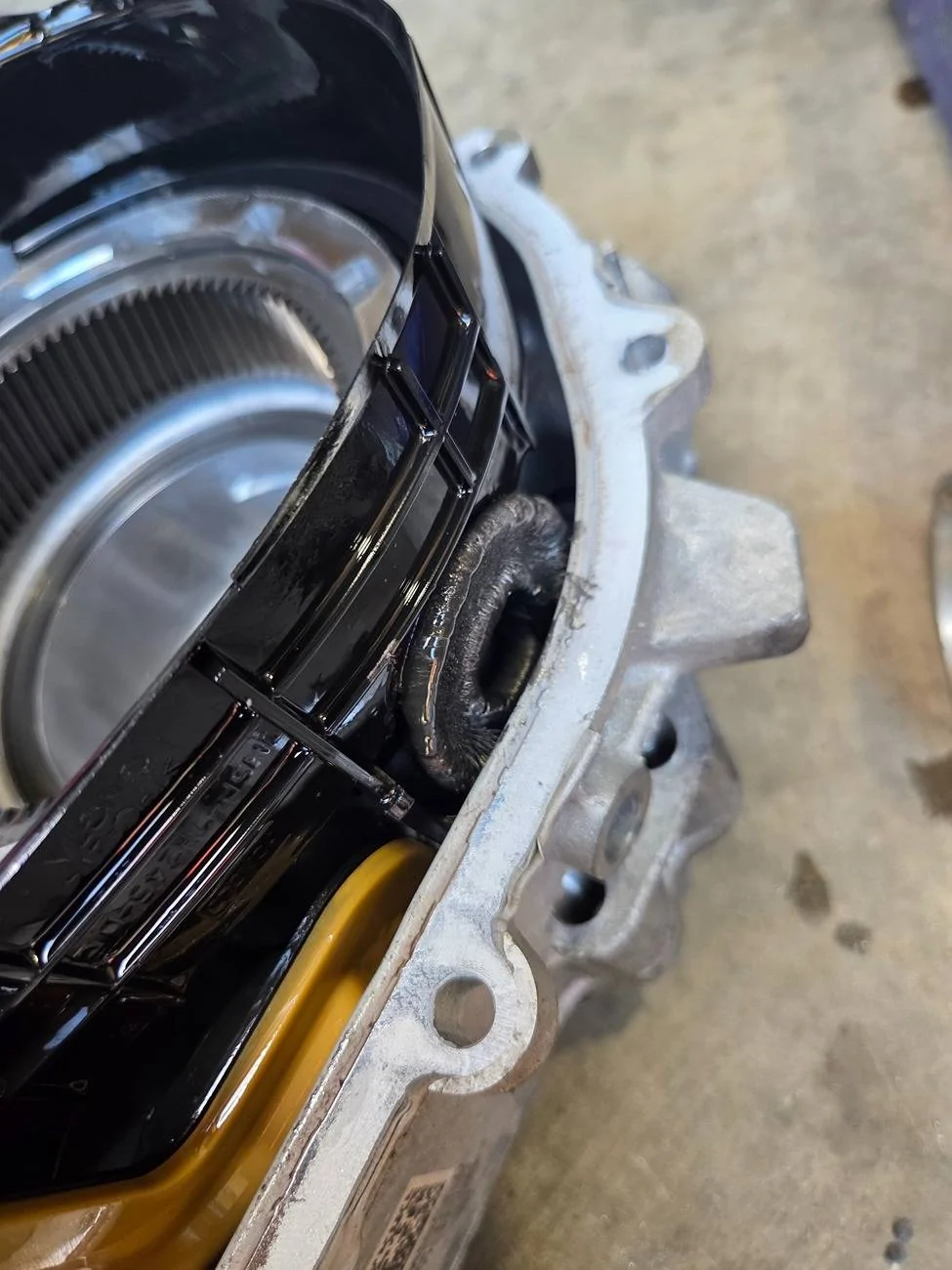

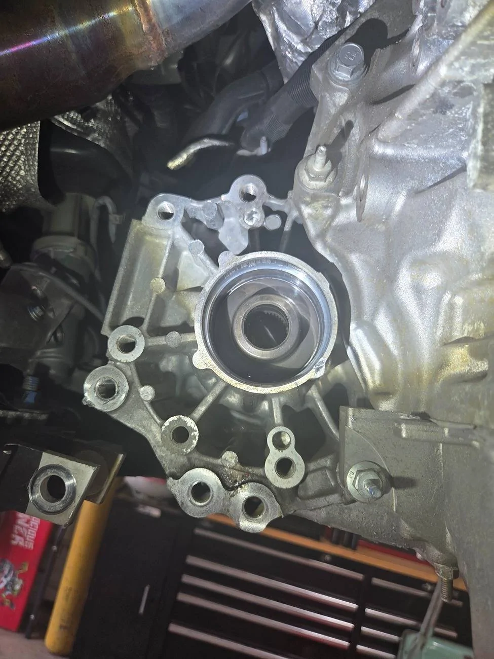

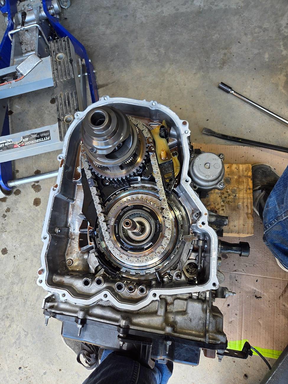

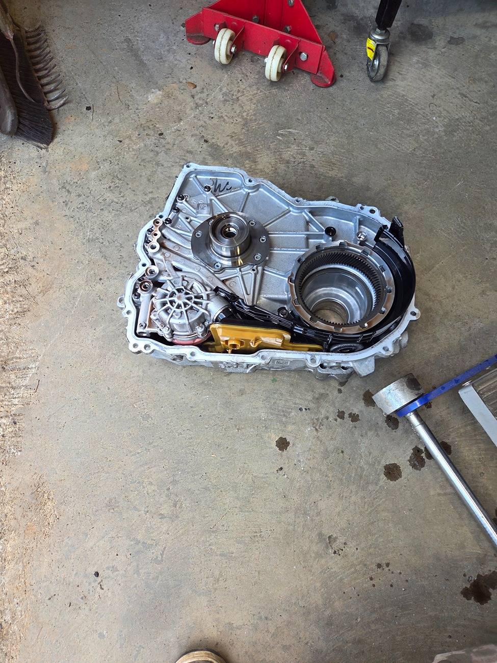

8f35 failure, was expected but not wanted. Tossed in another awd maverick trans. Swapped output differential for my fwd. I dont wanna keep swaping trans and there really isn't any parts to beef up more than the 8f40 equivalent. I can make a mmt6 work physically from the mounting and adding a pedal and cutting the console for a shifter, no worries. For the $2k spent on auto doner I coulda got all needed parts, but timeframe to drive way more than 3 days. If I pursue this avenue, who can help with the software communication issue that will arise. I wanna keep the dash looking oe with the clutch pedal down there. Is there any info on this swap?

I'm curious: are you flushing the transmission cooler to get all the metal bits out? If not, you'll be circulating metal debris from the old transmission into the new one

Cooler changed with trans. No worries there.
