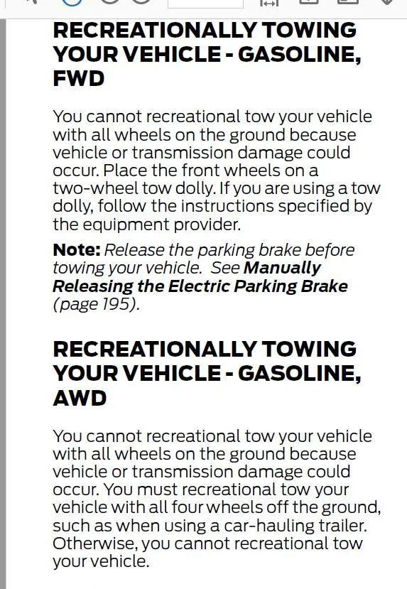

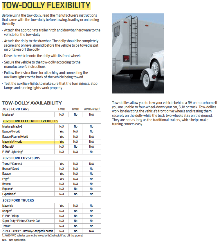

I do wish that Ford would chime in on this topic and provide an authoritative answer and if Dolly Tow is NOT available - explain why. (FMC, are you out there?)
This is the documentation I talked to FMC Customer Service about. They confirmed, to me (in writing) that the information was correct. You can either Dolly Tow -OR- Flat Tow the 2023 Maverick Hybrid. This is what I am going by and will be towing my 23 Hybrid to Mississippi in the coming weeks. If I end up damaging something, I will be sure to post. I am not expecting any issue as I have already done a "test" tow with the setup.

It makes sense you CAN with a FWD vehicle.
However, it is upon YOU to undo the automatic parking brake that may randomly apply, depending on slope with vehicle on dolly. So in some cases it MAY apply, and other cases not.
