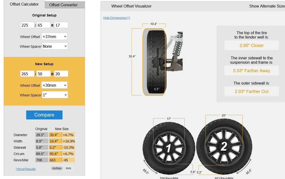

some very good replies. the solution to the high positive offset wheel issue (which I agree with) is simple: spacers. if you have a 20x8 ET30 wheel and you want the full skateboard effect, you go with 2" spacers. if you just want a little poke, 1" or 20mm, something like that.
use this calculator:
https://tiresize.com/wheel-offset-calculator/
23Lariat nailed it, the 265/50-20 has a ton of tires from 'sport truck' all season to all-terrain, even some with 3pmsf rating if this has to be driven somewhere with real winter weather.

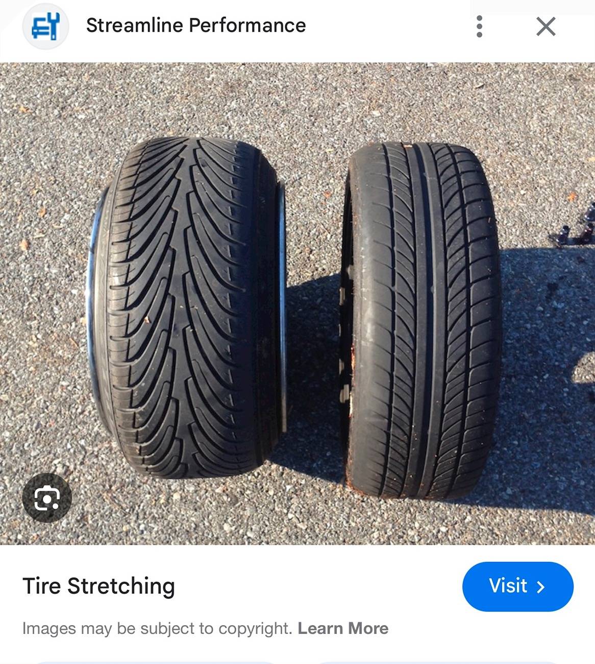

I’d like to not have that bulgy sidewall look
Bulgy sidewall look? You mean the “stretched” look?

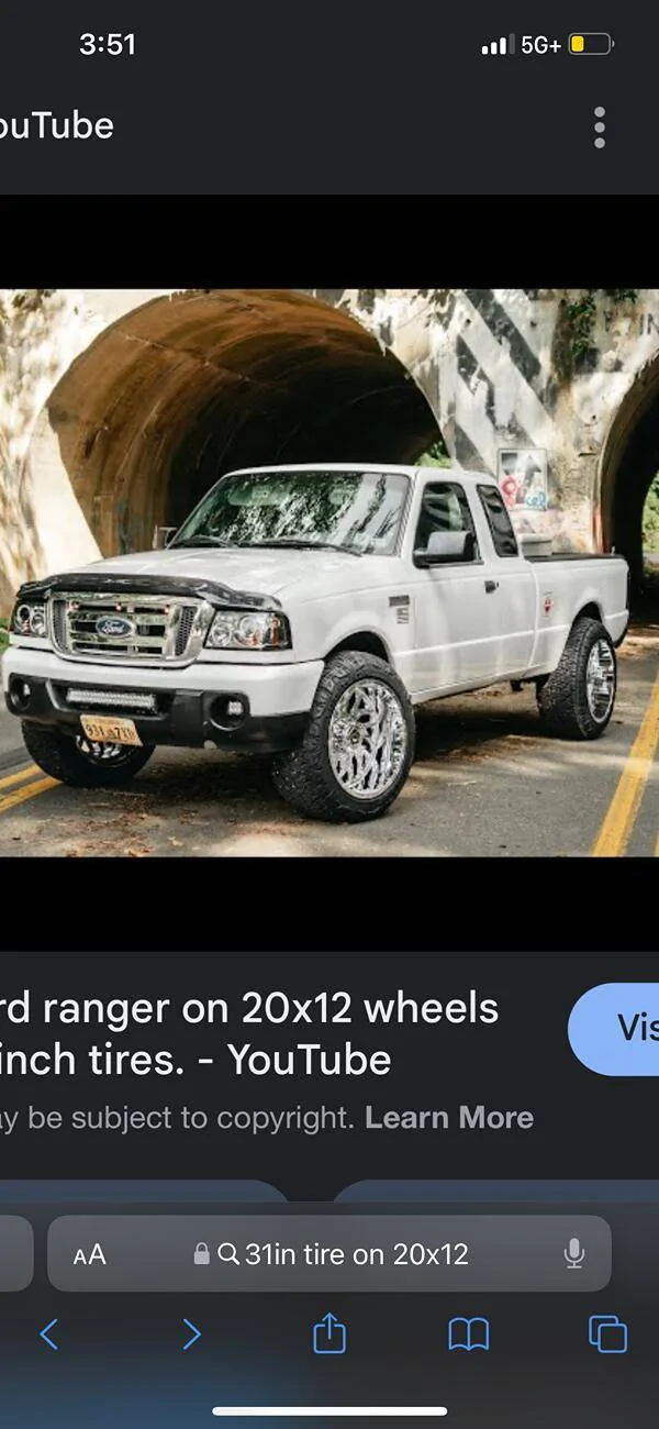

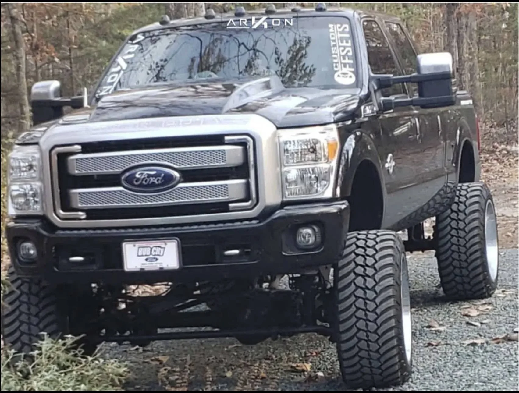

You said you want to run 20x12 wheels. There are ultra wide tires that are spec’d for 20x12’s, but they are also low profile, like the 325/30R20, but that is only 29” diameter.
once you drop back into 31” SUV sized tires, like a 305/50R20, those are spec’d for 20x11” wheels because they start to look stretched.
if I was in your situation, I would buy quantity 1 of the cheapest 20x12 or maybe 20x11 wheel I could find, then mount the cheapest tire I could find on it and use that to test fit your rig, before dropping serious coin, only to find that you can’t make it work.

He didn’t say anything about going off-roading.
And saying that he wants concave, chrome, “rims” leads me to believe that he is looking for stance, not off-road prowess. Something like this?
Oh it's gonna be one of those. Their truck, their dreams.
