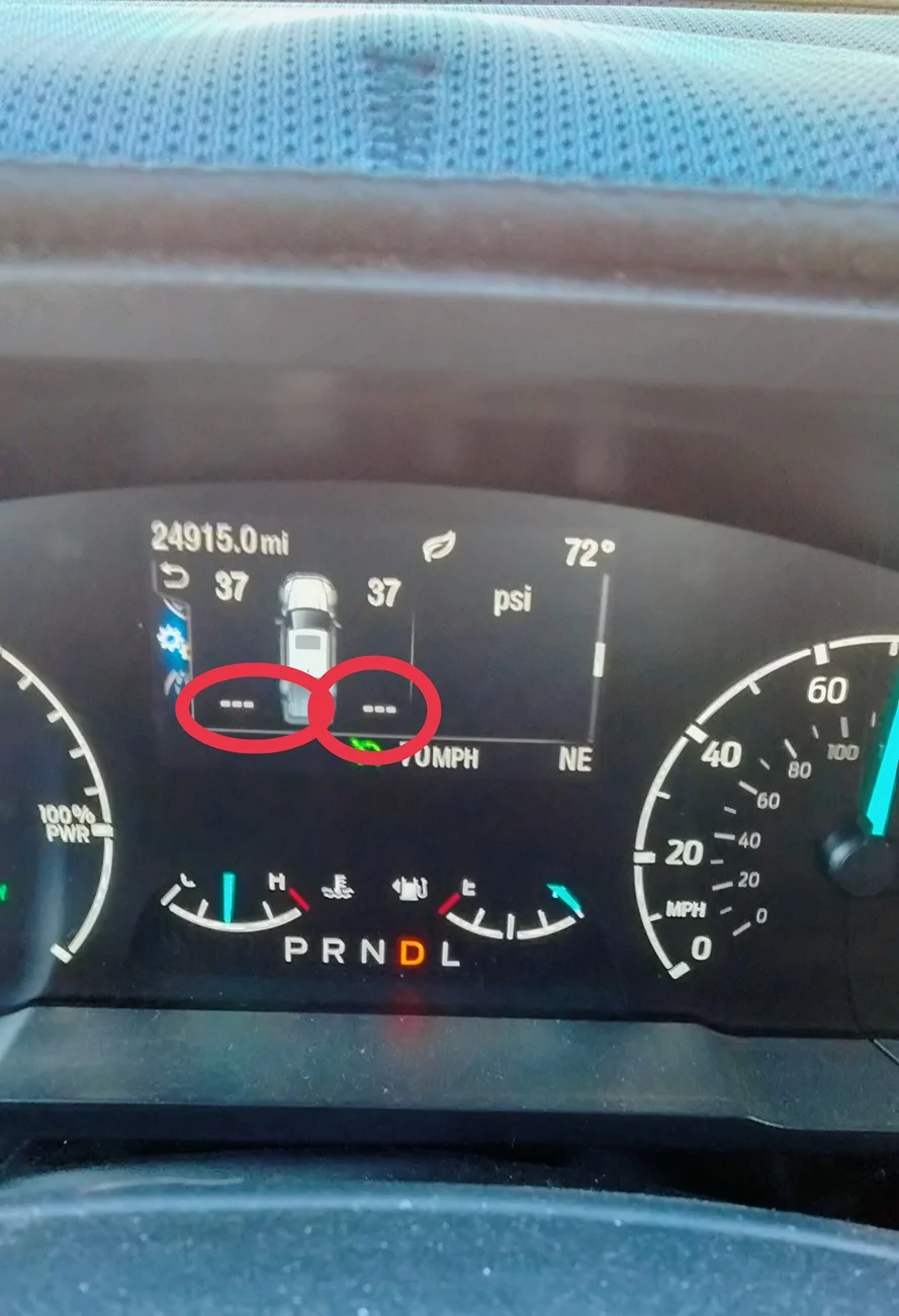

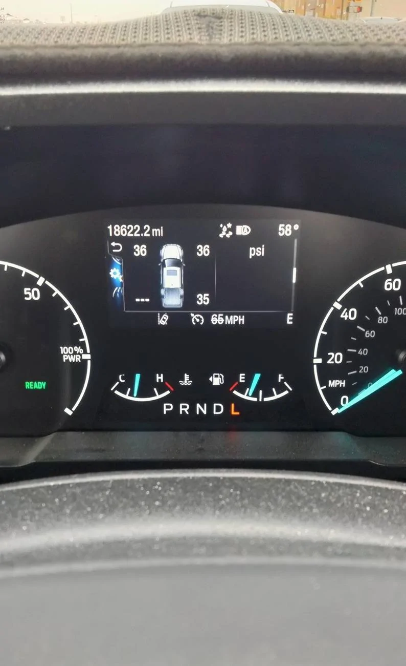

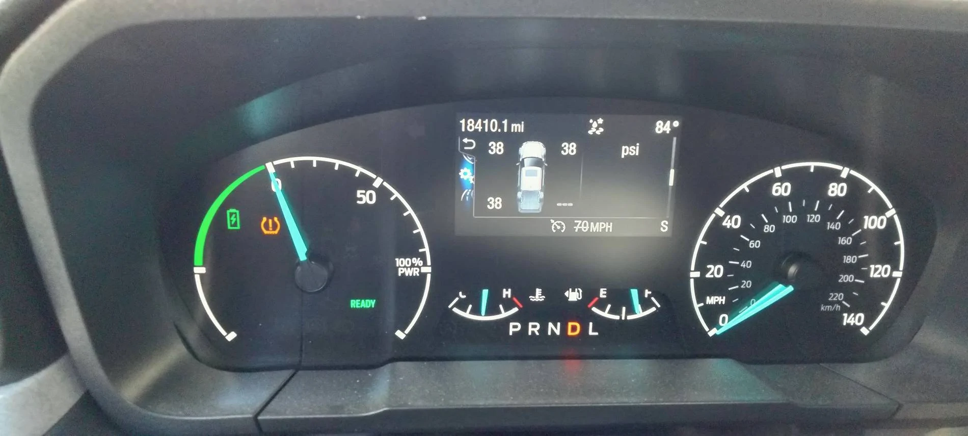

It actually happens to me couple times a year. It happened a couple of weeks ago both back tires were showing -- 🚘 -- I did not have my phone with me at the time, so no pictures of the most recent.
I learned not to sweat it, I knew the readings would come back the next morning when I started the truck and they did.
Do yours look like any of my pictures?
This is from a previous post in a different thread.
Check out the odometer. 35 miles later and all is fine.
Two bad TPMS AT ONCE... I don't think so. You can clearly see from the speedometer, the truck was moving. Did both batteries go bad at the same time???🙄 I don't think so. Logically it didn't make sense.
Then a miracle happens 🙏
A few miles later, they BOTH start working.
That tells me it's not the TPMS sensor.
I have more pictures that show my front losing connection.
[/QUOTE]
Here are more pictures from last year.
A couple of weeks ago it was the other side.

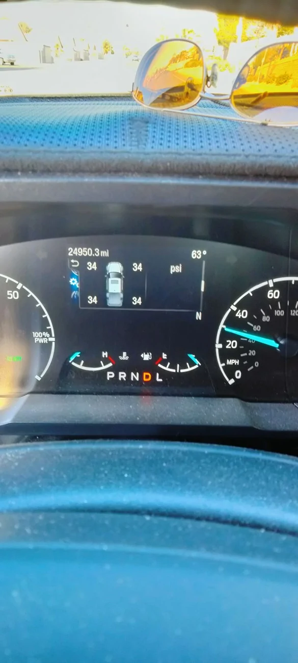

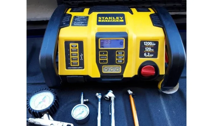

I have found when I air up with my Stanley compressor/ jumper, the readings to be most accurate. As you can see in one of the pictures I have filled all my tires to exactly 34 which is what I set my Stanley on when I filled them knowing that with the heat here in the desert the tires warm up quickly.
Ford Maverick TMPS Disconnecting 20250814_091312
*I've tried hand gauges☝ I have better success getting accurate readings, on cold tires using my compressor. I set the compressor at 34psi. it stops at 34psi and my truck indicates 34psi. Good enough for me.
