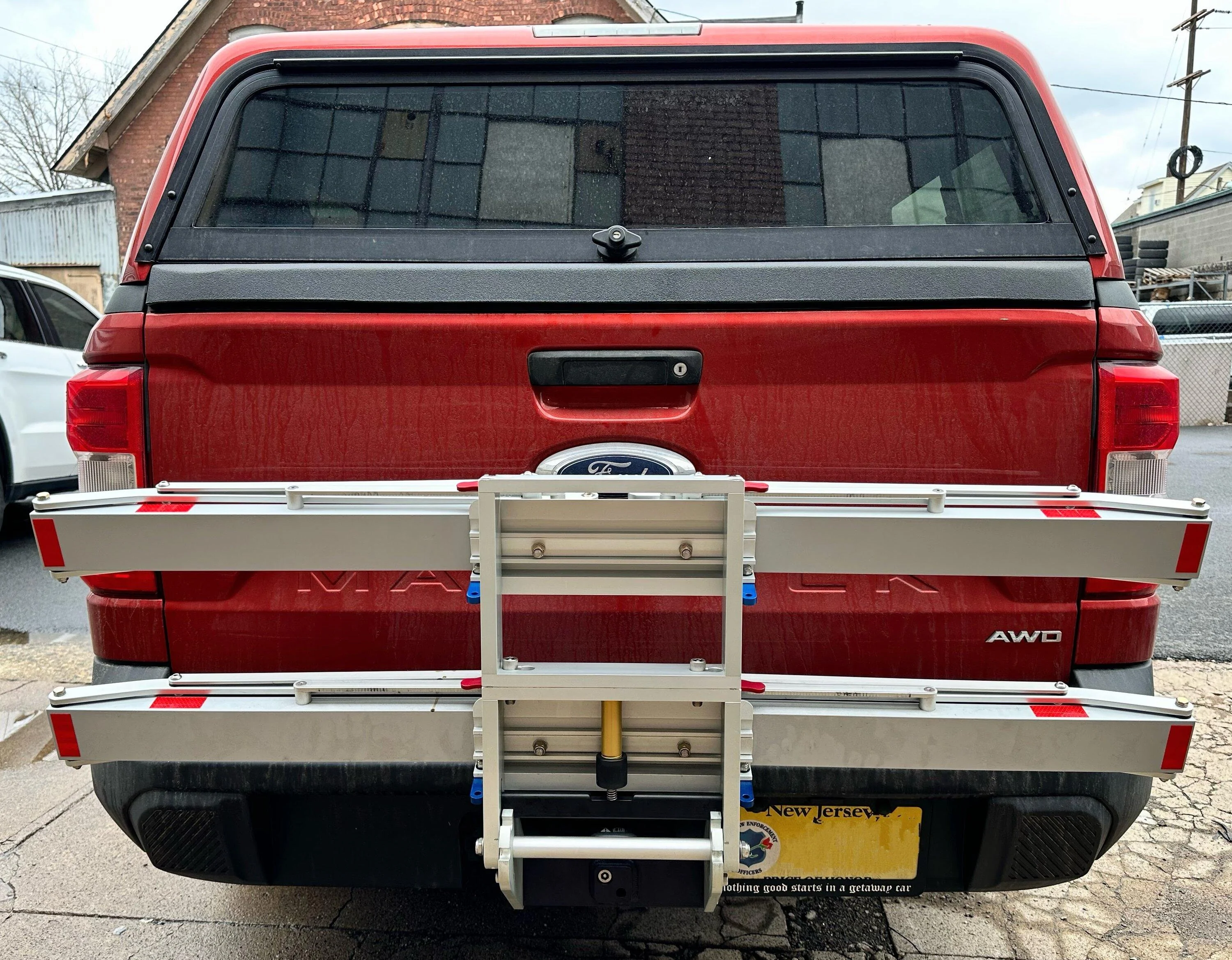

Today I added another bike rack to my 1UP rack. Now I can carry two bikes with ease. Folds up behind the Mav great and when it's folded all the way down I can still open the tailgate all the way. Can't wait for warmer weather and bike season.

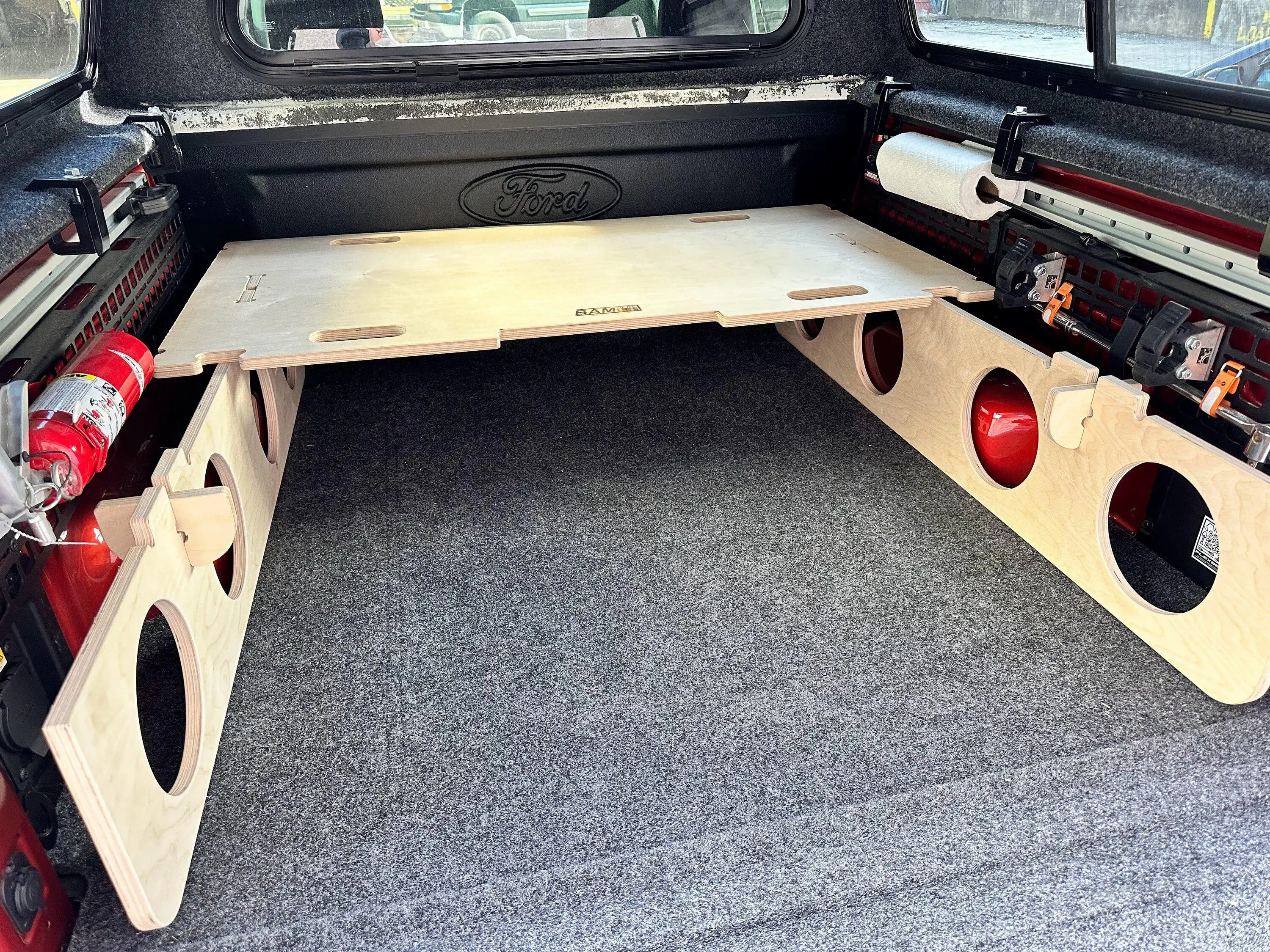

Last week I spoke with Ben, the founder of BamBeds. He informed me that it not fit with my molle side panels. I decided to give it a shot and cut the sides if needed. I cut two inches off each side and they fit! I am going to sand down the edges and add some stick on carpet. It will be nice to have two levels of storage.
My other thought was if I wanted to hide something from plain sight I could have it underneath so no one could see. I will be relocating my fire extinguisher and quick fist mounts. More pictures to follow.

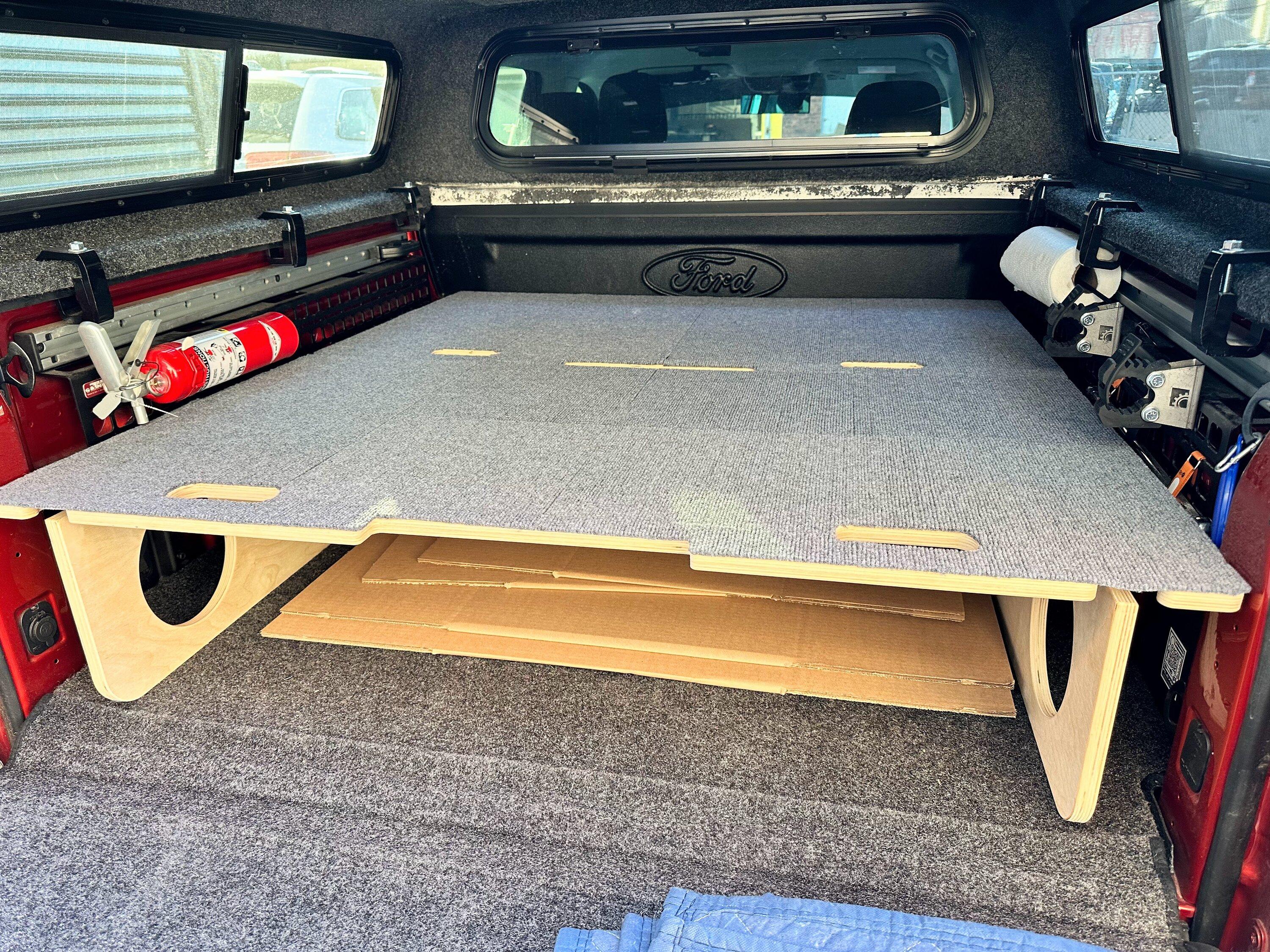

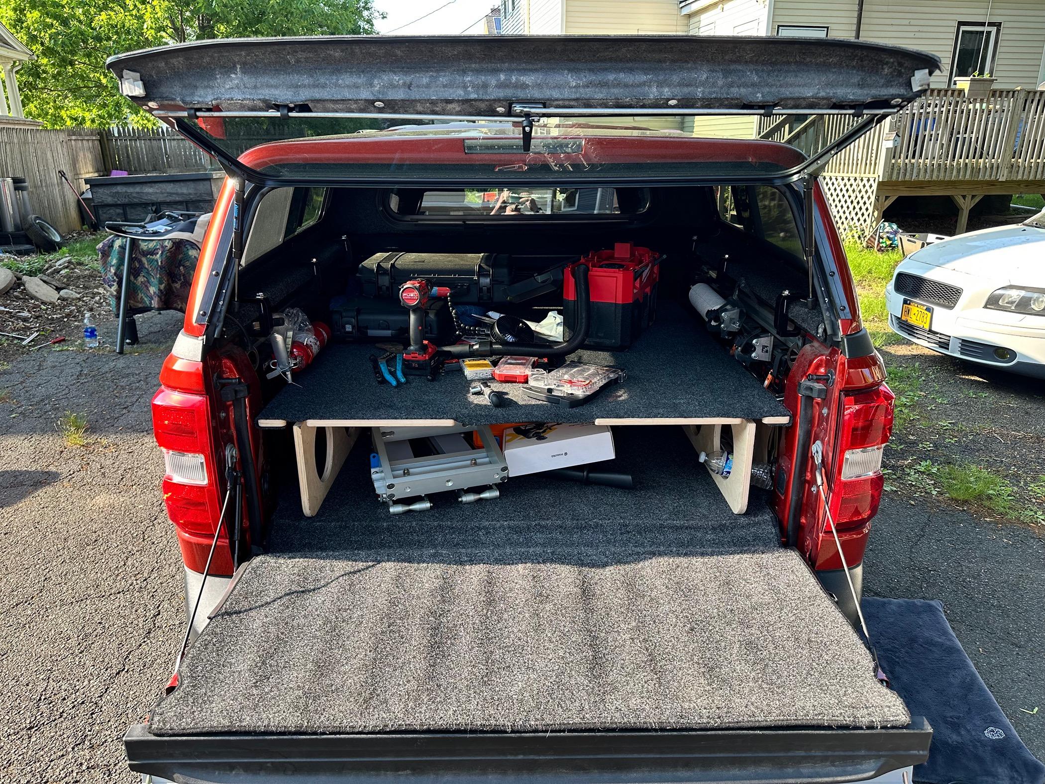

Last week I cut two inches off each side on the BamBed. After that it fits with my molle panels great. I added some stick on carpet too. I need to figure out the extinguisher mount and the quick fist mounts. I really like how useable it's becoming. Super quick to remove also.

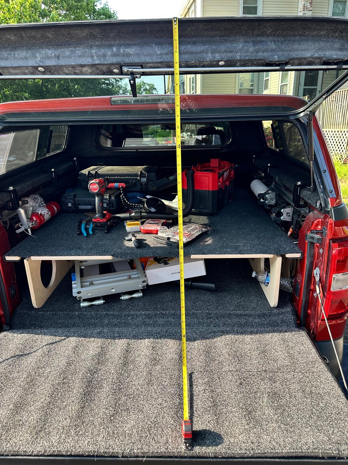

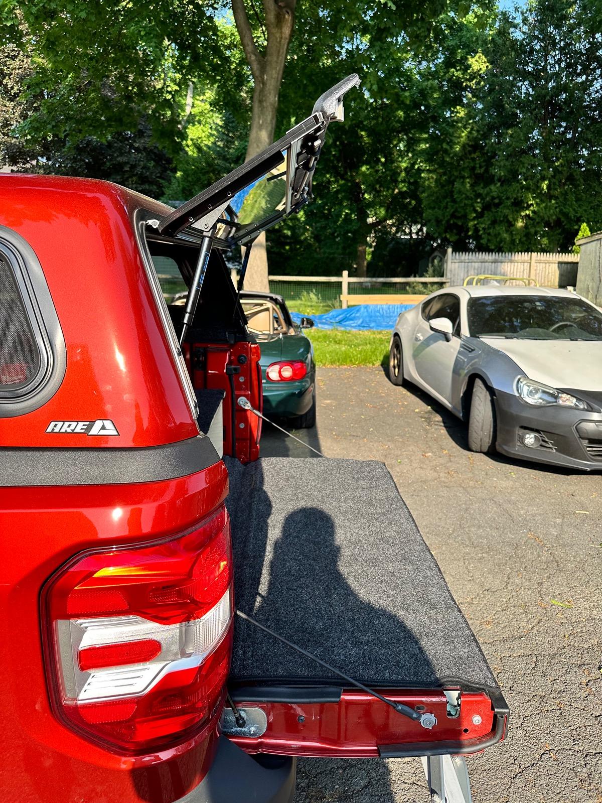

Today some friends and I installed new gas struts for my truck cap window. I wanted the window to open more so I ordered 11 inch struts.
We had the drill out the old rivets and drill one new hole to move the lower mounting point down about an inch. We reused the original lower hole, it’s now the upper hole. Super simple to do and now the window opens much higher.
The struts I ordered were 30LB compared to the 24LB the cap came with. It takes too much force to close the window now so I ordered some 22LB struts. Going to try those tomorrow.

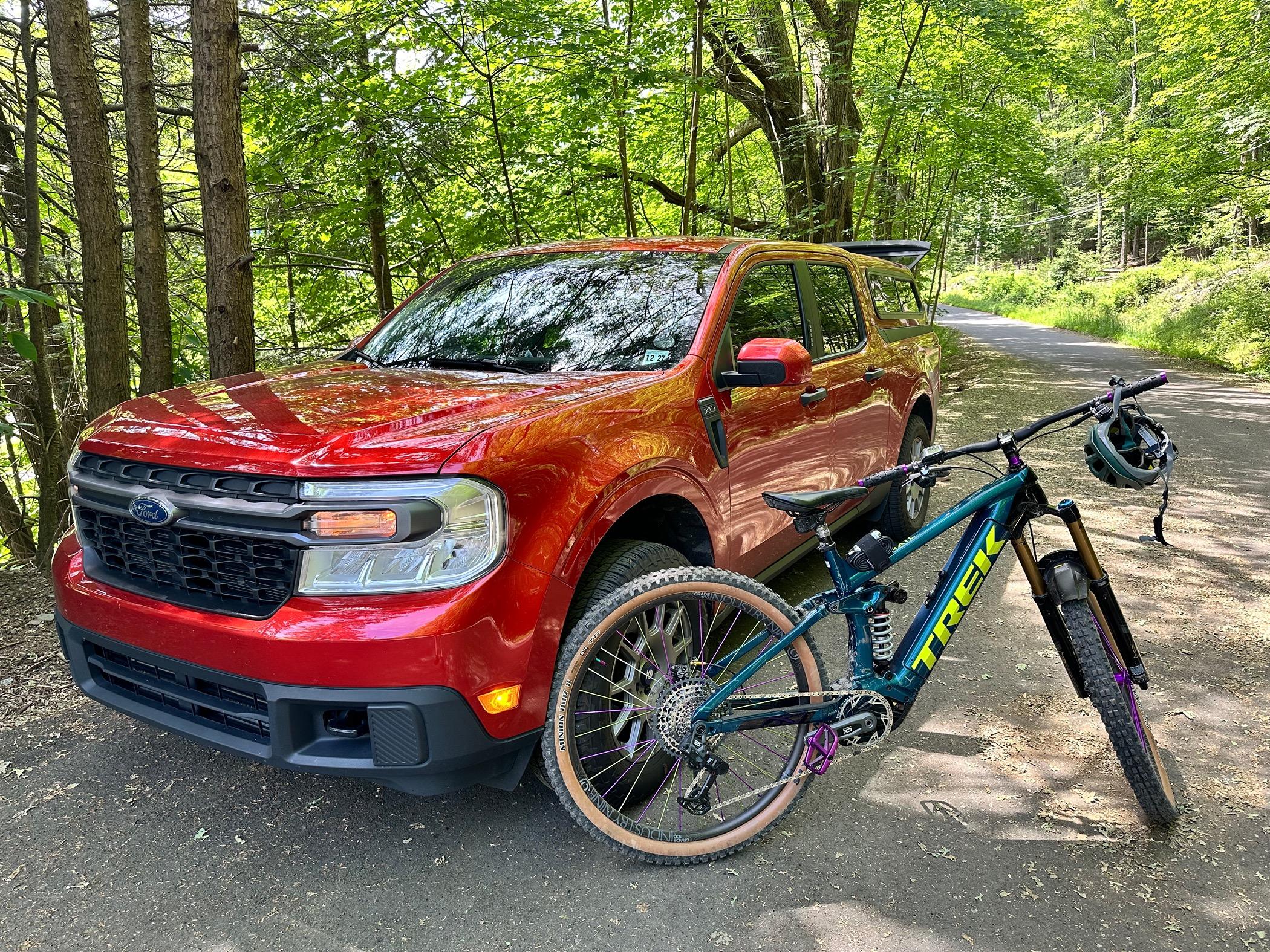

The Mav is a perfect bike hauler.

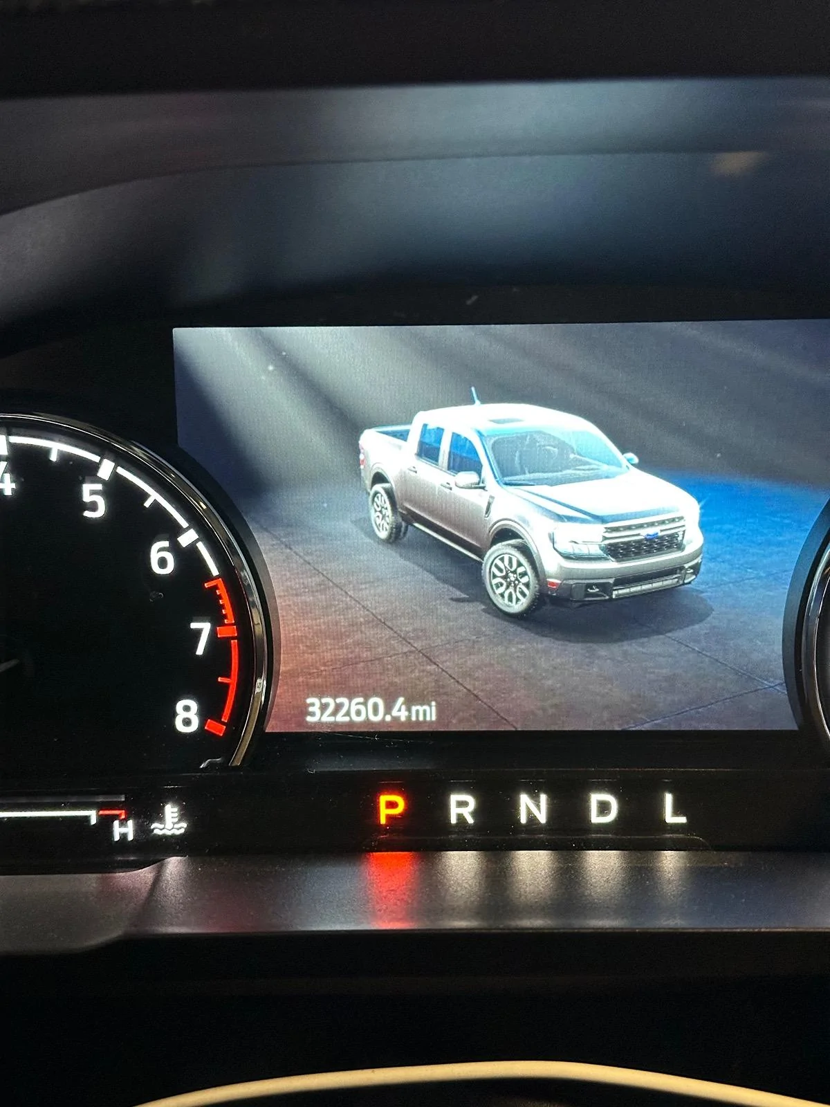

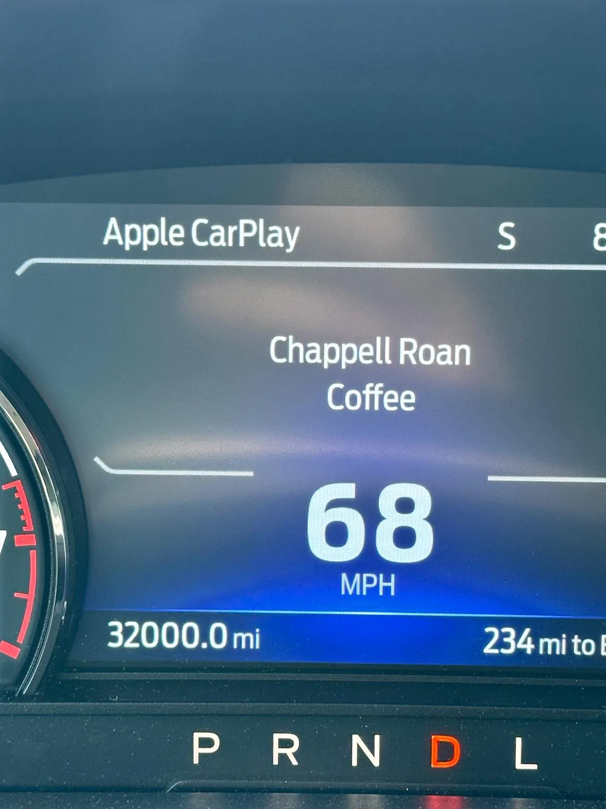

Bike pic and mileage update. Hit 32,000 miles today. Almost due for an oil change.

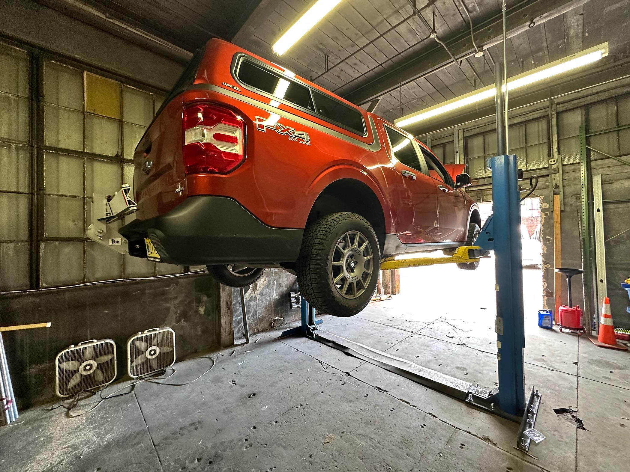

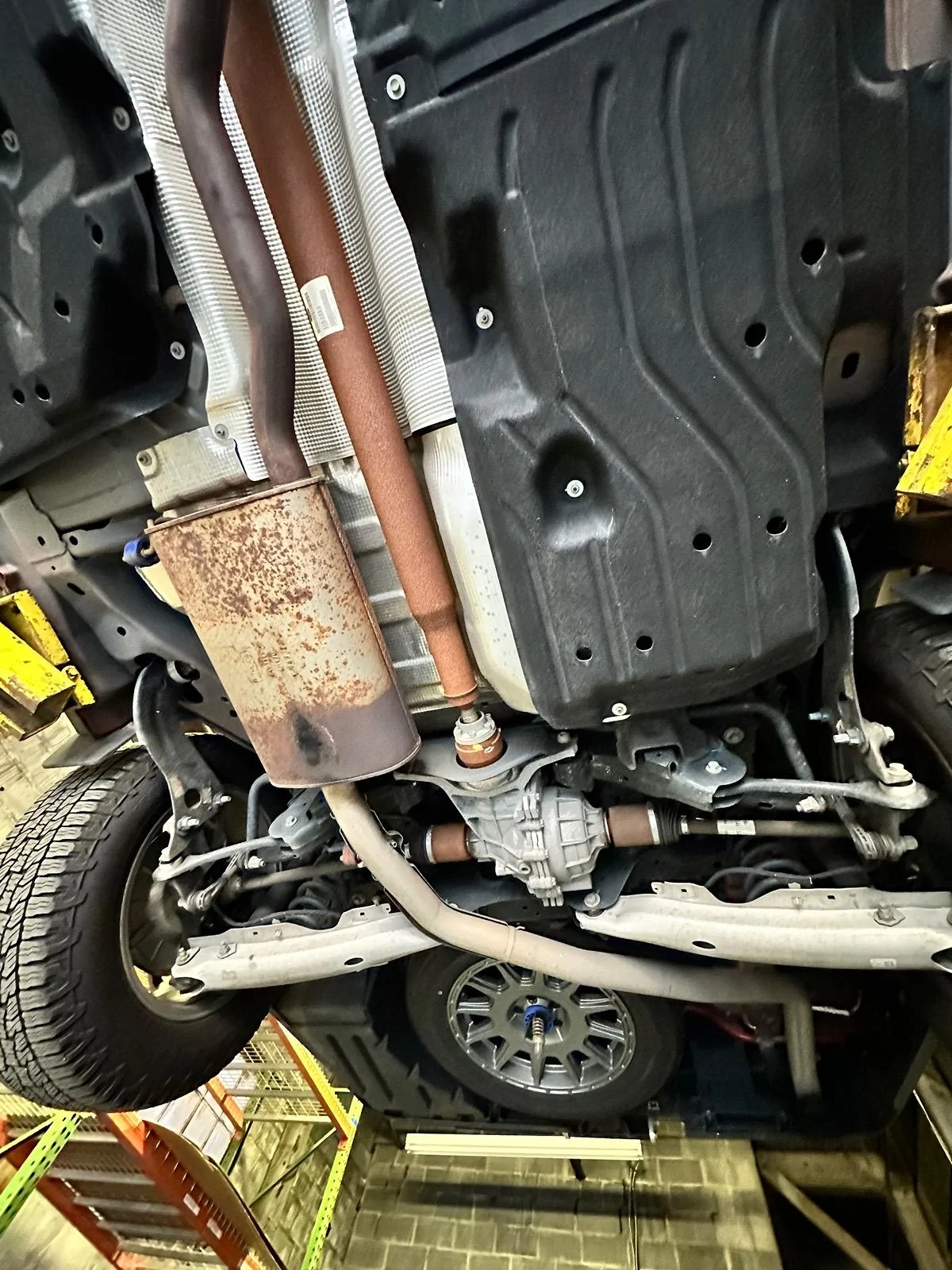

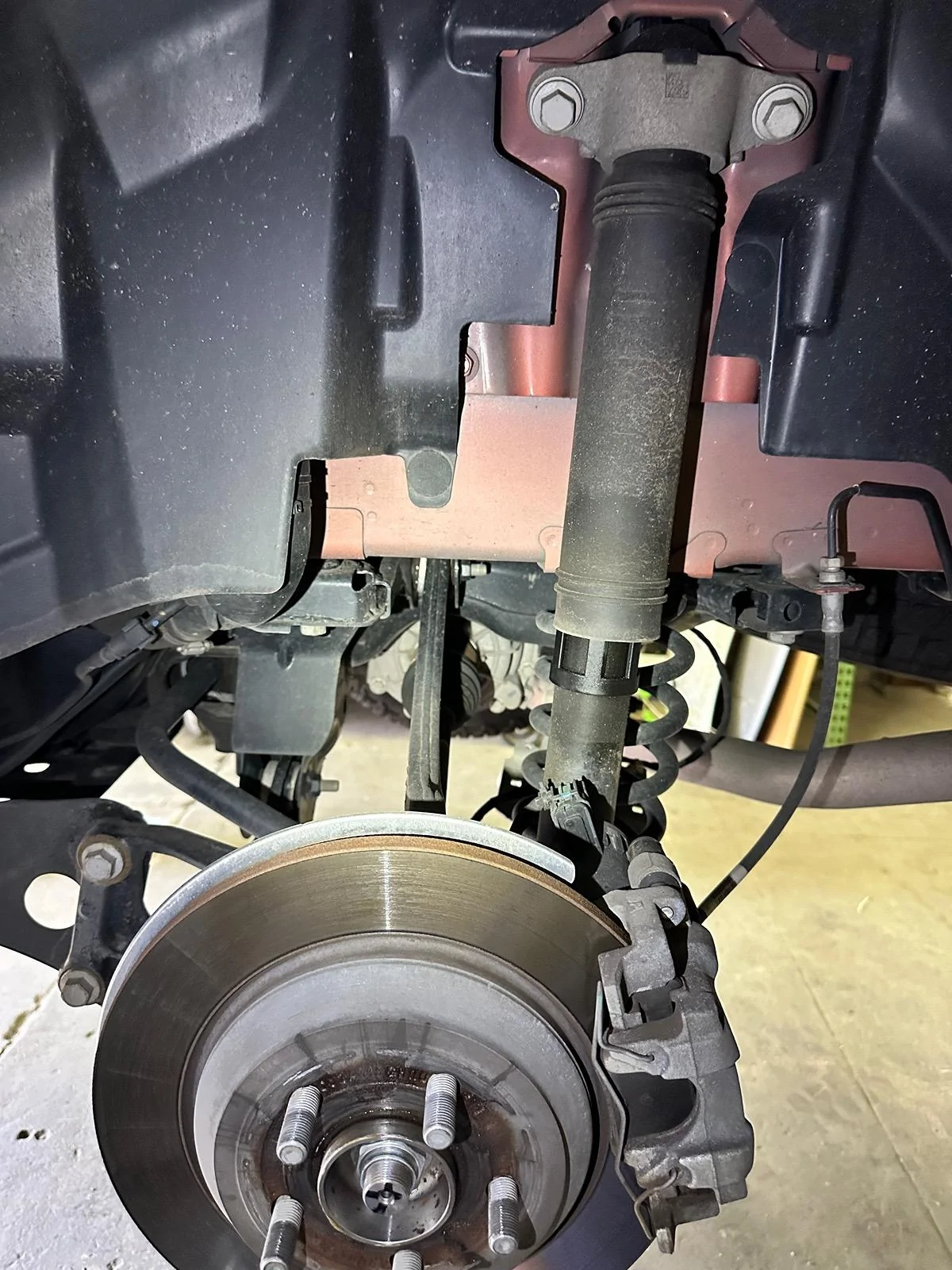

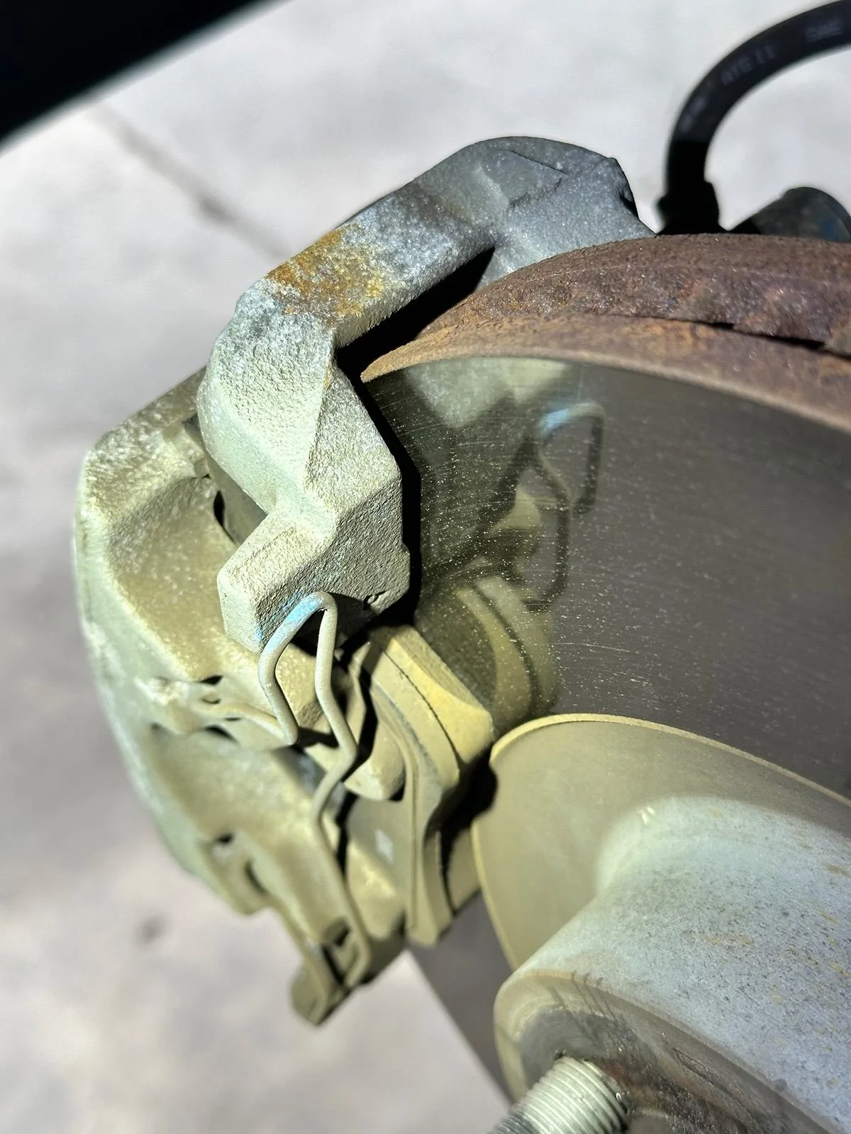

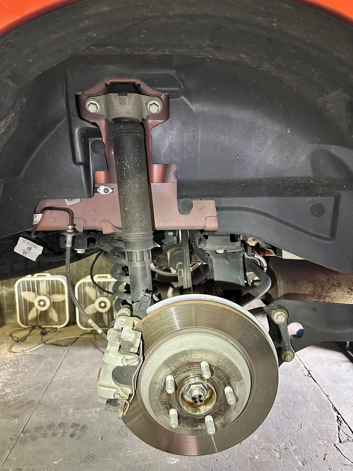

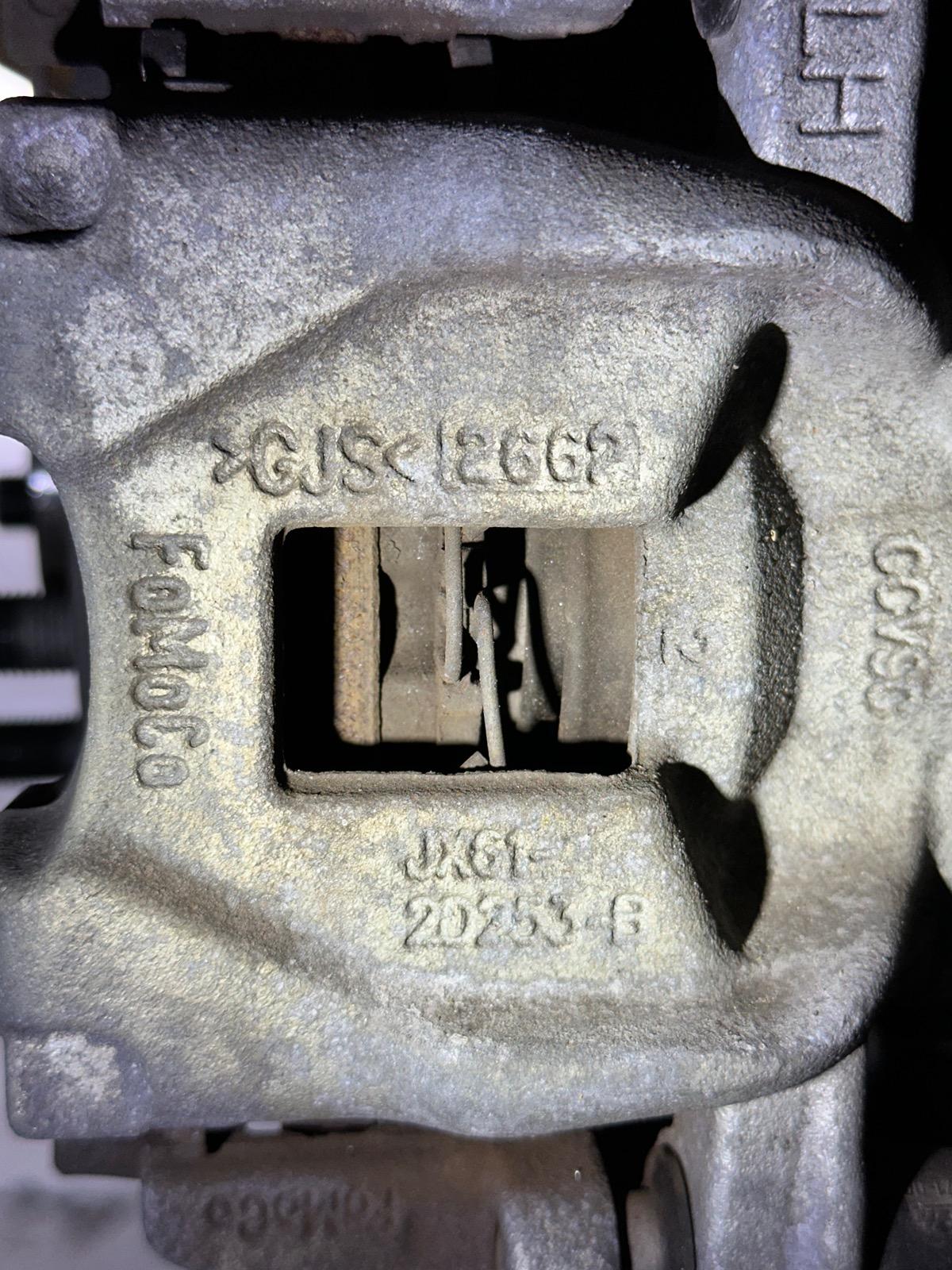

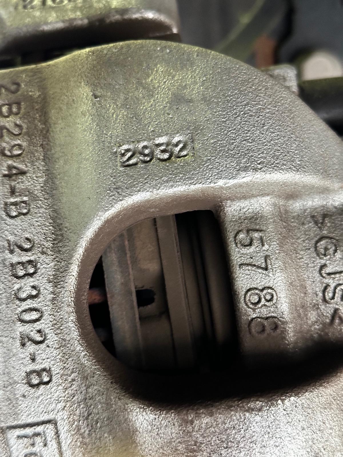

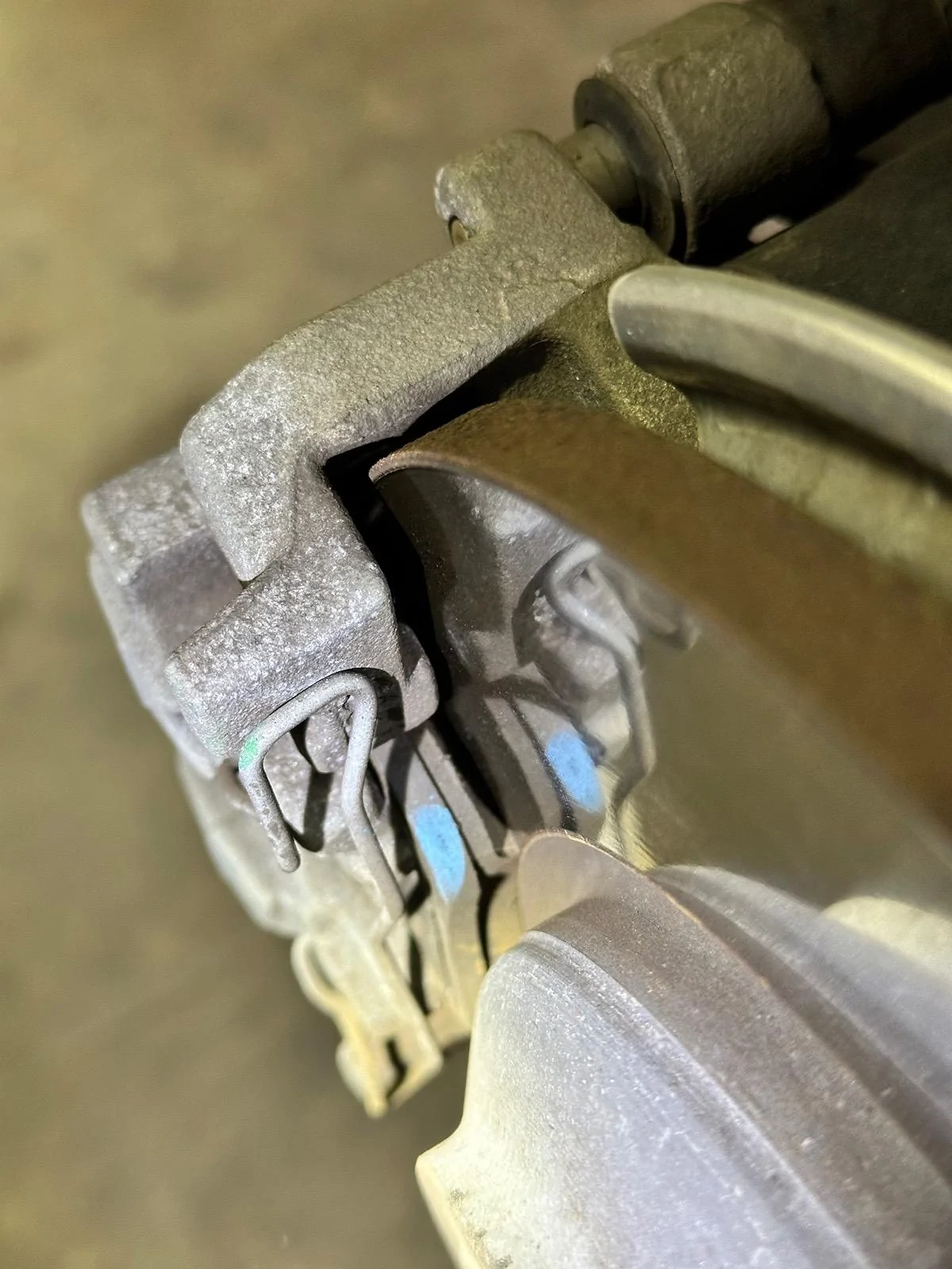

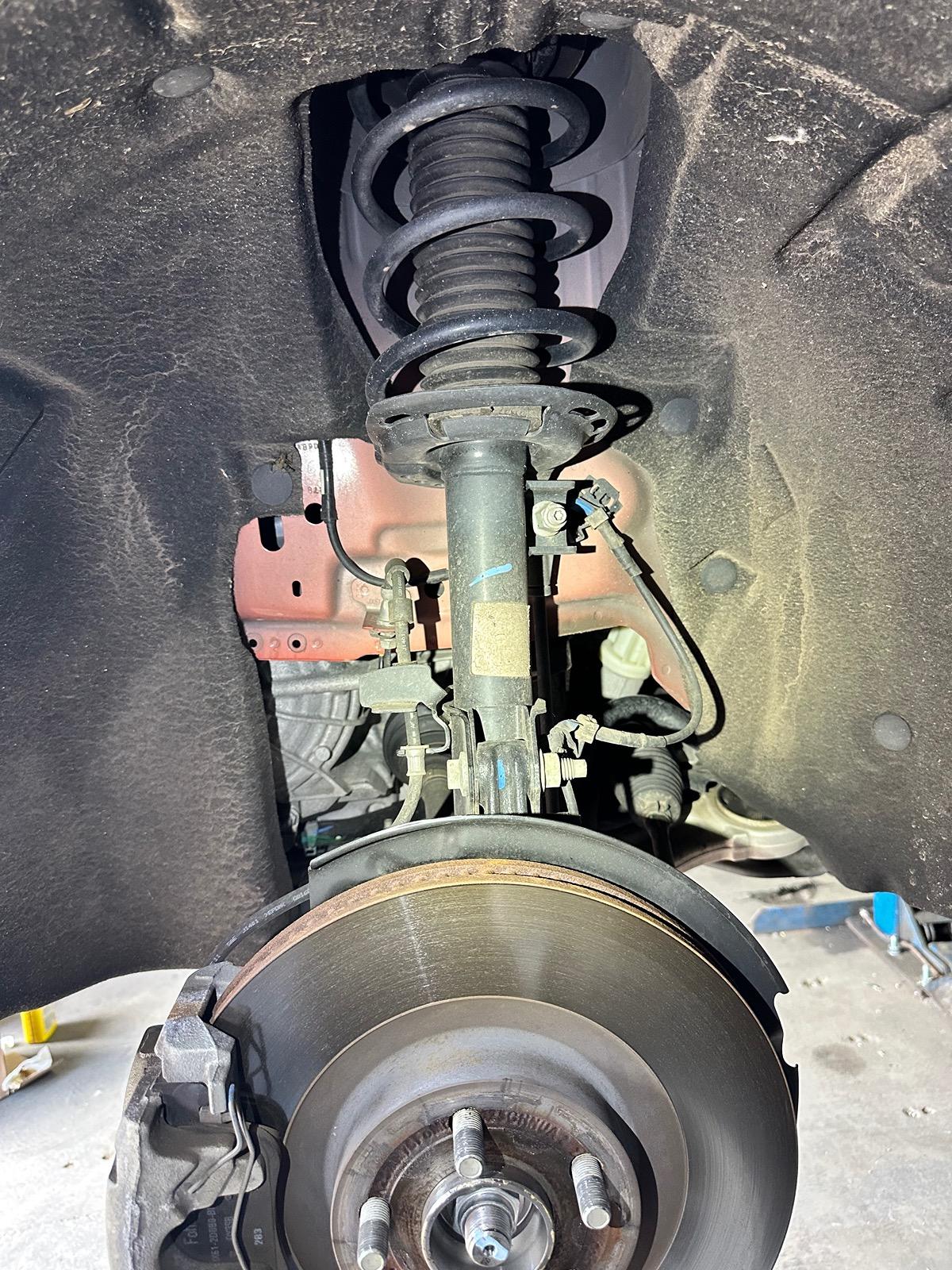

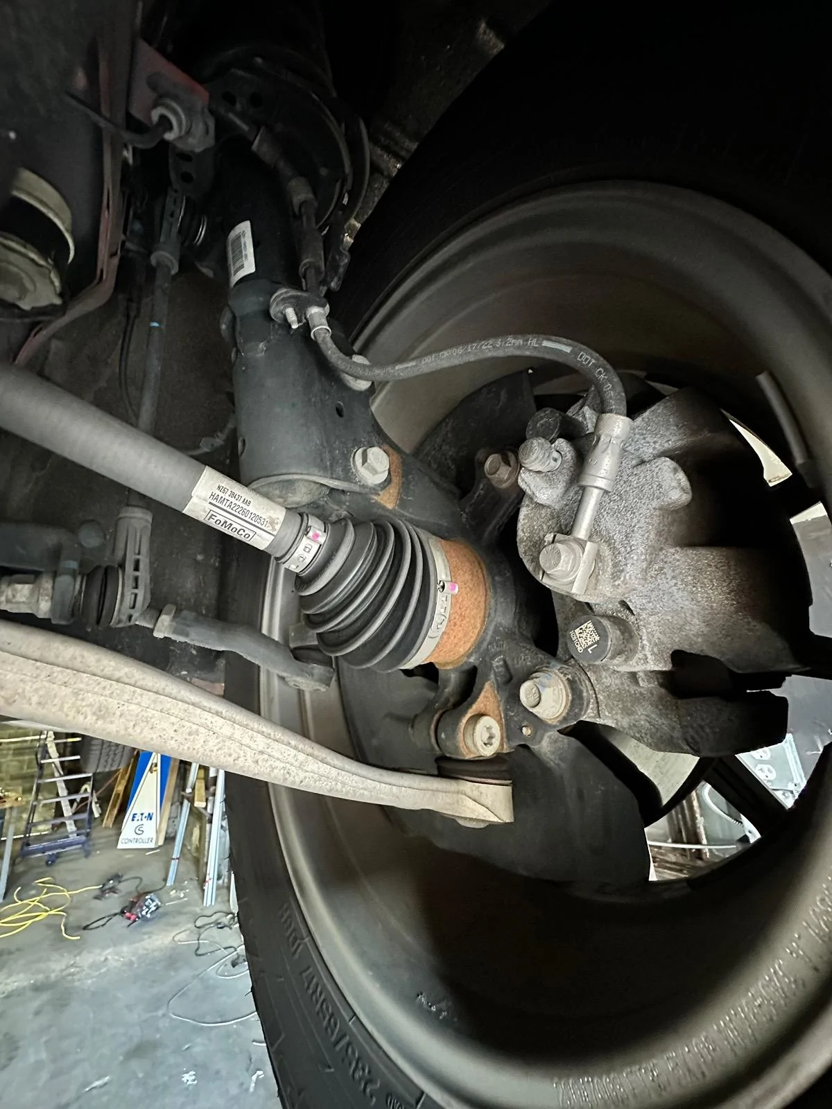

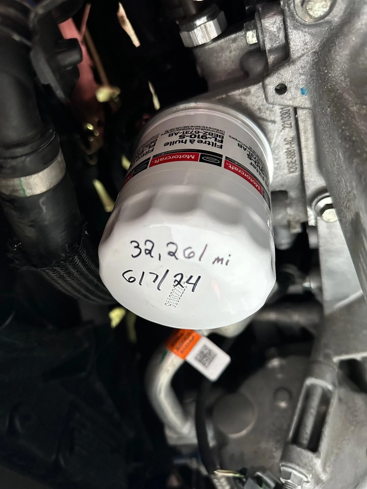

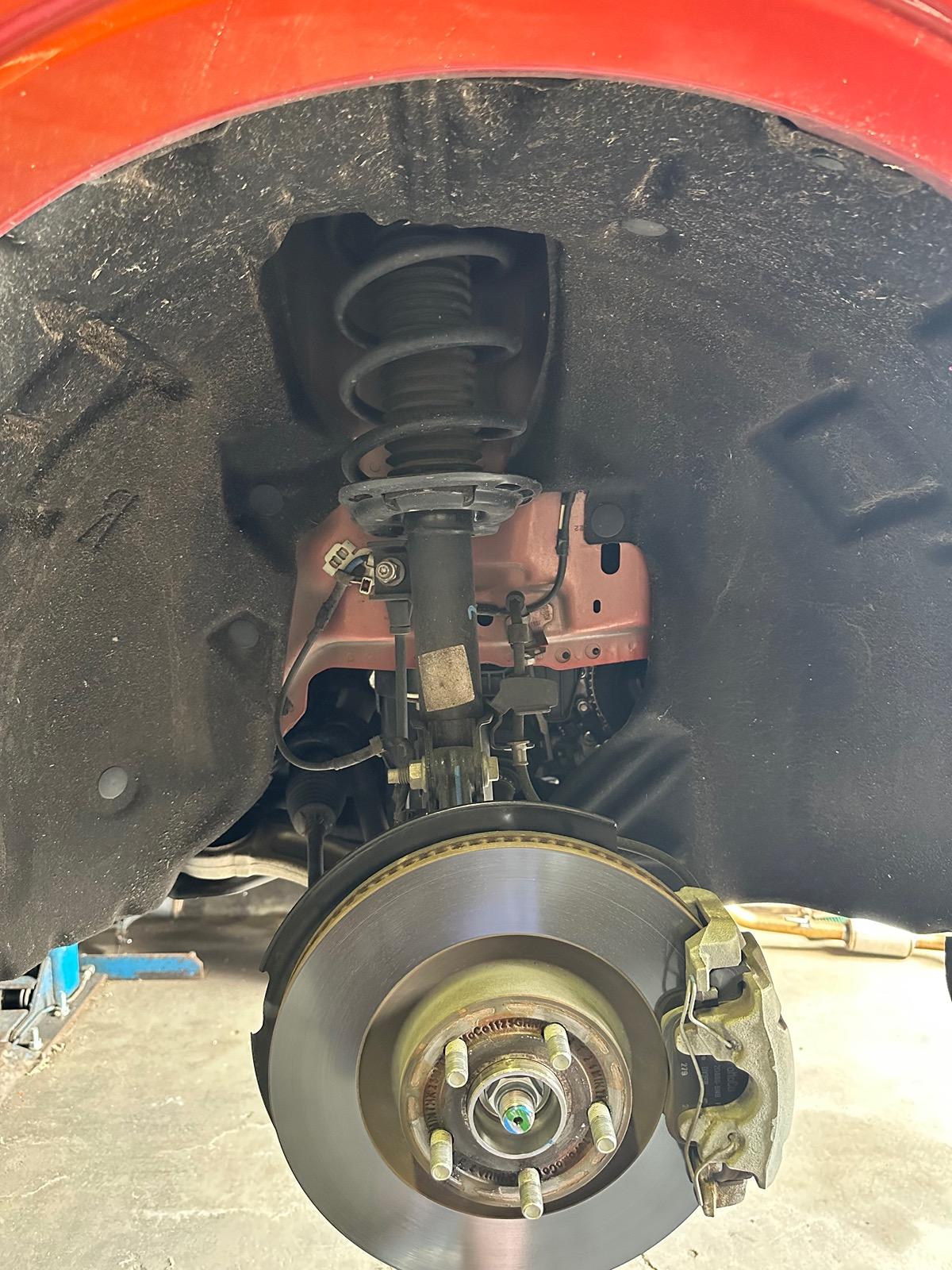

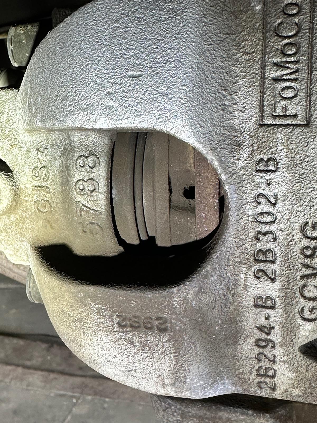

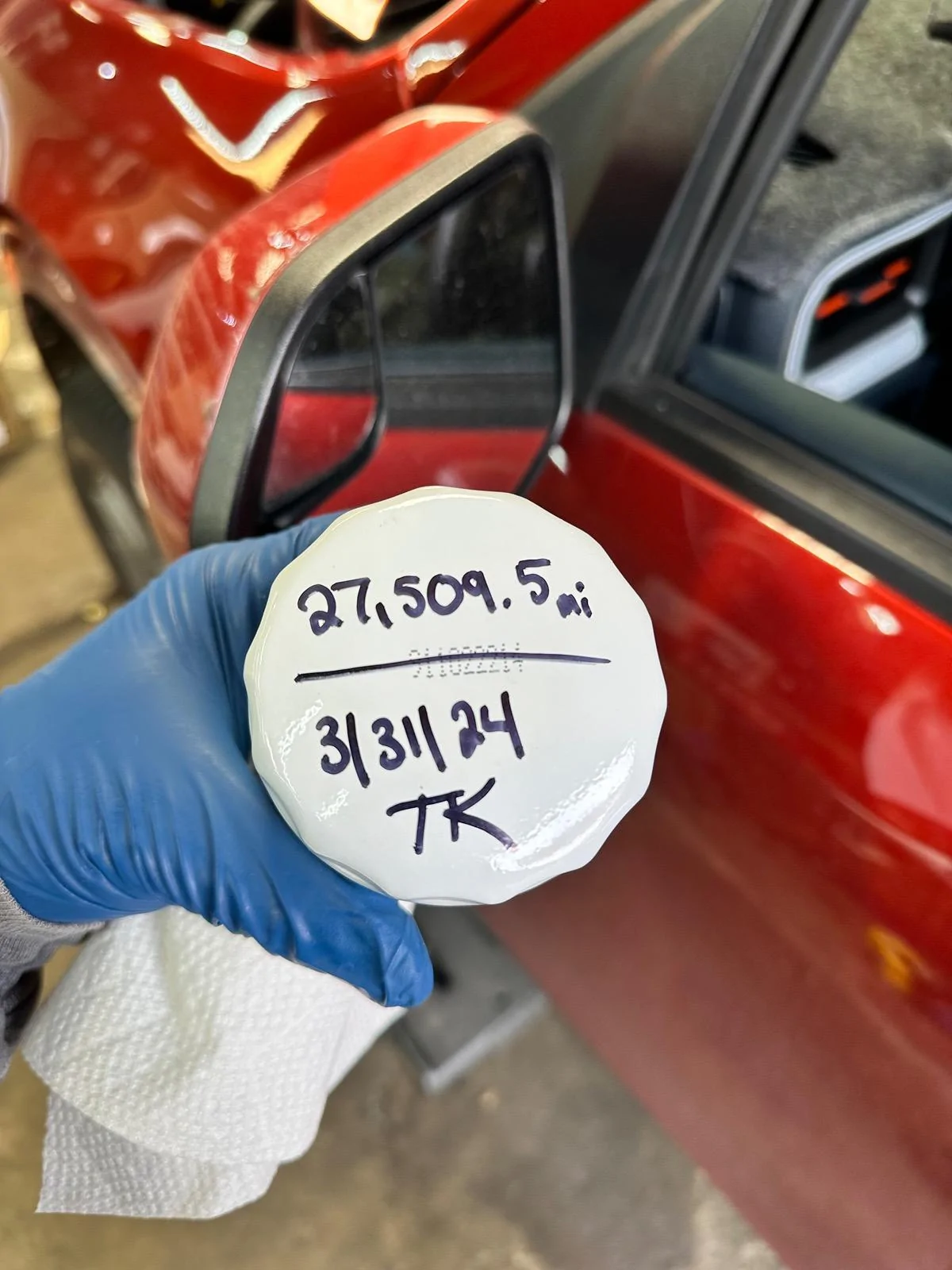

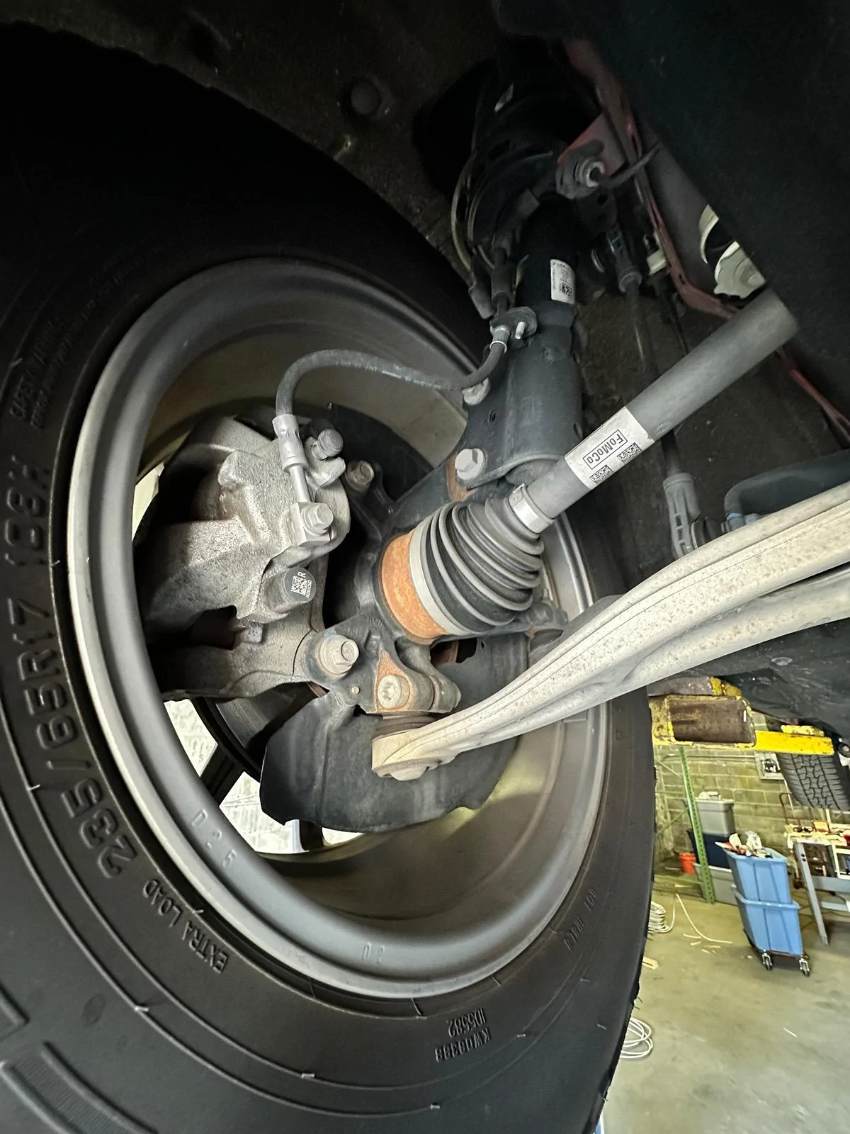

Today I did an oil change and tire rotation. First time having the Maverick on the lift. The lift makes the oil change and rotate a breeze.
