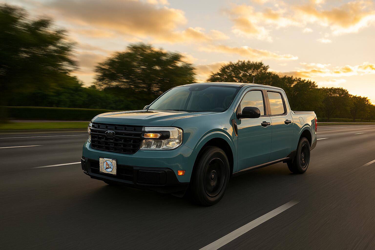

Any tips for lifting and adding big tires? I mainly just want to level it but am not sure what to pick for a hybrid?
only have tint so far.

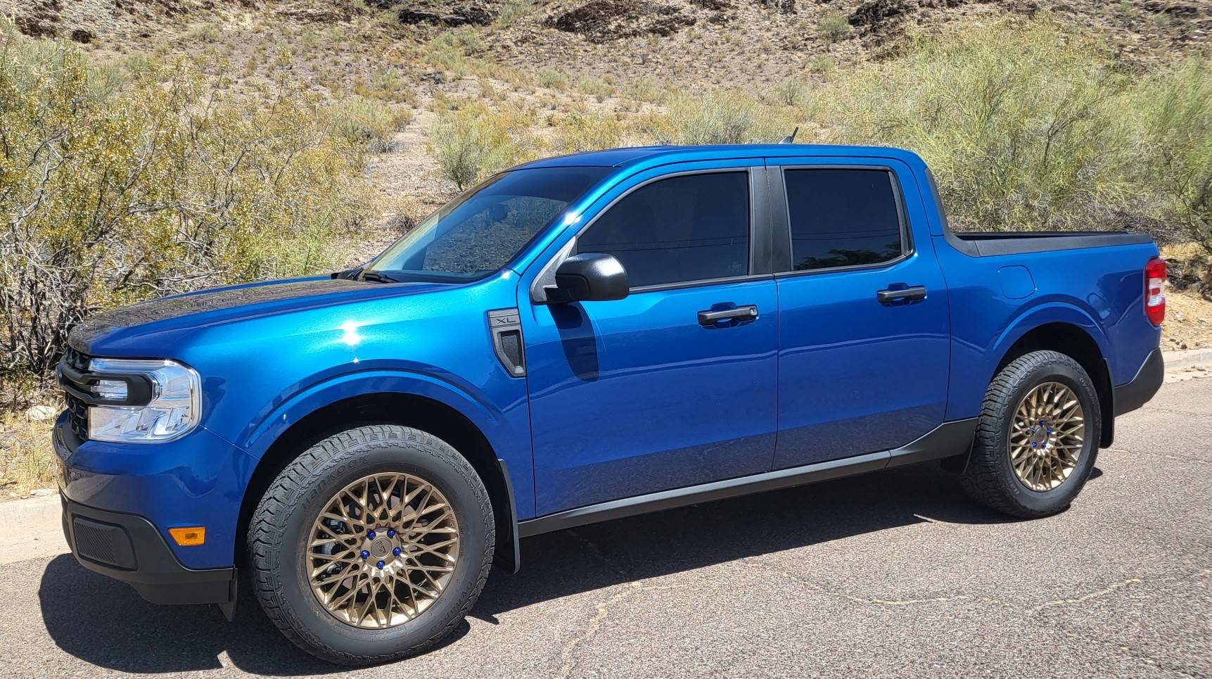

The top photo is a 1" rough country leveling kit. It will fit any Maverick (hybrid or EB, AWD or 2wd). I bought it just incase I needed it on my 23 AWD (2nd Photo) I put 265/60/18 on stock suspension with no rubbing. I drove it for 6 months like that, then put the steelies back on and traded it in on my Cyber Orange Hybrid. The level kit (un-used) and the Bronze wheels and tires are available in Phoenix area. Now I am super happy with my Hybrid with 235/60/18 on Mach-E wheels.
