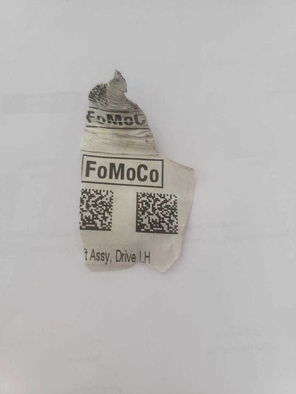

We were on a 650 mile trip and started to hear a ticking noise from the driver's side. It sounded like it was coming from under the dash or engine compartment. Oddly we found it only made the noise once we got up to 56 mph. It didn't matter if it was was running on ICE or EV, so I didn't think it was the engine. When we got back home I looked under the truck. Everything seemed fine.
Ford Maverick Ticking noise from driver's side above 56 mph 20240917_104636
This is what was making all the noise!
A tag on the axel started to peel off and was slapping the stabilizer link.

Hi, where exactly you found this tag, just curious?
Thanks
roc129
Aug 20, 2021
70
Woodstock, GA
97 Mazada B2300
Front axel driver's side

is this a problem on the 2024 model i have the 2.0 eco boost is that tag still there bc its making a ticking noise that coincidentally sounds like a sticker coming off and smacking something how do i get it off
