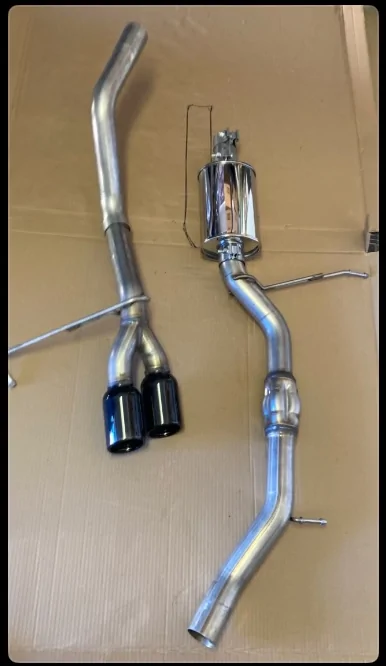

I recently put on the 3" Thermal exhaust on my 2025 Lobo.
Very loud.
I want to change out the muffler.
Any recommendations?
Thank you.

Why get a thermal exhaust if you didn't want the noise? What brand did you get? Most videos i've seen they sound great.

Too loud for you while driving, or too loud for your neighbors?
If it's loud for you driving, you can try an add-on tailpipe, sometimes the pressure waves are hitting back on bodywork and make it louder inside than it should be. Get the exit a little further away from bumper and it might reduce it.

What does Thermal say?
Post a video?
Wasn't being loud the point?
