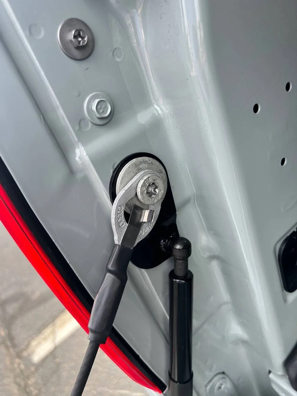

Does anyone have the part number for the bolt that the tailgate cable attaches to? I butchered mine during tailgate assist install… I can’t tighten it anymore, it’s fine now but if I ever have to remove it I probably couldn’t get it tight again.
W714928-s439
Runabout
Gary
Aug 5, 2024
30 miles west of Philly
2002 Tacoma
Uncanny timing. Just came in from installing same.
That bolt was TIGHT! Thought I was gonna strip the torx socket. Didn’t have an impact wrench on hand. It finally broke free without damage.

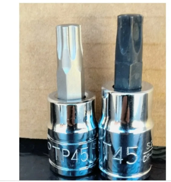

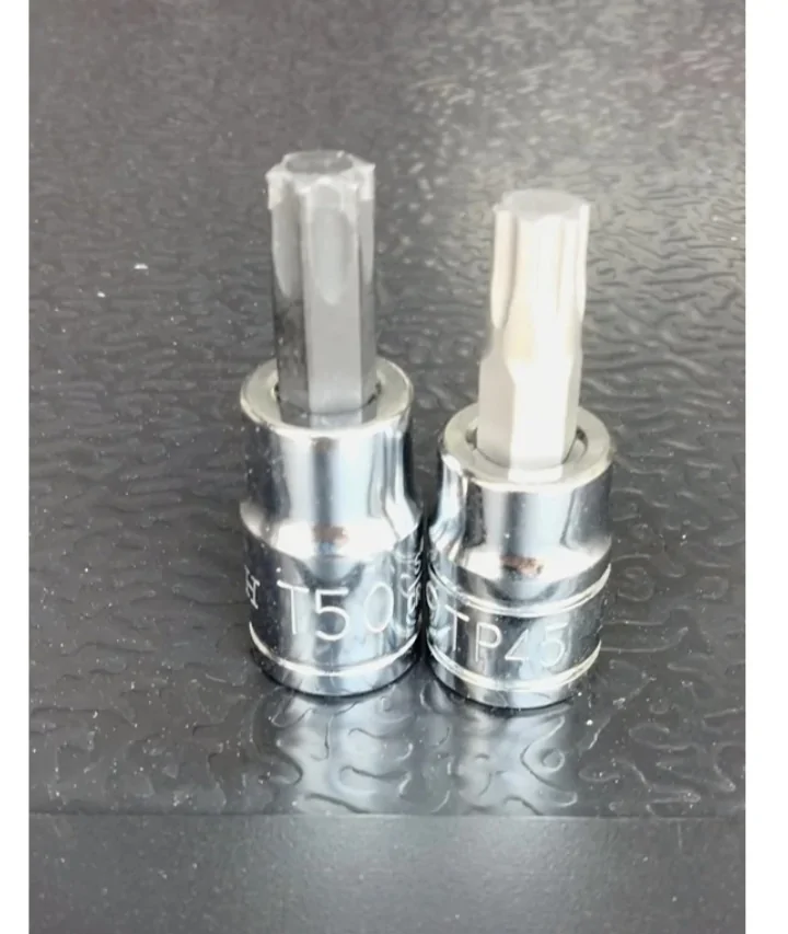

What size tory bit did you use?
Glen Baker LLC
May 29, 2024
8,791
16,017
Central Nevada & Utah
Maverick XLT Hybrid
Mike,
For the tailgate latch/cable bolt
part #W714928-s439
The proper size is Torx Plus 45
The lobs on a Torx PLUS are thicker and offer a better grip.
Ford Maverick Tailgate Cable Bolt Part Number needed 20260401_065203
Ford Maverick Tailgate Cable Bolt Part Number needed 20260401_063042
A regular ☝Torx 50 may work but you may end up stripping the bolt and screwing up the bit itself.
As the OP and I did 😬
