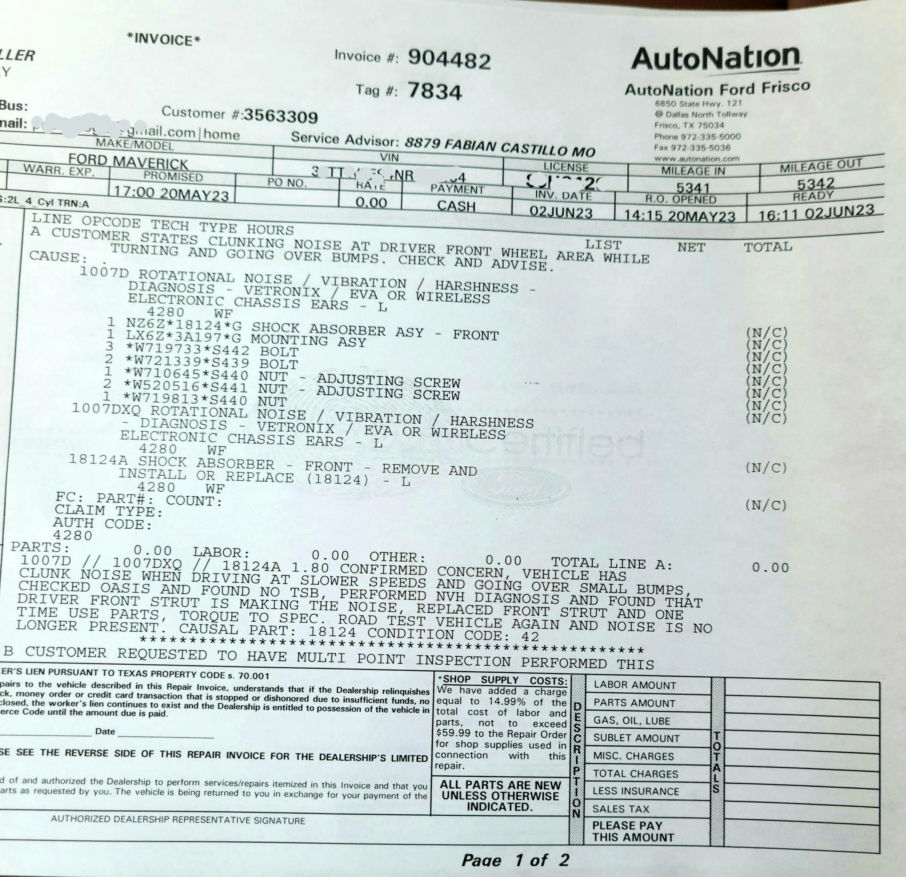

I had something similar going on with my old Fiesta. Loud knock when temps went below 20. The colder it was the louder it got. Sounded like the struts were gonna come thru the hood . It was the material Ford used for the bushings on the drop links. When cold the nylon bushings would shrink causing the noise. The only fix is to buy some after market Moog drop links with grease fittings. Your dealer will just replace the links with poorly engineered new parts to get you thru the warranty period. After that your paying the bill anyway and Ford wont redesign the part. They just keep replacing bad parts with more bad parts.Ok, I think I may have solved my own mystery, thankfully before embarrassing myself at the mechanic (just in front of you all); but maybe I can serve as a cautionary tale. The clunk had gotten so bad so quickly that when I got to work, I pulled out the cheap aftermarket floor mat I had on the drivers side (My Maverick shipped without the floormats and I'm still waiting on them to come in) to see if there was any evidence of what was hitting under my feet. I couldn't see anything there or in the wheel well that could be causing the noise/sensation. I put the mat back and went in to work. I had no idea what it could be (CV joint?) but made an appointment to get it checked.
However, driving home that evening - the noise had completely vanished - nothing - as right as rain. Must be cold related I thought. This morning was cold - this would do it. Still nothing. Still perfect. WTF? Got to work and this time took a GOOD look up under the driver side foot well. Where the steering column meets the floor, part of the steering mechanism is exposed and there is a linkage there with a large, exposed bolthead that when you turn the wheel, spins around and around. And if you get a cheap plastic floormat jammed up against it - that bolthead will catch the edge of the mat and go "clunk" when you turn the wheel enough. Forehead slap. Now to cancel that appointment....
