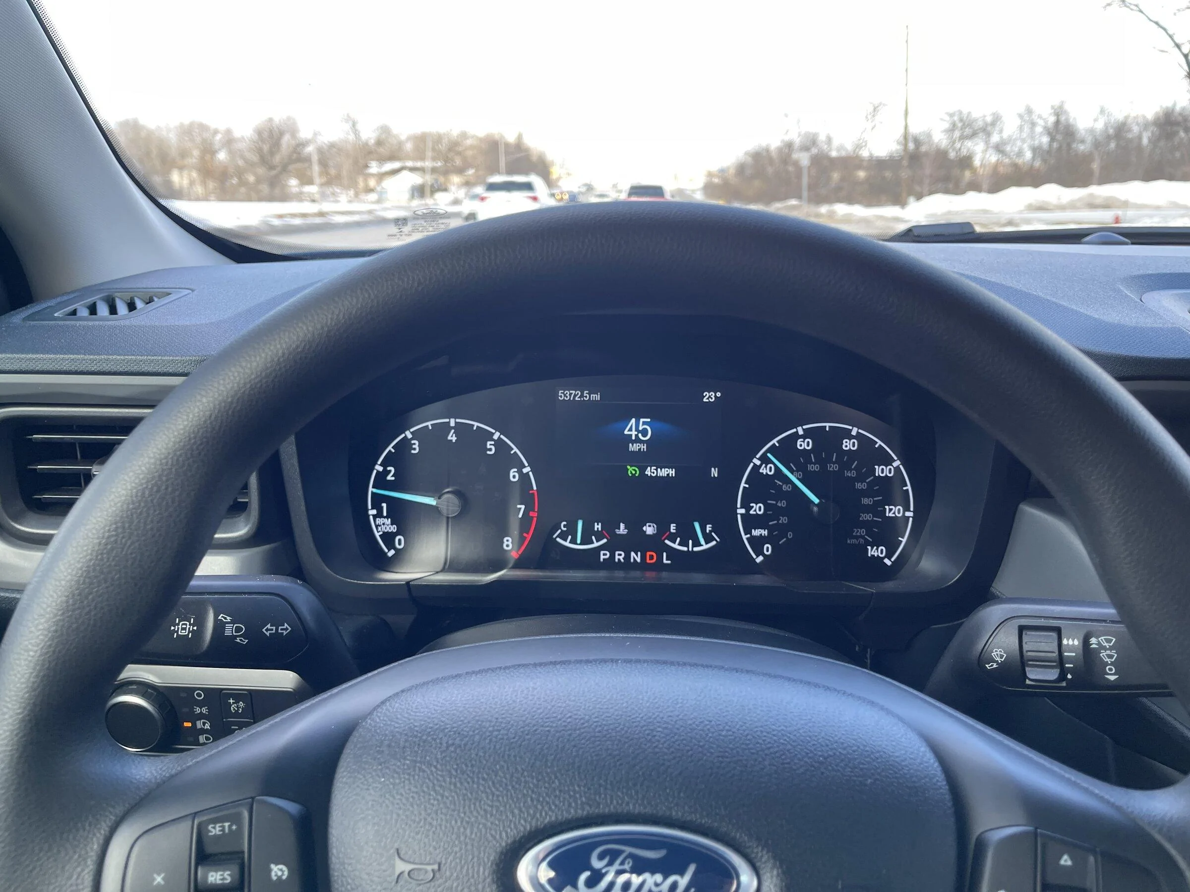

That's what I was wondering given the other thread on "runaway cruise", and thought it did show the set speed like it does on yours next to the green cruise icon. Cool!
It works great! I have had it on the Highway the last few days traveling 150 miles with the cruise on set @ 80 mph. And no problems at all. You can turn it off, turn it up, etc…..
