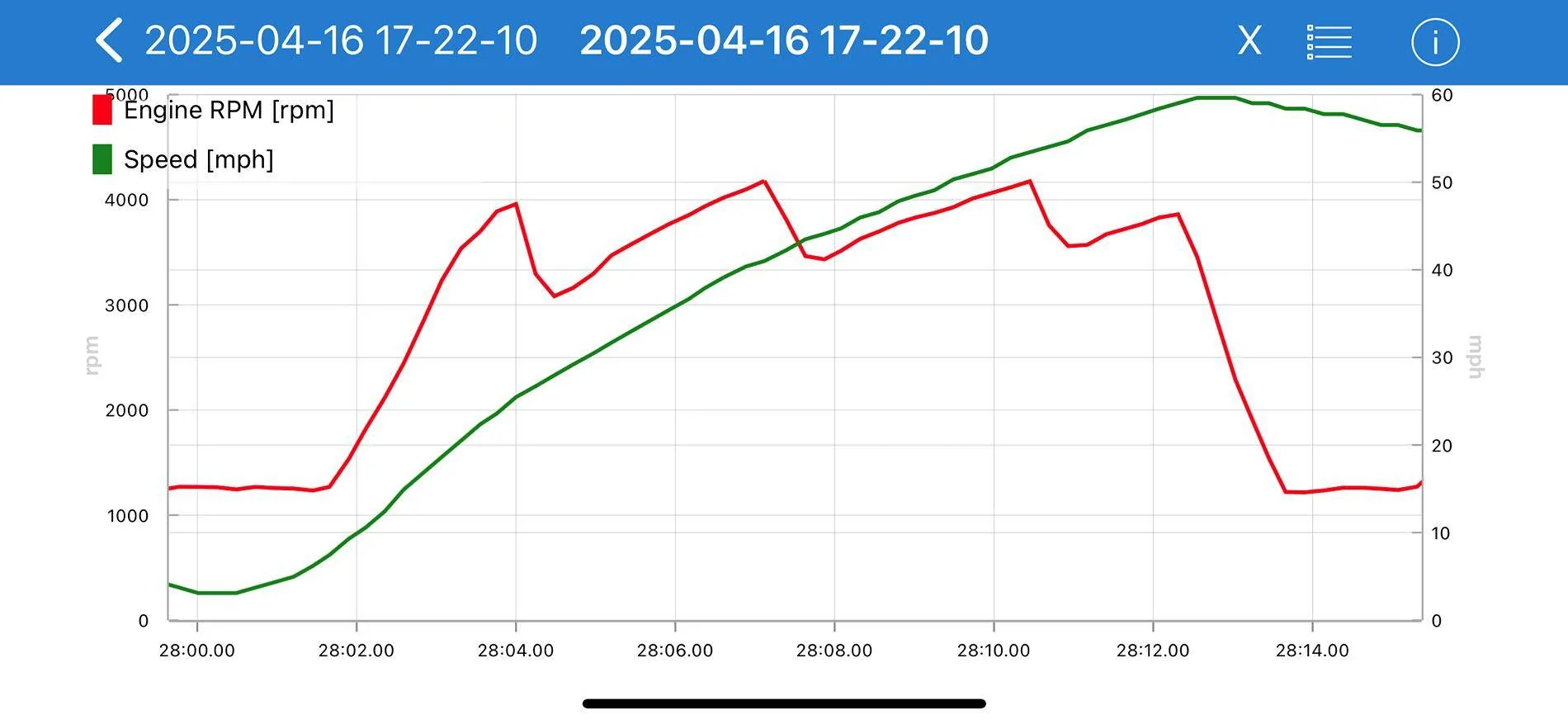

Hello,
I have a 2023 mav hybrid XLT.
I was checking the mode and discovered SPORT mode.
It definitely gives the truck more power, and sounded like it was shifting through gears, but how can this be, there are no clutchs or sliding gears in a ECVT transmission.
I recorded speed and RPM with my scan tool, and it did show where the RPM would go up and drop then go back up.
Here is the picture going from 0 to 60 MPH.
Ford Maverick Sport mode without the dumb faux shifting? IMG_0434

Hello,
Thanks for the graph.
Just like I've been saying for years.
If you want to drag race, put it into haul ass mode.
p.s. haul mode fake shifts with moderate acceleration, but not when you floor it.
