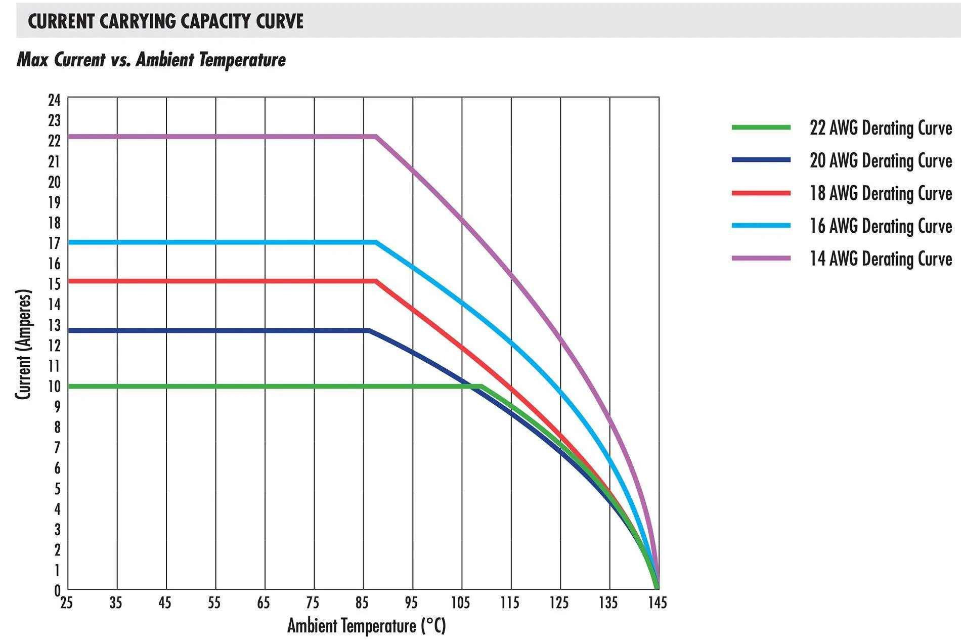

I think it's a 20A fused circuit but uses 16 AWG wiring, which is usually rated for 10-17A (depending on what's used), so it's not ideal to do more than that. Bed lights usually use 1-2A and 12v sockets usually cap at 10A, so it's probably safe to split.

I thought 16 AWG wire supports a max of 13A. It would be strange that 16 AWG wire is protected by a 20 A fuse. Wouldn't the wire have issue's before the fuse would blow ?
This is from the connector supplier, it follows a different recommendation than the AWG (American Wire Gauge standard). You are correct that 16AWG would have an issue at the higher current so it is a strange choice. I recall seeing some literature during the 1st year that said there were two dedicated 10A fuses - not a single 20A - and in that case the wiring is just fine. I'm guessing that they simplified it for cost-savings... which isn't entirely unreasonable. Since most 12V devices/accessories cap at either 10A or 12.5A, it would be rare to see a combined load hover exactly in the 17A-20A range. Since they use a(n annoyingly expensive) fast-blow fuse and 16AWG can have max short current of 22-34A, then no harm would be done in a short situation either.
They basically designed for 99% of people to either use below the current or WAY over (short). In that 1% of cases, then they violated the 180W rating that's specified in the manual and their own fault.
