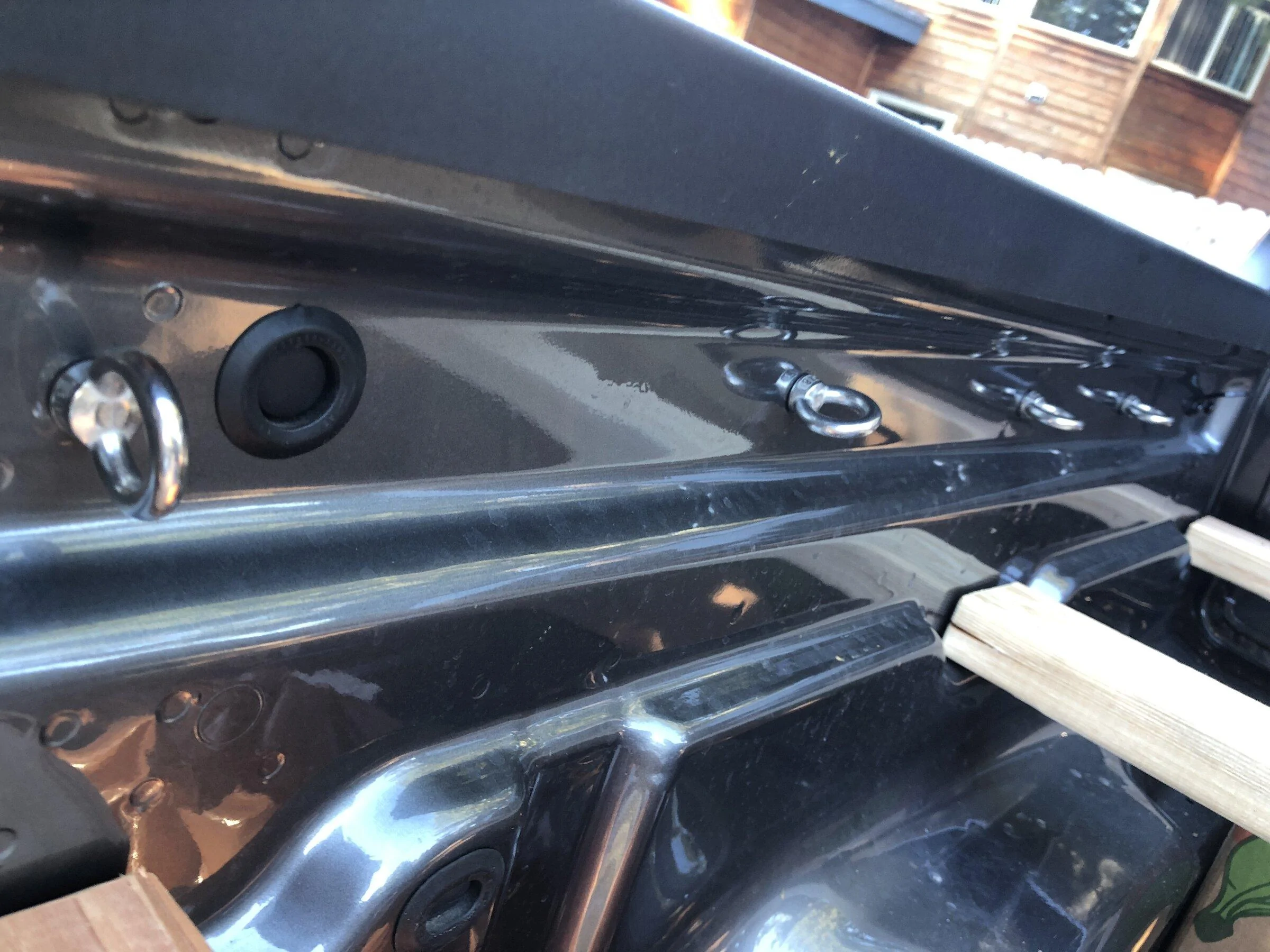

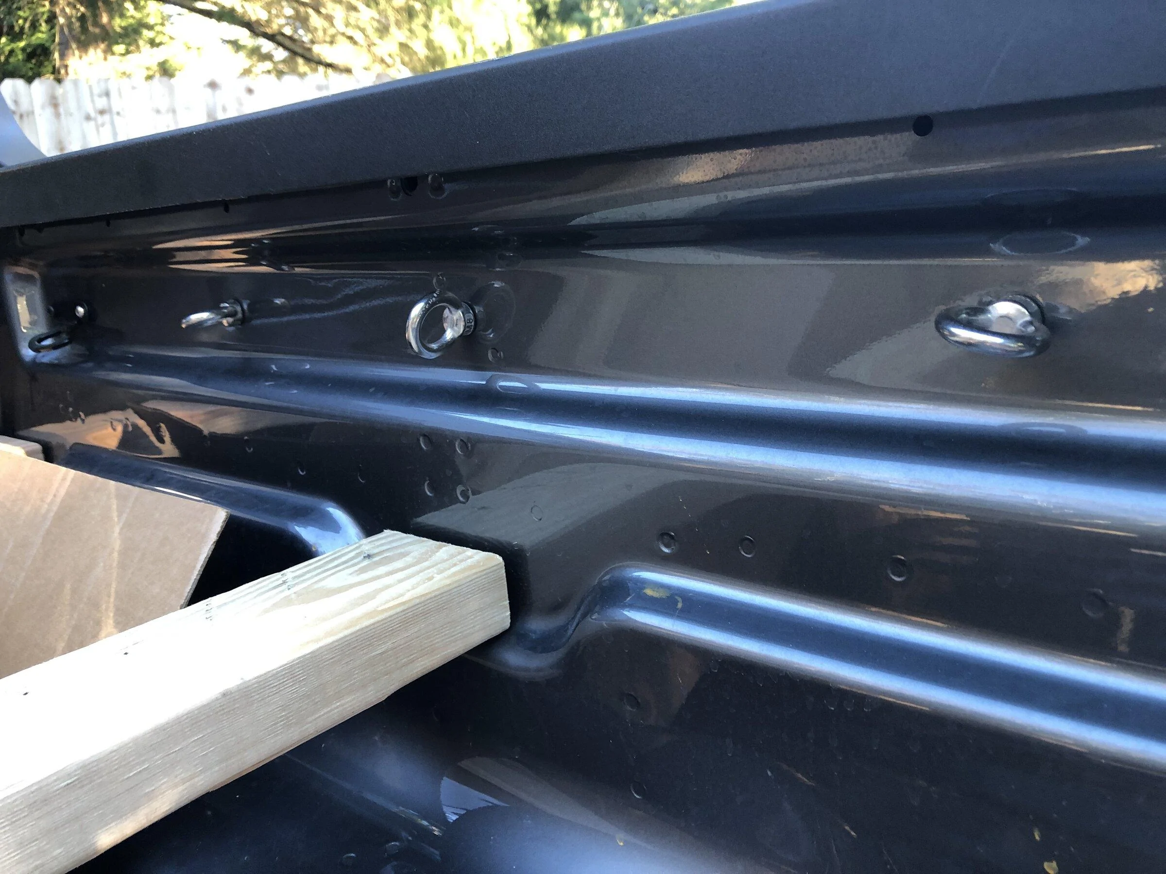

Here are some stainless steel M8 eyelets I bought off Amazon, they work great!

Sure! These are the exact ones I ordered.
Eowpower 5Pcs M8 Male Thread Machinery Shoulder Lifting Ring Eye Bolt
