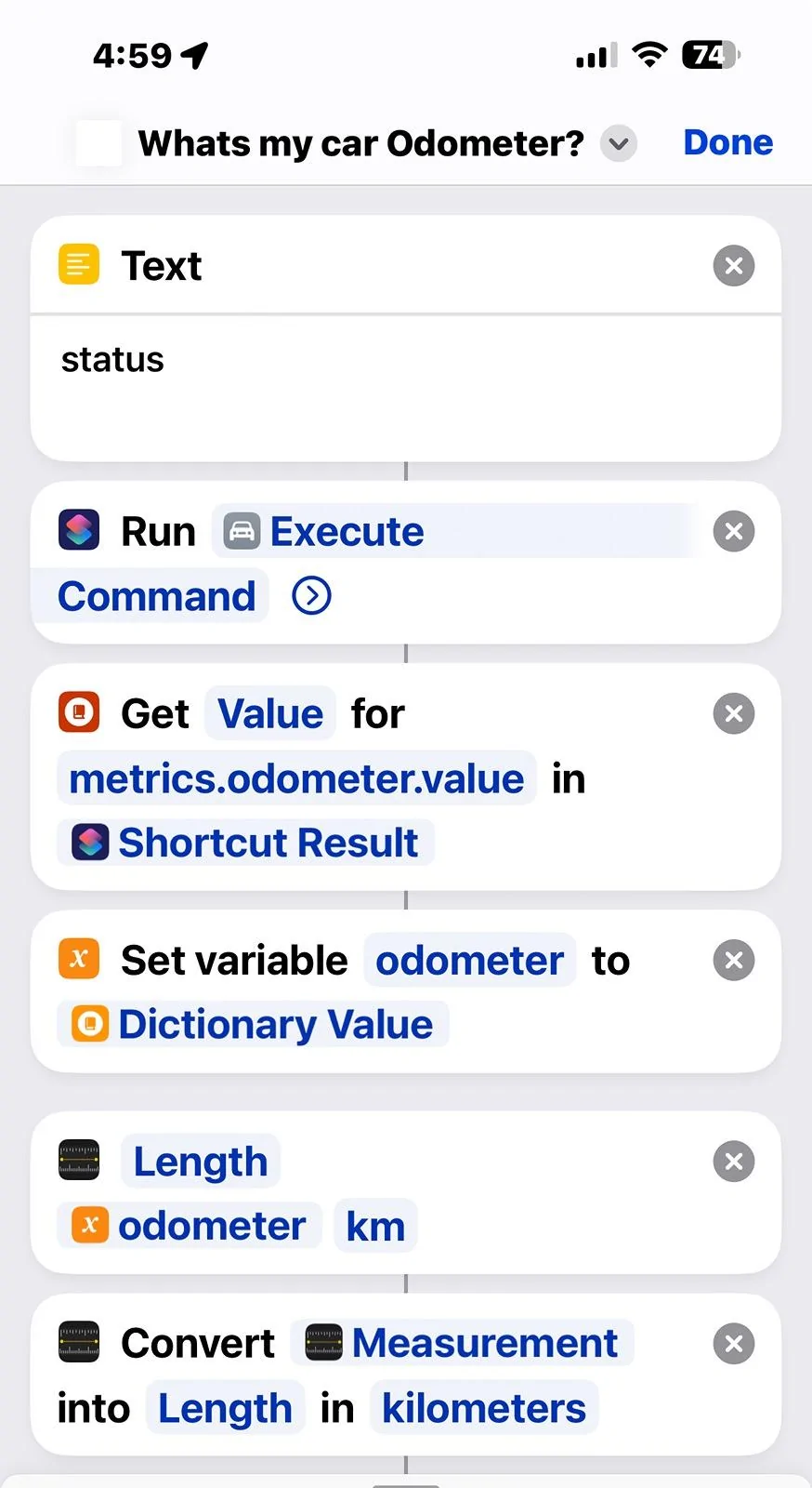

I just followed the directions and everything works with one exception. The "What's my car Odometer" is reporting my miles in kilometers. The value is set to metric....what should I change this to so it reports in miles?
You can replace (overwrite) the Odometer script from the one linked in my last post (#13) that will have you select Kilometers or Miles.

That worked! The only thing I noticed which isn't a big deal to me, it doesn't announce the mile....It just displays the miles. With Kilometers it announce the mileage.

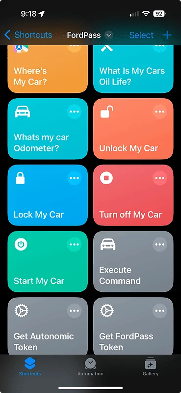

As a follow up to 2/8/22 thread https://www.mavericktruckclub.com/f...ck-diy-how-to-instructions.10056/#post-785687
Yesterday, I saw a reddit thread that the Siri shortcuts were working again on iPhones and Apple watches.
Functions include:
Start my Car
Turn off my Car
Lock my Car
Unlock my Car
Whats my Car Odometer?
Whats my Cars Oil Life?
Wheres my Car?
I purged the old versions I had used and installed the new shortcuts following the reddit thread. I entered my FordPass email address, FordPass password, and VIN number in during the installation of the first shortcut. After installing all the shortcuts, I manually activated the Start my Car shortcut (pushed the tile) and granted permission to run and voila... Maverick started. Followed up with Turn off my Car which also worked.
Will test verbally later today.

Although the installation of the shortcuts appeared to go smoothly, only "Where's My Car" is functioning via the Siri voice commands. All of the functions do still function properly going through the Ford Pass app by manually pressing the icons.

Thanks, they all seem to be working except "What's my car oil life." Not a big deal.
I get "Sorry, I can't provide information about the maintenance in your car," even though I've given all permissions.
Edit: never mind, I had to run that one shortcut separately via the shortcut app to give permission.

I noticed that. None of them work by voice until they have been run once by the shortcut app.
