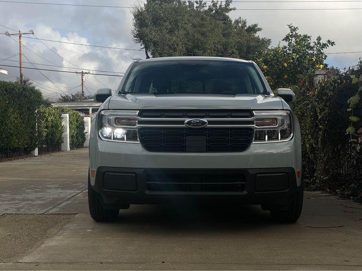

This just happened. Parked and one of the headlights won't turn off. Anyone experience this? Nothing I do helps. I can turn it on, put all the lights off and it remains left on.

Weird, try pulling a terminal off at the 12V battery under the seat for 30 seconds to reset any computer module that controls it

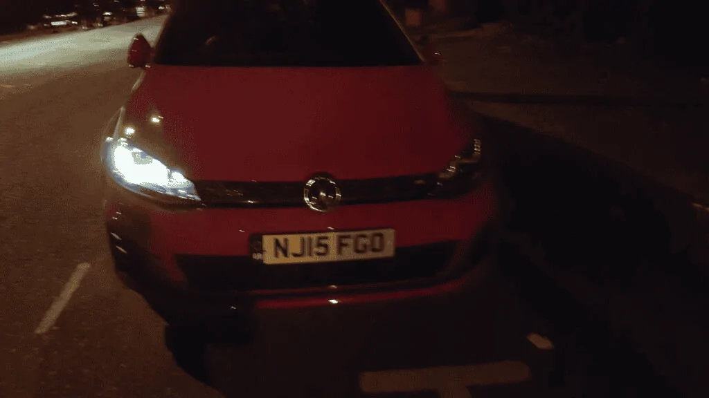

Some European cars allow you to only have one front and rear parking light turned on so if you are parked on the side of the road, drivers can see your car more easily. Normally this is done by having the turn signal turned <on> set to the side you want to illuminate before shutting down the car. Don’t think that would be it really but ford does make cars for the European market as well. Good luck!

You're correct. Most folks aren't aware of this feature on European vehicles. Would be nice to have it on US autos. Unless, the OP got a Maverick destined for European market, I'd say this is a dealer issue.
