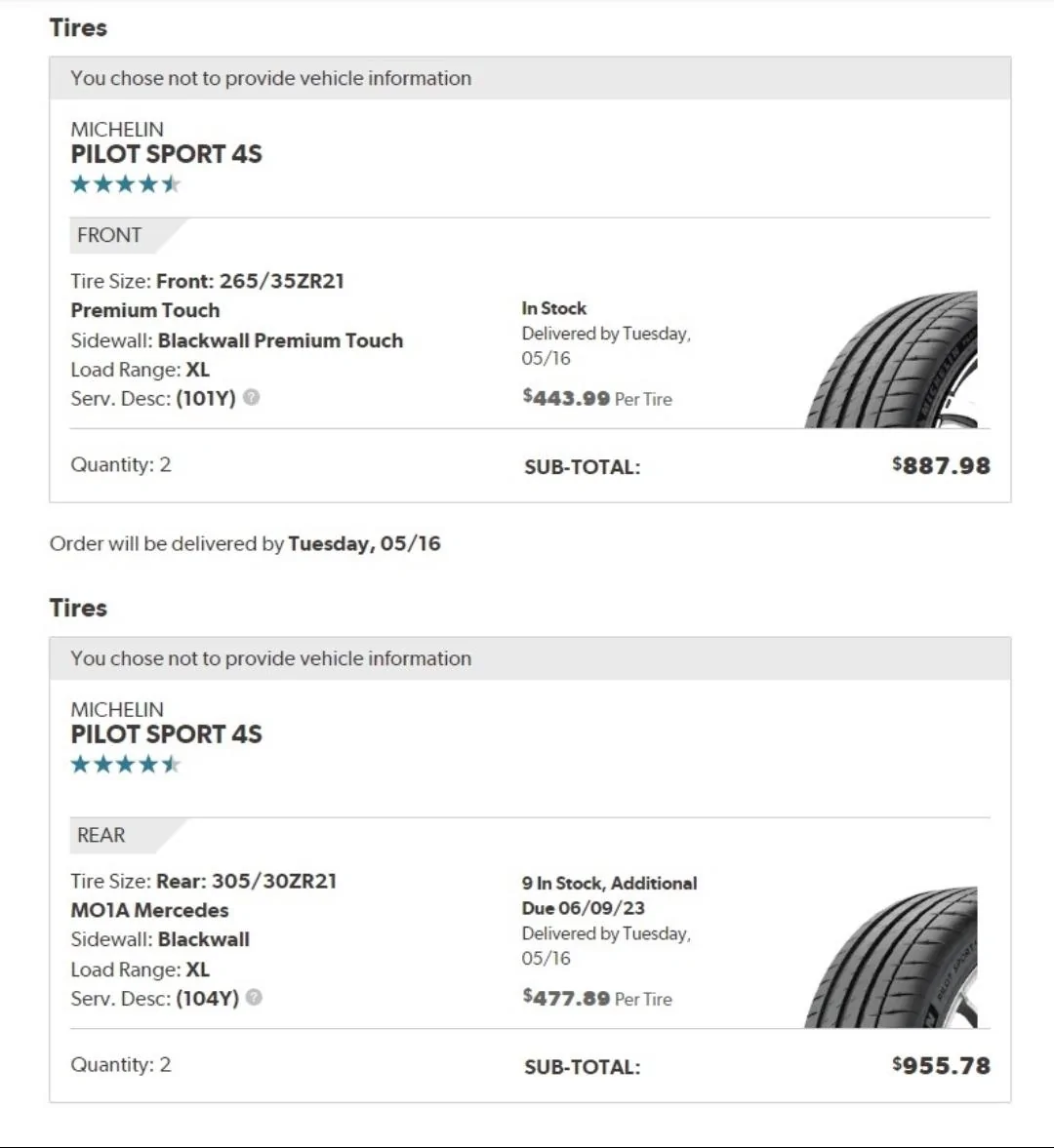

Took a few hours and countless measuring of my suspension setup to ensure these tire sizes would would, but I think the look and feel of them with the new wheels are going to be worth the extra time checking and measuring and checking and measuring some more! That's ALOT of meat going on the rear of the Maverick! It is very narrow in the rear. I know it will fit but it was close. Made a few suspension tweaks to get the 305s to fit without contact.

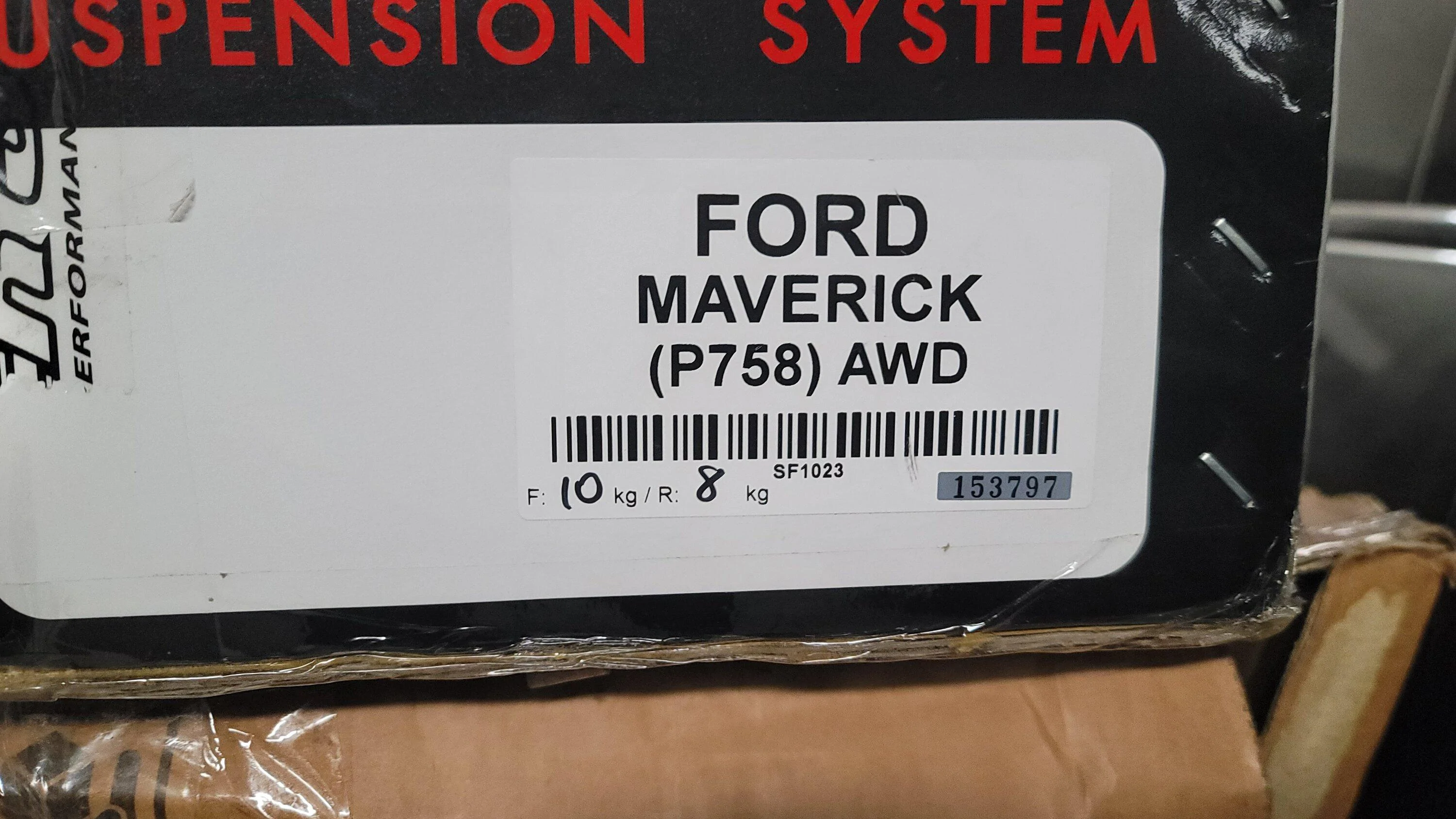

At the end of the day it really is a very personal decision. I live in Florida were everything is flat and the roads quite decent. In your case however, sticking to 19" or 20" will benefit you going with coilovers. Remember though, coilovers aren't just for going low... they are about dialing in the correct ride height for you! Springs will never do this as it is a static drop. You get what you get without adjustment of the ride height. You certainly do not have to go as low as I or others are. Coilovers will stiffen up the ride in a good way...given you have the correct spring rate matched with the correct compression/rebound tube. Can you share a pic of the front and rear spring rate of your coilovers? It's on one end of the box. This was mine...but not the spring rate I ultimately ended up with...
Mines the same as the box pictured there. I would assume the 10kg is a stiffer ride than what you have with the 9kg's? If I decide to stick with the coilovers I'd probably go with about what you have with the rear and go a little higher up front (as I know you said you were going to adjust your rear and I can see that you have a slight rake). I know I'll still be able to adjust the compression.
