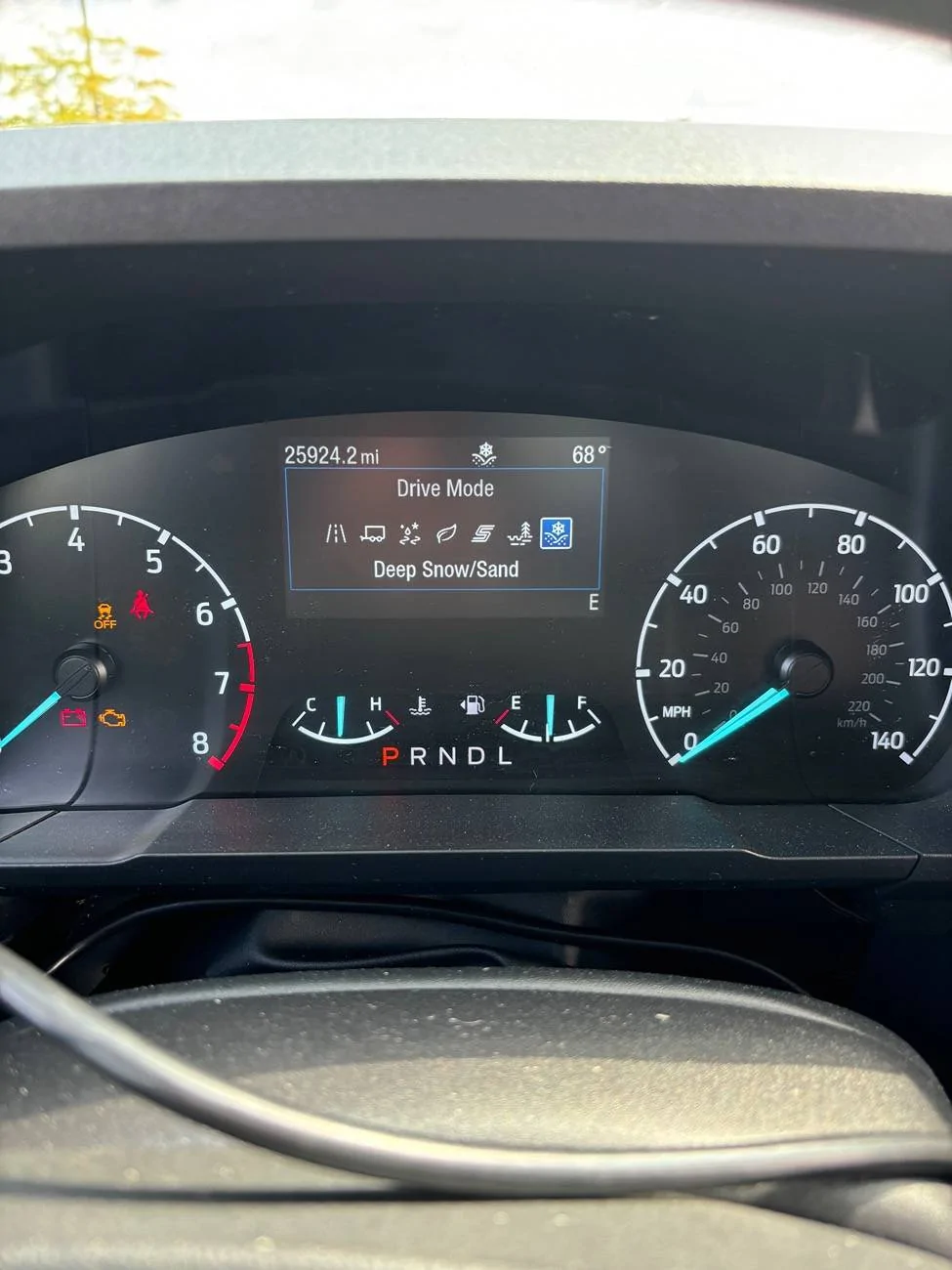

Alright guys so I got the new drive modes loaded.
it’s go time

So have not made it to the dunes yet to see if it curse my issues maybe next week.
it’s about an hour drive.
But just the little testing I’ve done I noticed something. It sure seems to push power to the back much sooner.
in my previous post about off roading in Texas I noticed that the front tires would start to spin that is very weird for a 4wd guy. Then you feel the rear kick in and it goes. With sand mode same spot of gravel in my driveway while turning I could repeatedly get the front tires to spin a split second. Sand mode it doesn’t spin at all.
Looking forward to testing more

Made it to the dunes this weekend. Has not rained in about 3 weeks with temps in the upper 80’s low 90’s
Sand was dry and powdery.
the sand made made a significant difference. I’m able to cruise all all at a slow pace and when I need more I can get a bit of wheel spin to get things moving. Was able to climb much more than in the past trips with ease instead of struggling a bit. The longer big hills the trans tuning was definitely better. Held the gears much better and longer than sport mode.
