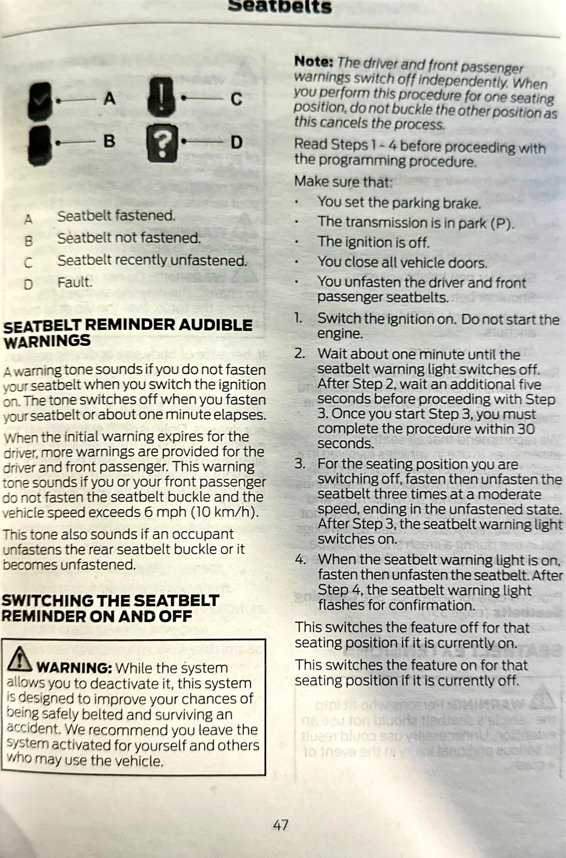

Can the seatbelt notifications on the display in dash be turned off. The fact I have to hit OK every time I get in and put on my seatbelt is kinda annoying.

Found it in the manual, and man this process is annoying.....
What's most annoying was that it didn't work for me. You have any luck?

I had to fasten and unfasten the seat belt 4 times to get it to work.yes,it is confusing but well worth it.

Shortcut workaround is to, when the truck is turned off, fasten all the seatbelts (except driver's) and leave them that way. Haven't seen the nag notification since did that, that is to say so long as the driver is also buckled up.
If you carry passengers, just remember to re-latch their belts at times when you're driving and they are not present.

I've tried doing what the manual states a few times. Unfortunately I can never get past step 2, seat belt warning light will never go off, so it can't be programmed. Maybe it's the smaller screen version that doesn't allow it.. ?? The manual doesn't say if it only works for certain versions.

Yeah I tried this method like 5 times on the driver seat and nothing, I am going to ask the dealer to turn it off for all seats on my first service.
I don't think screen size matters. I have a Tremor with the larger screen and I cant get it to work either.

only from the 3rd time was it possible to fix the breakdown according to the manual
