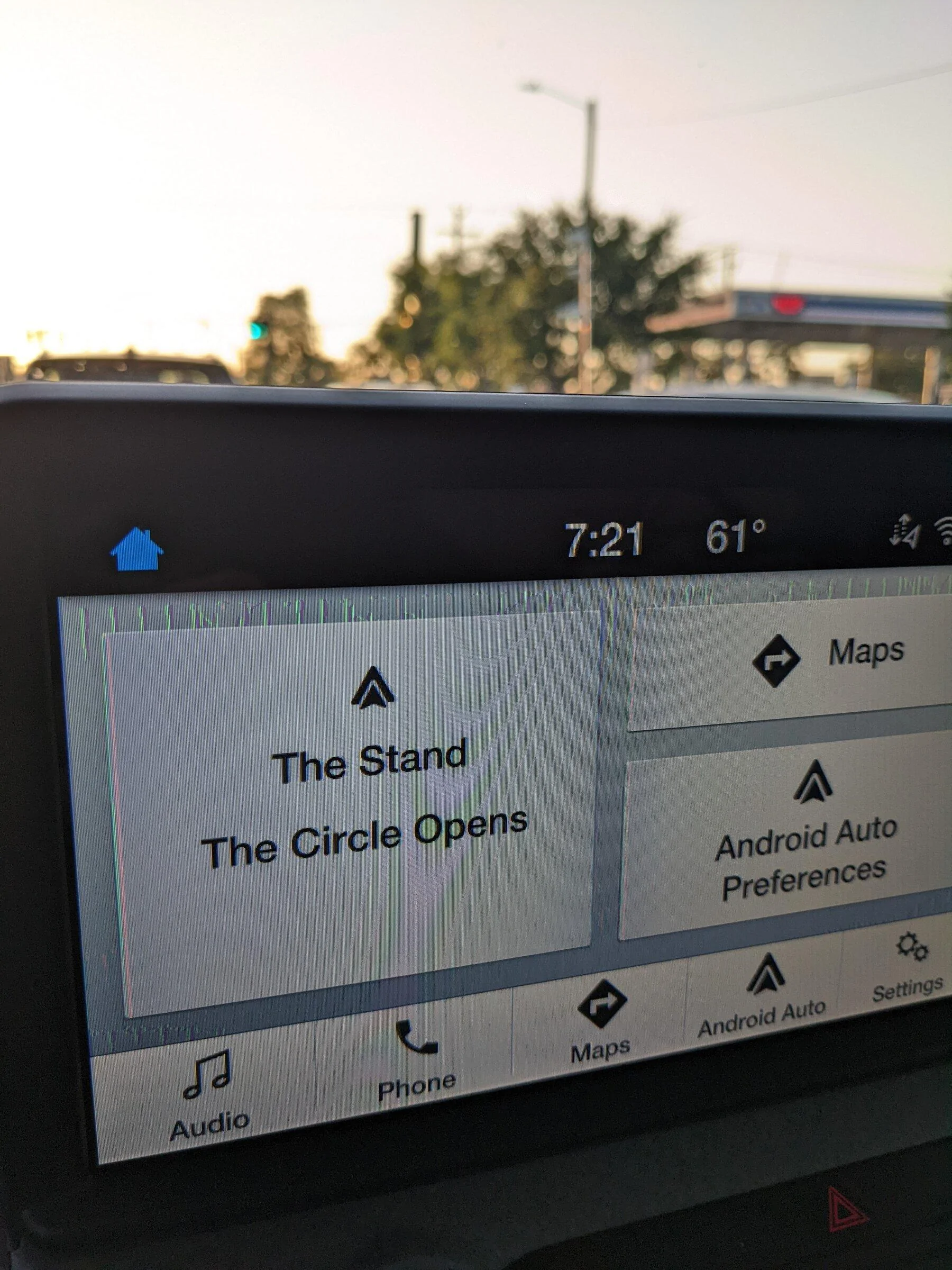

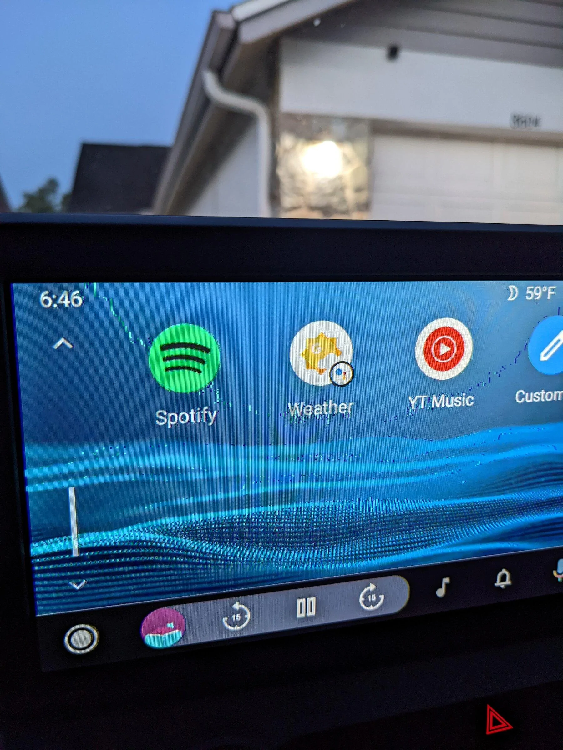

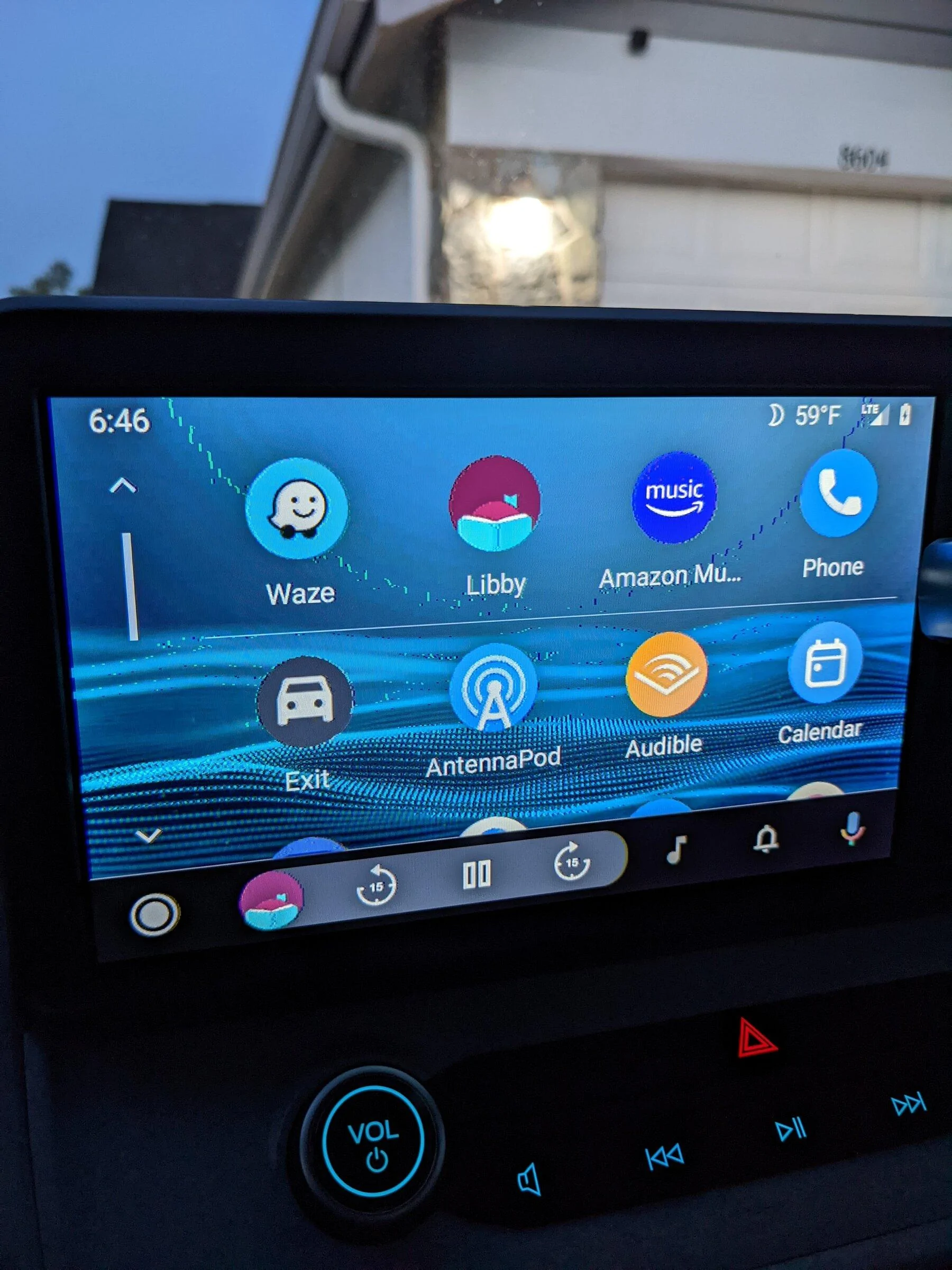

Just sharing a screen issue that started this morning. Drive Mav to store yesterday and no issues. Got in truck this morning, fired it up and all of a sudden screen issues. It's like the resolution dropped for some reason and there is pixelation across the screen. Radio/Android car play works, screen just looks like ass. Tried shutting the truck off a couple times and the issue remains.
The photos don't show it the greatest, but on the blue background there arches of like dead pixels. On the grey screen, it's all jagged at the top. When you tap an icon, it's really low poly looking. Again it's like the resolution just shit the bed.
Obviously I haven't had a chance to take it in yet as I'm at work.
