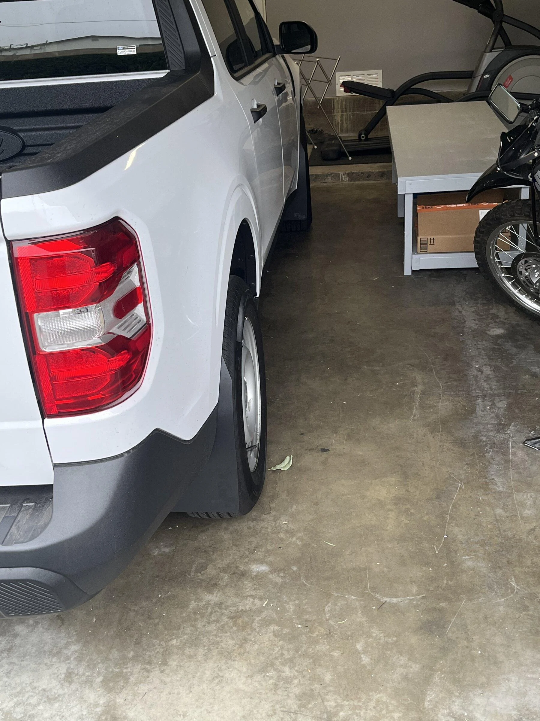

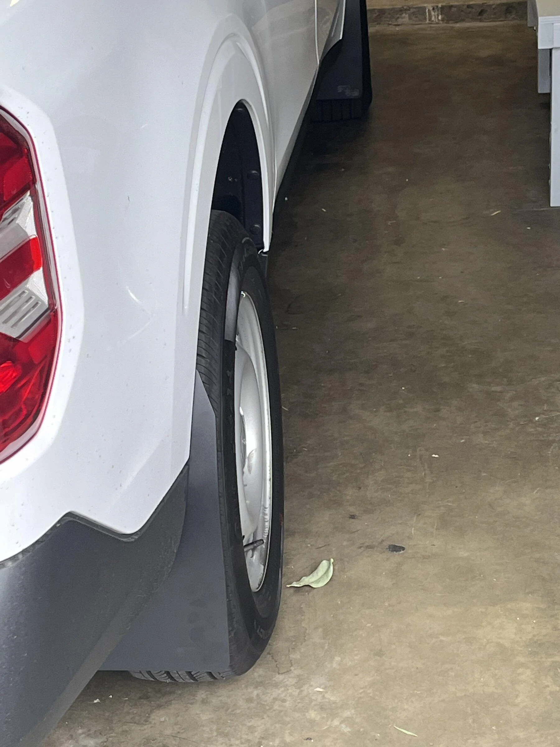

Installed mine today, for anyone not wanting a logo, just flip flop em side to side, they’re the same.
I installed em with logo visible, but if you’re so concerned, could flop the logo
to the tire side.
Which color did you get? I'd like to order the same, it looks like a perfect match for the dark plastic body-cladding.
Also, have they held up well?
Thanks.

I ordered black with black label.
held up great, I have since sold my truck, but no issues in 13000 miles.
