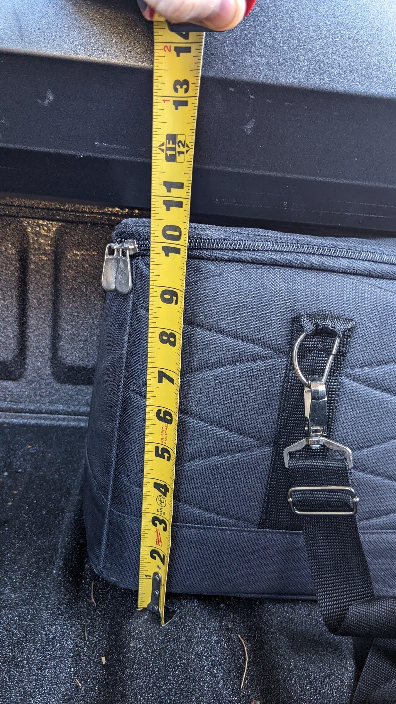

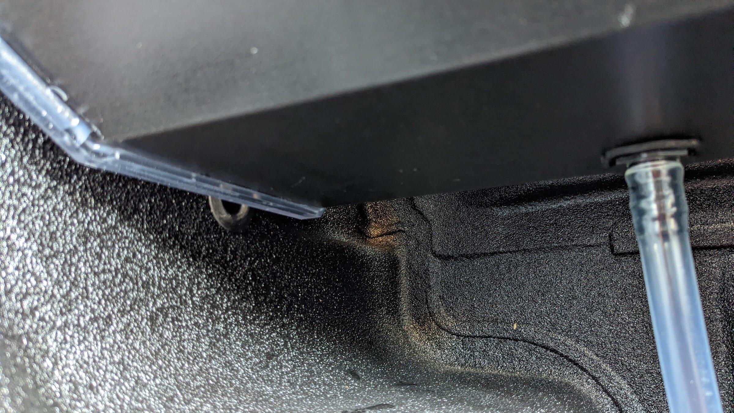

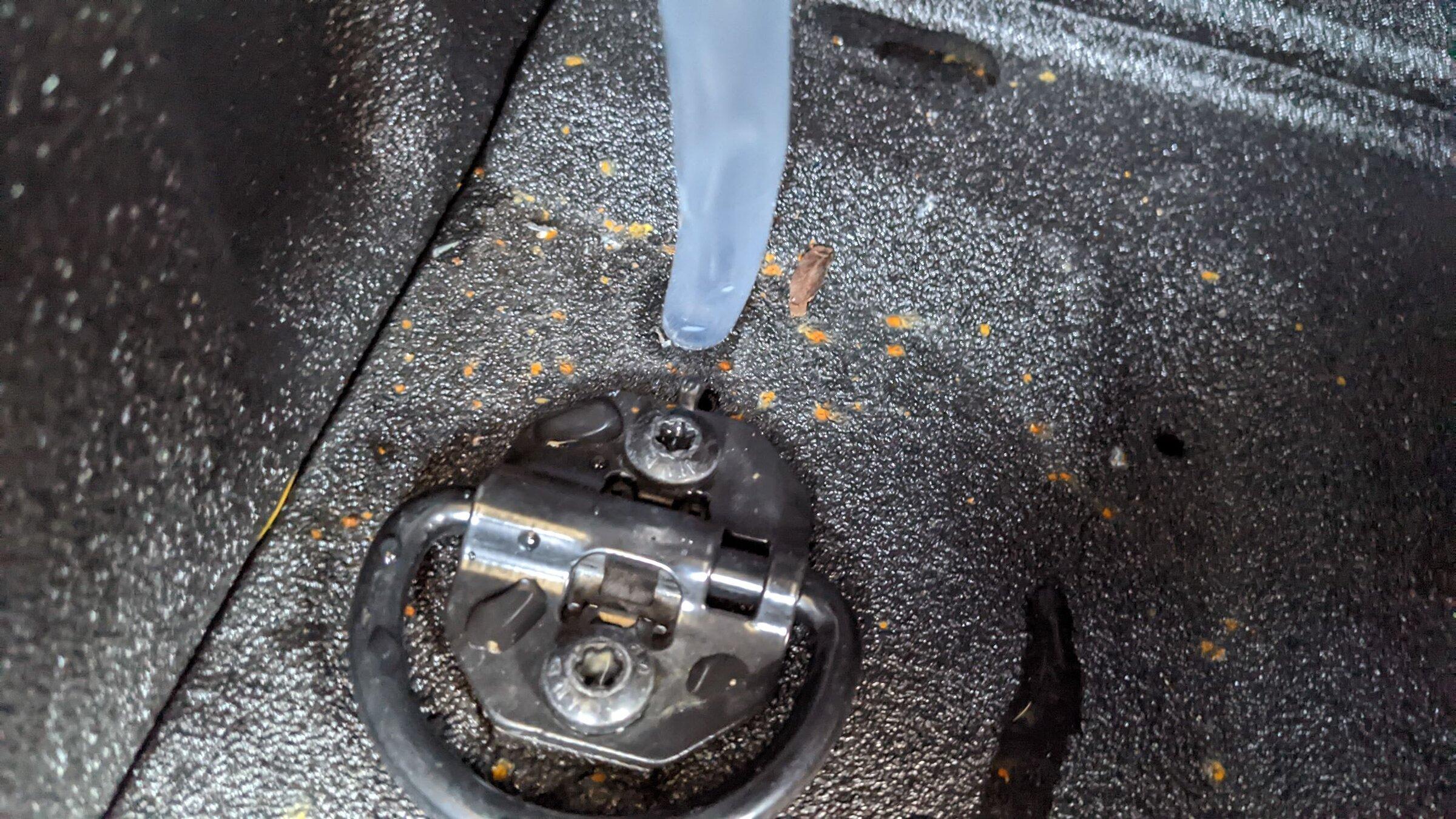

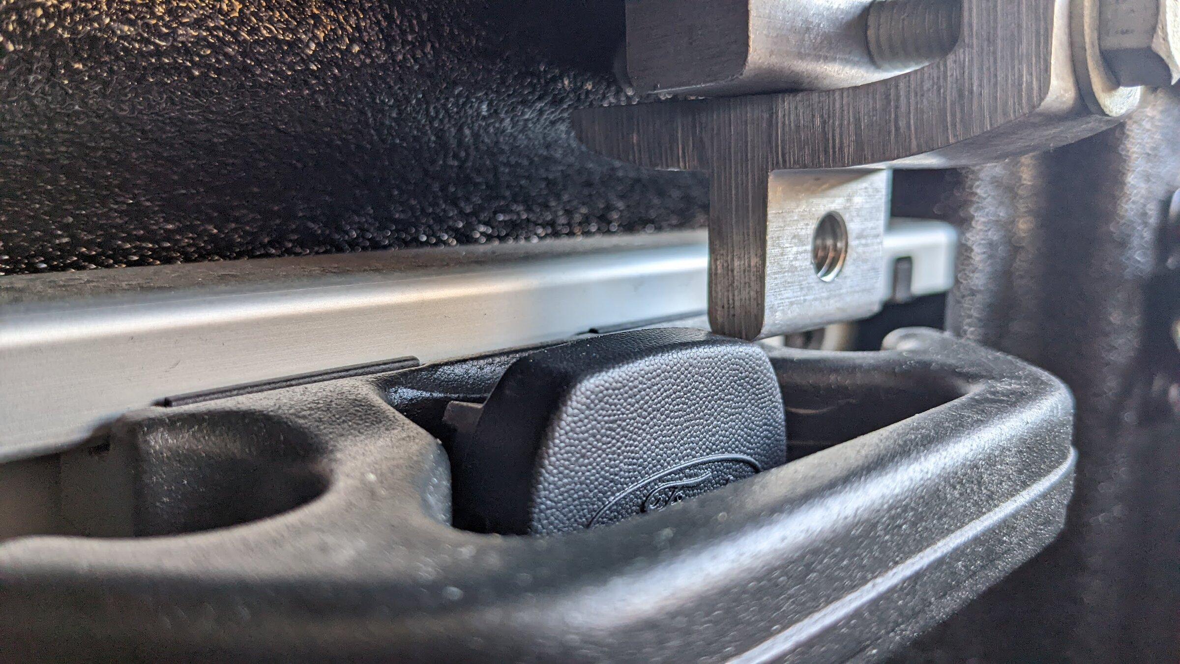

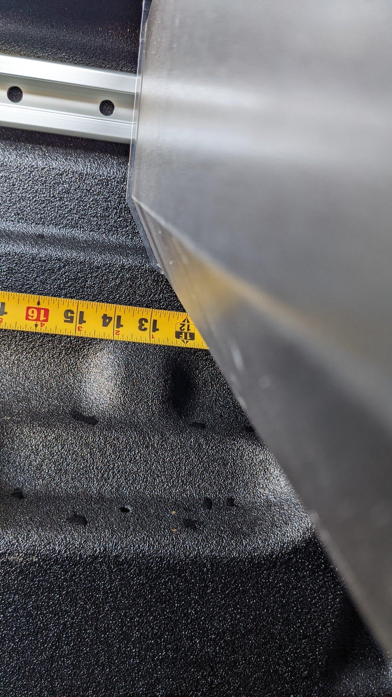

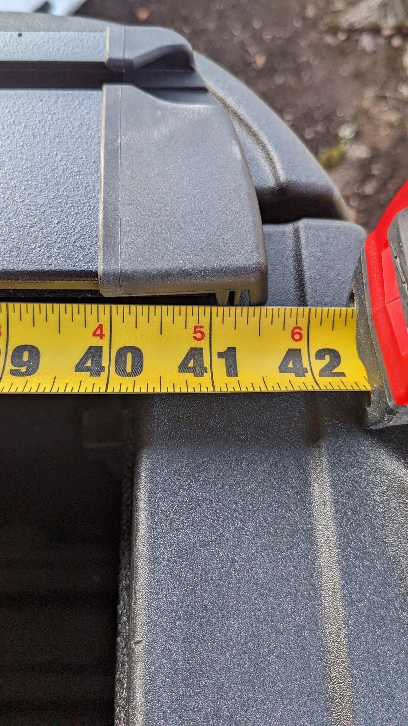

I installed this cover a few weeks ago and started posting a bunch of stuff into another thread, thought id try to condense it into its own thread instead.
Here's a bunch of pictures that might help answer some questions for people.
Measurements are: 10.5inches of space under the roll box, 14 inches from the front of the bed to the edge of the box, 40ish inches from the fully open cover to the tailgate.

The existing drain holes are too high to work for the XR.... did you drill out a hole below those?

yes, i drilled out 1/2 inch holes in the bed directly below where the drain tubes connect. there are very small drain holes already in the bed from the factory and i just widened them enough for the drain tubes to fit inside.

Thanks! This is what I will do as well.
