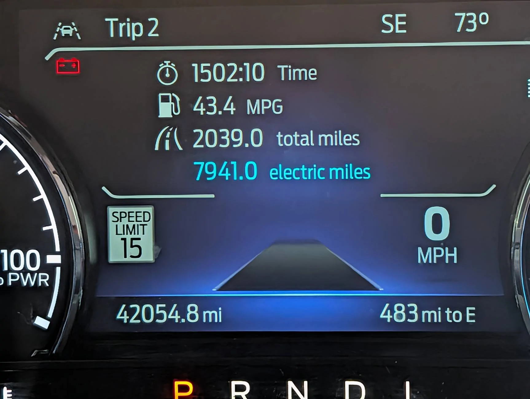

Mine shows 2,039 miles for trip 2, really 42,039(reset trip 2 at 15 miles on truck )
Unless I've gotten 7,941 electric miles over the last 2,039 miles.

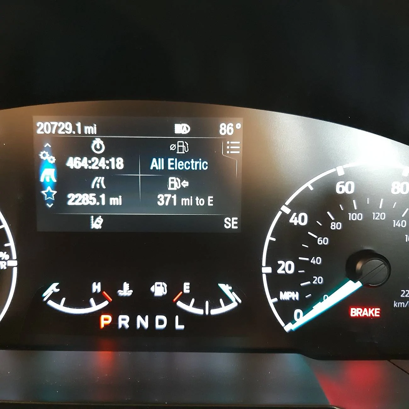

can you post a screen shot of 20000 miles on trip 1?
I double checked, I guess we are both right, the hour meter & the MPG screen does not reset, but the trip miles do, I was mainly looking at the lifetime MPG & didn't notice the miles have reset, I need to pay more attention.
