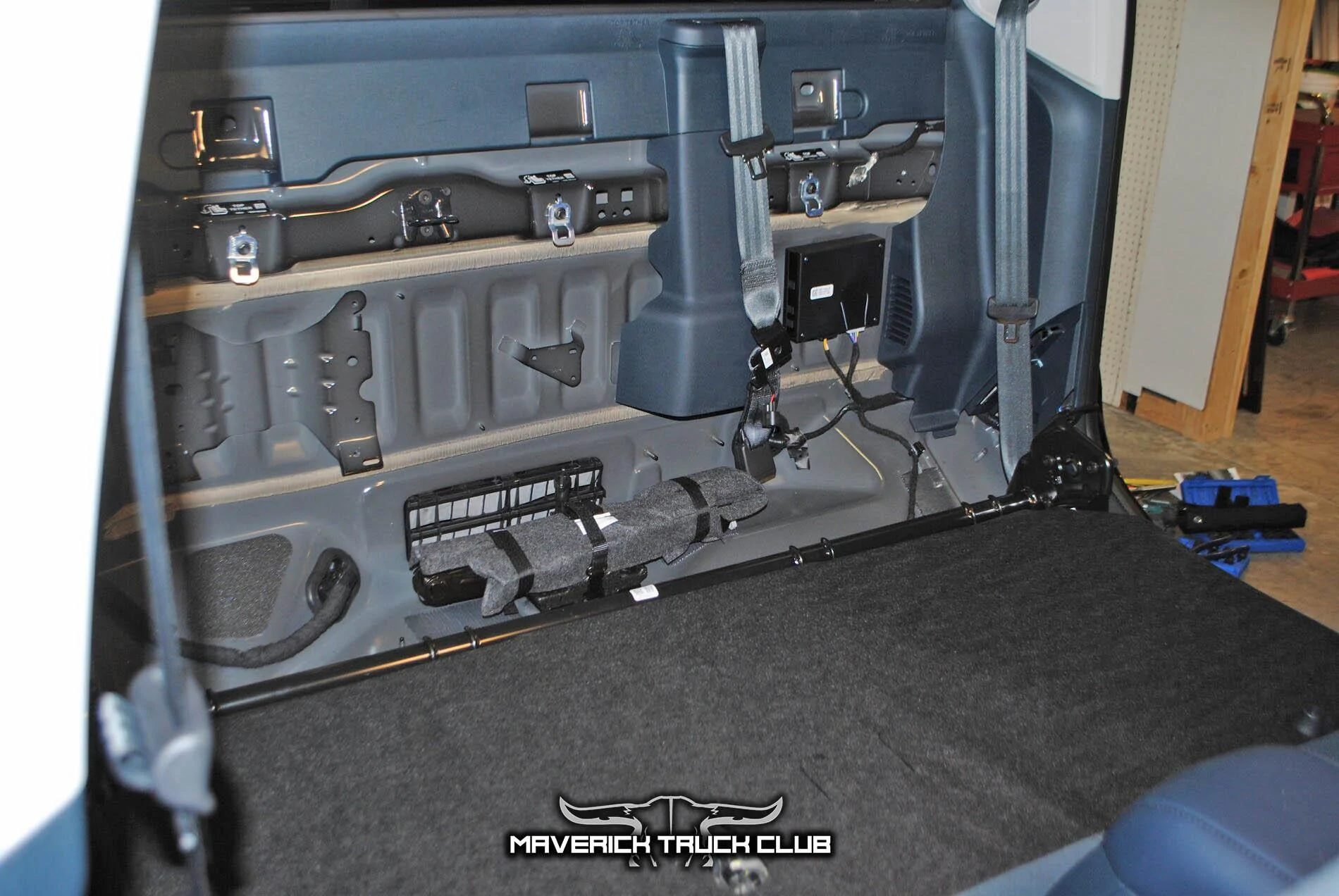

Even if you remove the plastic bins you will still have the large metal wall at the front and hump for the driveshaft/exhaust as those are integrated into the floorpan.
To borrow from one of the various audio build threads:
Ford Maverick Removing Underseat Storage img_7386-jpg
