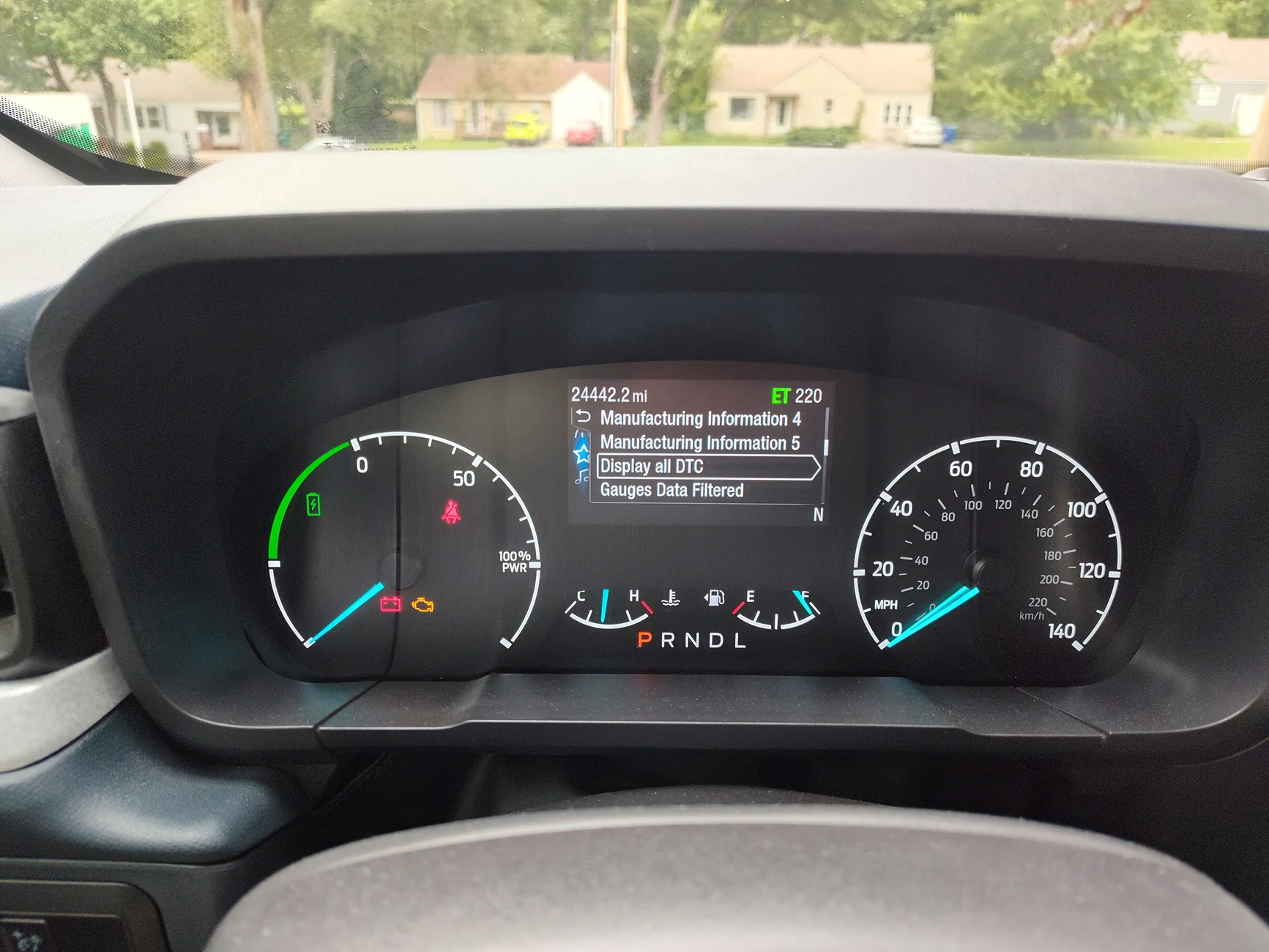

I think you can get the DTC's to show on the dash if you know the trick. Been a few years since I did it.
You still will need look up what PC9027 means.
Maybe Active DTC's will show up here - but not stored or pending - which I have but nothing showed.
Or it really doesn't work at all.
Engineering Test screen.
Hold OK button on steering wheel - turn key to On (or Push Button start no brake pedal).
Keep holding OK button until the pop ups are done and a green ET shows near top of dashboard.
Let go of OK button. (this works fine on 24XLT)
Use steering wheel up/down as normal, Menu is right, Back is left or back.
In the main menu - this:
Ford Maverick Red triangle with an “!” In the  middle = inverter module is intermittently faulty IMG_20260606_165127773_HDR
Made a video getting to this - but too long and I know it would fail to upload.
So here's the resulting picture.
The fact it says History makes me wonder if indeed used. But then again my codes were never MIL's - so maybe that's the difference.
But if History of any DTC - I had 2 that should have shown there.
