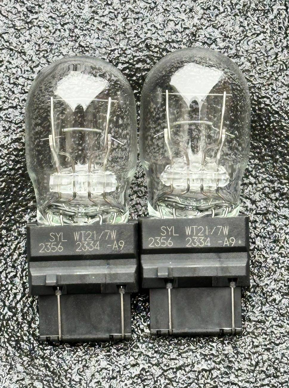

I didn't find this thread until I had issues with another bulb, purchased from Amazon (I know, I should know better). Installed front amber turn, rear reverse, and two each side of red turn/marker/brake. Once the bulbs were all in, the right side red bulbs would not light up, except for the hazards. These bulbs were advertised to work without any issues and I foolishly believe them.
White
Amber
Red
Factory bulbs are reinstalled and everything is working as it should. Unfortunately, I dropped one of the screws from the right side down between the bed and tailgate and I think it fell into the plastic bin installed under that corner of the truck. It's too hot here right now for me to lay in the driveway trying to remove all the mounting screws to remove the bin. Anyone have a part number?
