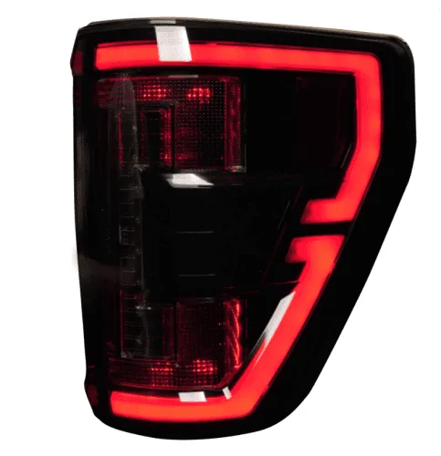

here's an example. the 2015 F150 had the led signature tails that were only the outer ring illuminated in position mode, whereas then the brake light would illuminate for braking and signalling.
I want to get the maverick to do the same thing.
20156-2022 F150 Signature LED tails

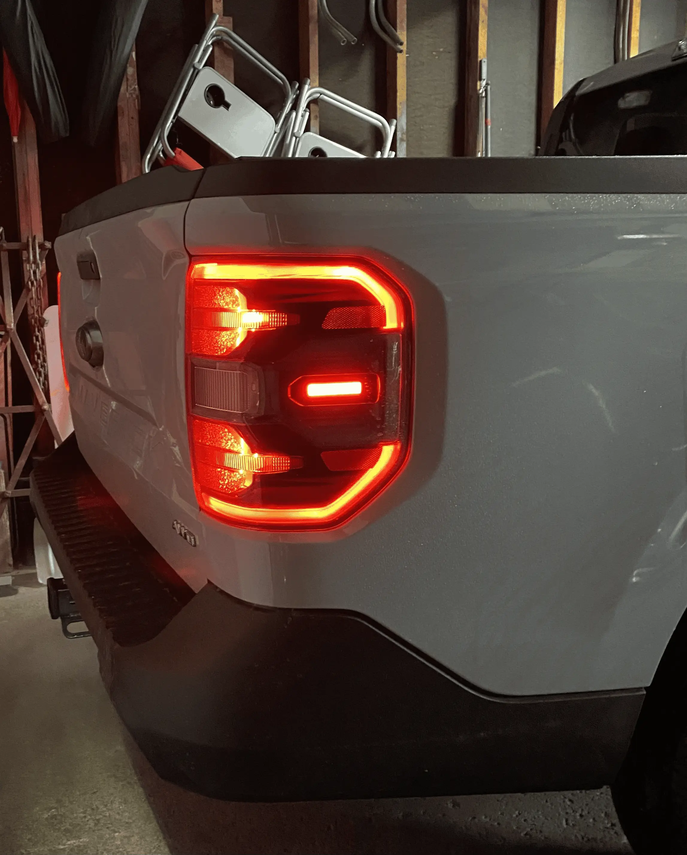

vs Maverick
Ford Maverick Rear Tail Light DRL Tweak for Canada - Seeking input from USA Lariat/BAP owners 1693276582798
Mechanically it could be done, which is what I might lean to in the short term.
bighap
Aug 27, 2021
745
1,295
Oregon
2023 Maverick Lariat Hybrid
There is a way. Super simple. You just have to cut a pin off the two brake lights on each side. It will look like the F-150 you referenced above. I plan on doing this as well.

Aaaand yes, this is exactly what I am looking to do. This is the mechanical way.
I am seeking a way to do it through Forscan, but if its not possible, then cut/block the pins is the way to go.

This is the issue. When headlights are off in the daytime and the DRL's are on for the Lariat (the front white signature lighting, the rear led signature lighting , and 4 bulbs are in on low power mode) I want the 4 tail light bulbs off. The rear led signature lights is enough to satisfy Canadian Law regarding rear DRL as the Bronco Sport does it this way already in Canada.
HOWEVER when headlights are on, the lighting is exactly the same way with addition of the headlights, and I want the 4 tailight bulbs to remain on in this mode. This is why simply cutting the wire leads on the bulbs isn't ideal to me.
When I was in the USA recently I saw another BAP maverick and it was daylight and it did seem like the rear taillights had just the led signature on. So I was hoping to get some input on some USA Forscan settings on a comparable vehicle to mine to see what can be tweaked.
