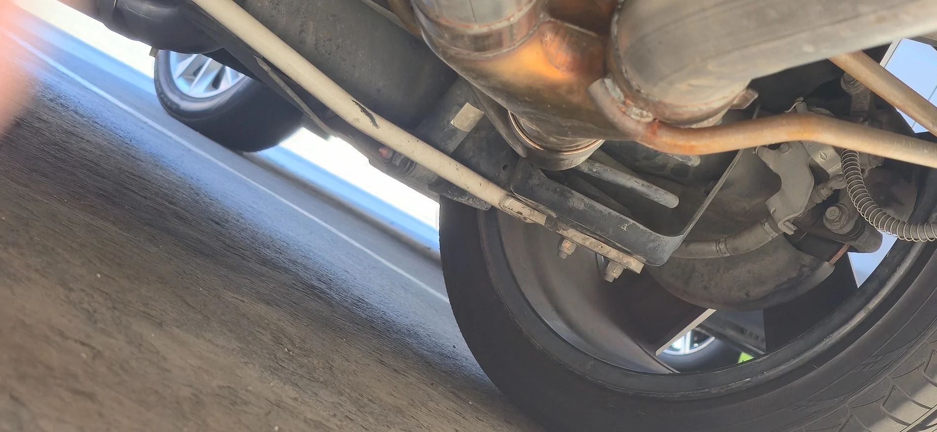

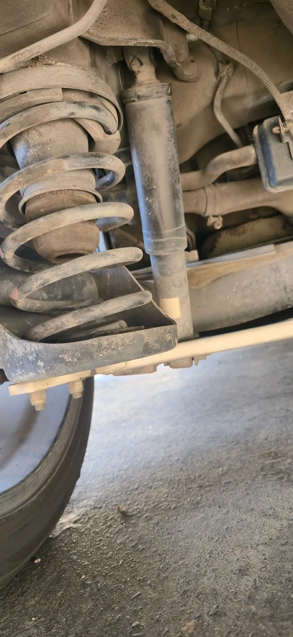

Has anyone made any of these for them yet, just asking since they've been out for a while. This is from a 2015 Hyundai Veloster turbo also fwd with a torsion beam.

I don’t know if less twist on an already stiff tube is a good thing ?
On the couple KDM cars I've added them on. There was less bouncing going through potholes and bumps. It definitely helps stabilize the rear end, I was hoping someone would have found or done something similar for the FWD Maverick

If you look at the twist-beam, there is a swaybar already inside it. Do you want to put a second swaybar on, or maybe a bigger one?
Huh, interesting. I'd think that adding a sway bar on a torsion beam would improve cornering but make bouncing over potholes worse since the suspension becomes less independent.

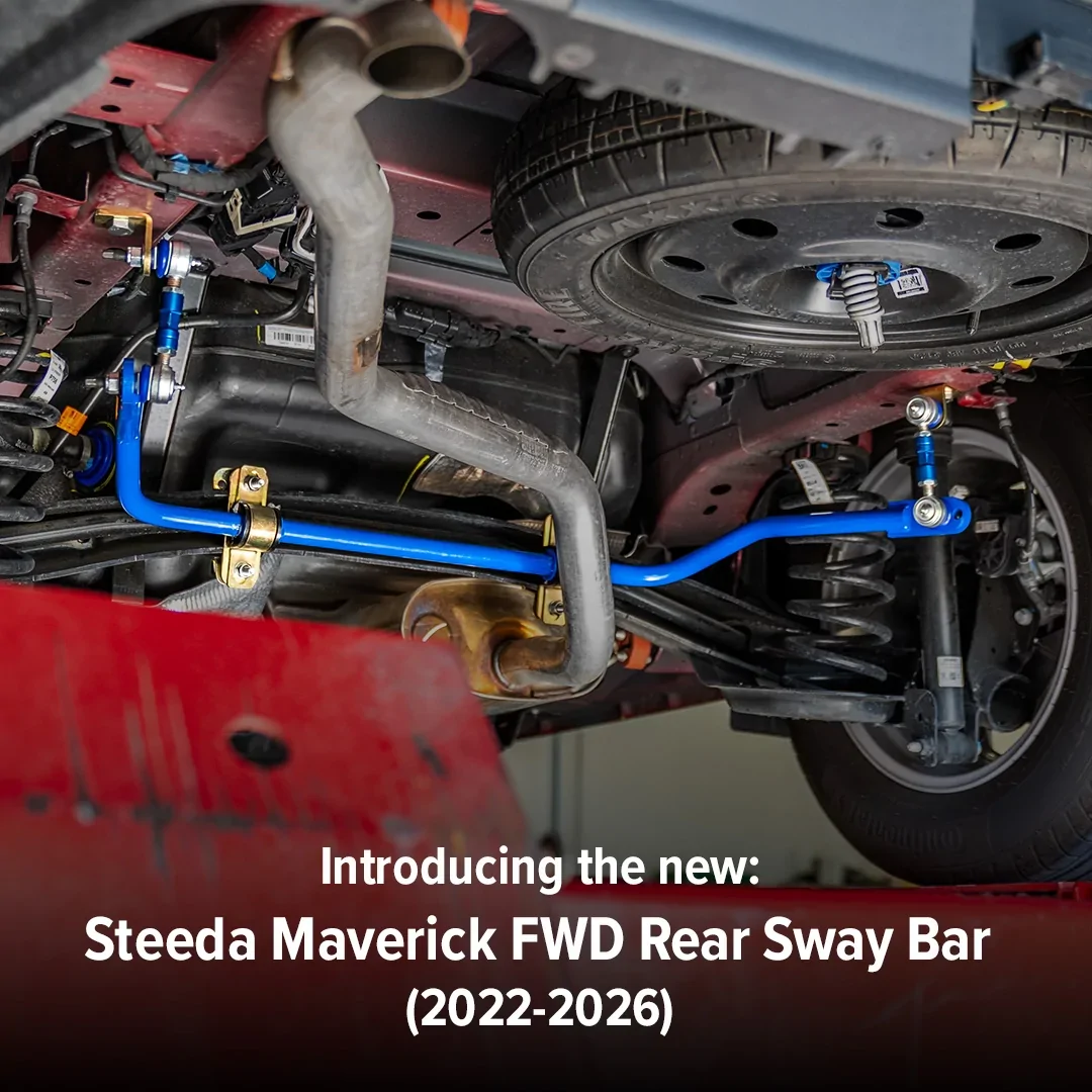

Not a Maverick but same idea, with a stabilizer bar for the torsion beam. Same company I bought it for the KDM cars
