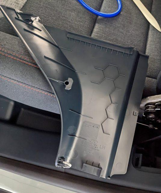

The panel that covers these (I removed the side mechanism bracket as well in the pic above but that was not necessary once I pinpointed the sound 100%)
It's just held on by 2 panel clips, pop the bottom then the top and it comes right off and slides along a track/slot near the top.
