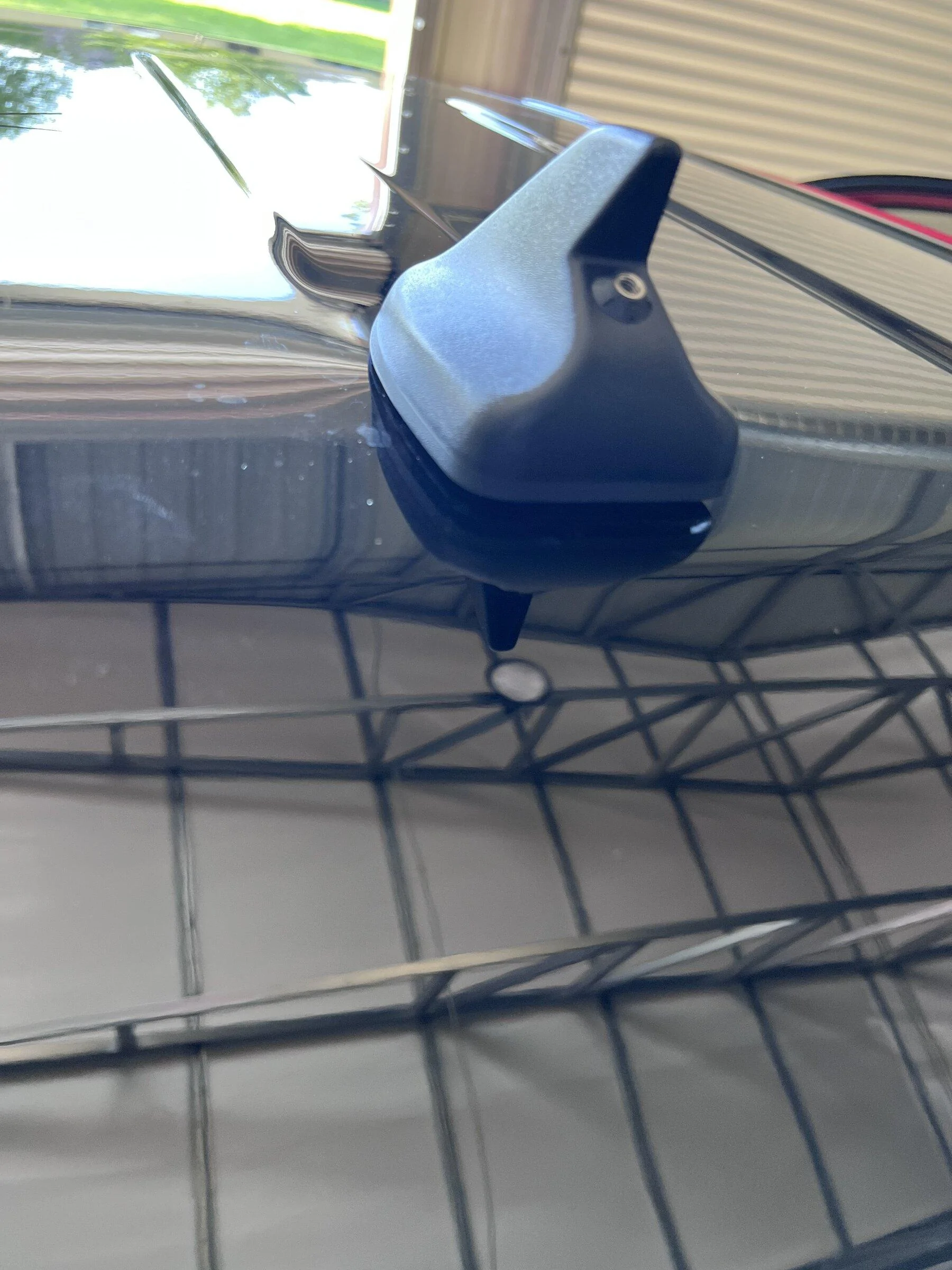

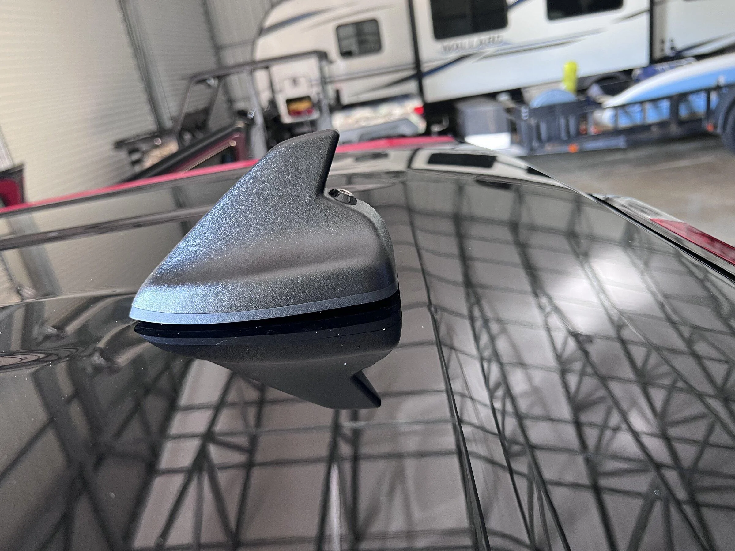

While backing in the garage, the door rope looped the antenna and lifted the base off the roof 3/4 of an inch.
Trying to put it back but need to remove the dome light to access the screw.
I’m worried I’m going to break the light?
how do I get that thing out?

i don't have mine yet so no clue, however, looking at your picture there seems to be a line like the top portion is separate from the bottom base. Wonder if the two can be separated and there may be screws or something on the base to clamp it back down. Just a guess. Hope ya have success in getting it corrected.

I don't believe that you can remove the rear dome light assembly from the inside of the cab, at least there is no provision in the service manual to do that. To access the antenna bolt, it calls for lowering the back of the headliner. See attached PDF to see how the antenna is mounted.
