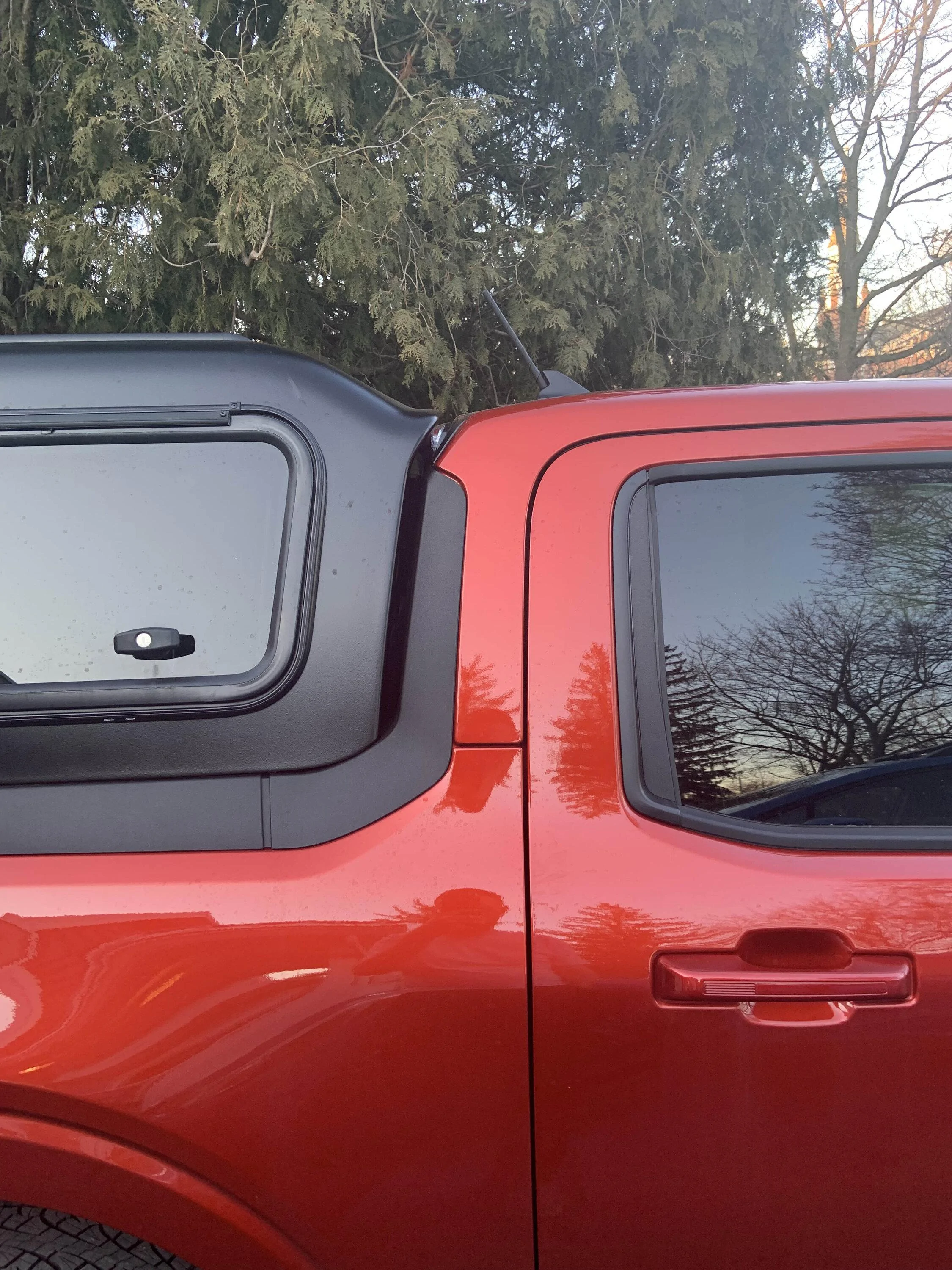

I purchased the cap through a Ranch dealer and had them install the BedRug too since I didn't want to attempt that in January. It's a Ranch Skyline and I like it so far. The gap at the cab is more than I'd like but it seems unavoidable on a unibody. After a week I hardly notice or care anymore. I went with a textured matte black to match the black plastic trim as best I could and because I was told they couldn't gurantee a match to the tri-color paint. I think I like the black better now that I have it anyway.

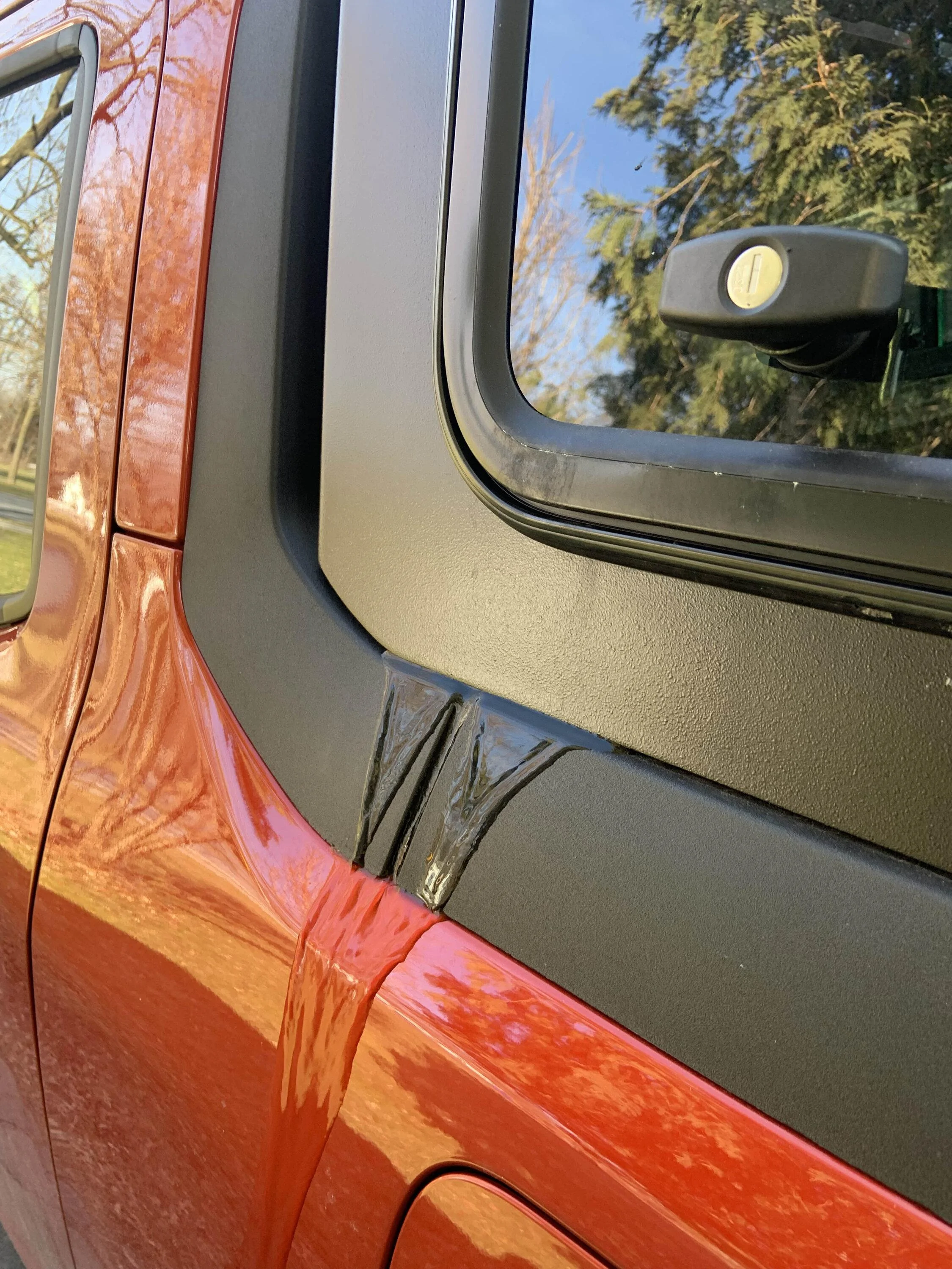

Edit: The inside was wetter than expected after a rain. When it dried out I poured water between the cab and cap and it seems to be coming in from the front corners. I've reached out to the installer to see what can be done.
Ford Maverick Ranch Skyline Cap (topper) and BedRug installed on 2023 Lariat FX4 Inside leak
Ford Maverick Ranch Skyline Cap (topper) and BedRug installed on 2023 Lariat FX4 Outside drain
